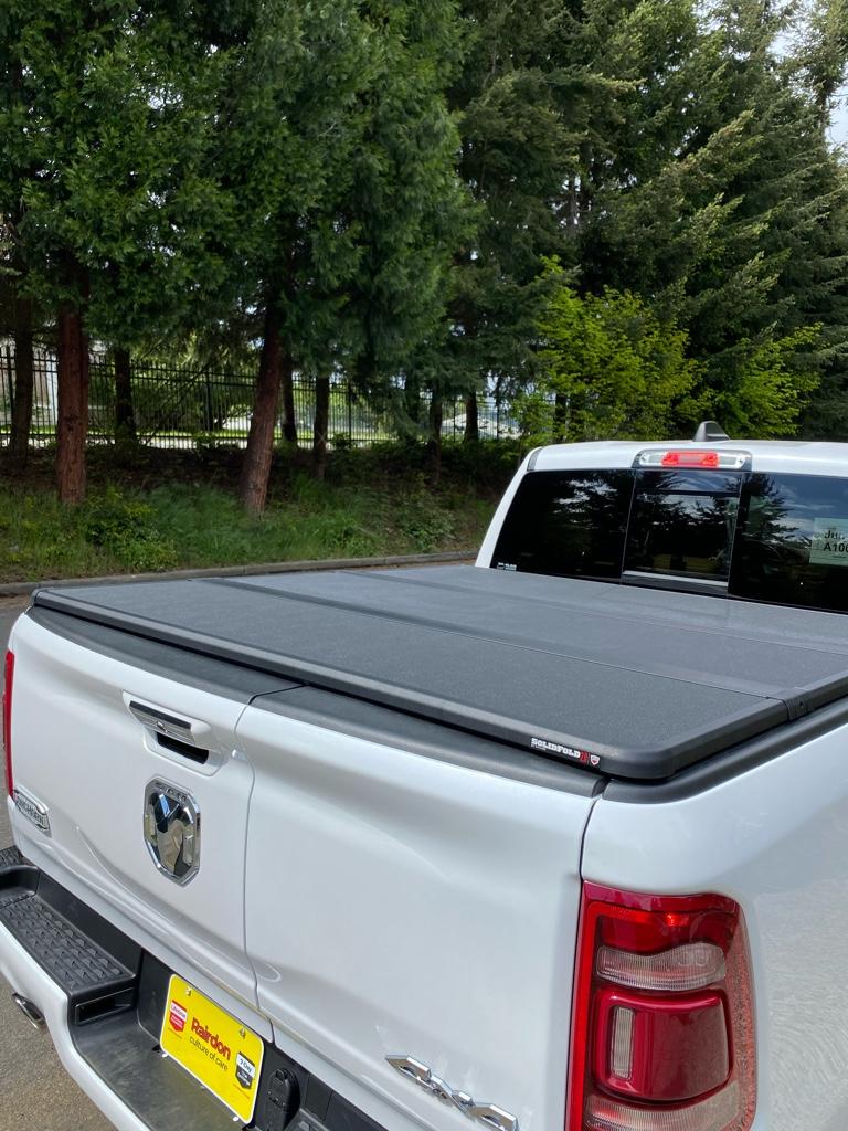

Just installed the extang for the MFT on my Longhorn without Ramboxes. Install was very easy, other than the little bit of effort it took to carve out a small piece of the rail cap so that the rear mounting bracket sat flush on the rail. Looks clean and the seal looks like it’s flush so I’m optimistic that water leaks won’t be an issue.

Did you peek from the inside at the front corners? Mine has a bit of daylight at each corner where the side rails have caps and the bulkhead doesn't.
I am sure mine has the same gaps based on looking at it from outside really quick.
Have you had any issues with leaking through those spots? I am betting it would be possible to fashion something that could go in the corners that would help close those up.
I'm sure some weatherstripping on the front rail would take care of the issue. I just haven't made time to mess with it yet. It definitely does leak, but I haven't been checking it to see how much.
Edit-> I also think some of the light is coming under the side rail cap where it doesn't quite sit flush on the sheet metal. So it might need some weatherstripping or silicone under it as well if you really want to make it waterproof.
