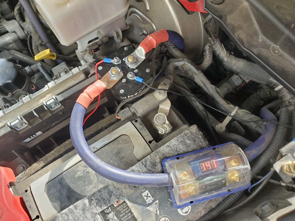

I use an Installbay 500 amp isolator from Amazon, I don't need one as most lithium batteries can work in parallel with the stock battery, the reason for the isolator is the resting voltage of the lithium is 1V higher than the lead acid battery but that is not a big deal, an isolator is not expensive and it's easy to install.

Does it need to be a 500 amp isolator or will a 200 amp one be enough since my setup will be for 3k/4K not 8k like yours?
No, even mine didn't have to be 500A, when the engine I running the alternator is the one providing the current, until the demand is higher than what it can deliver, that's when the battery picks up the slack, so technically with a 220 amp alternator you only need a 300 amp solenoid, I got a 500 because the price was not much difference.
