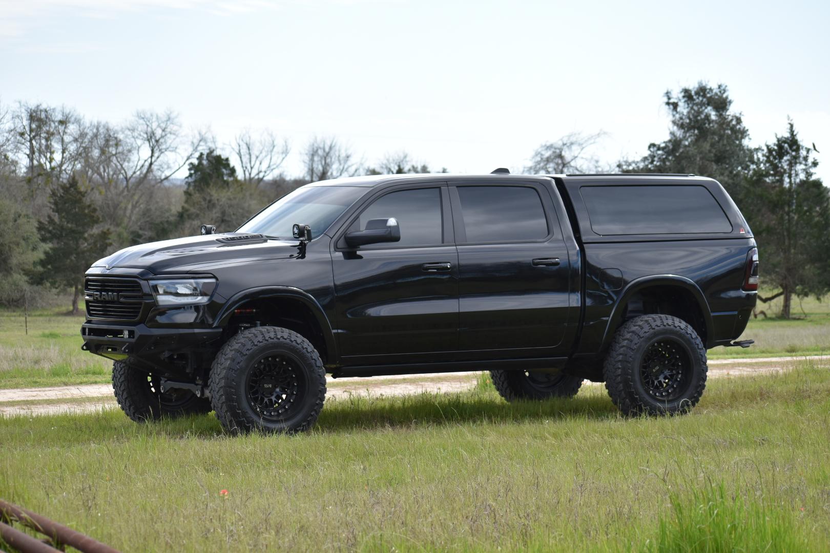

My gas mileage went from 19 mpg down to 15 mpg
I’m surprised as we both have the BDS lift and the same wheels size and offset, the main difference is I’m running 35x12.5 and you are 35x11.50 and your tires appear to stick out further then mine.
I noticed that in the pictures you sent me and was thinking the same thing. I will say I am glad I went with the 11.50’s
I’ll be swapping out for 11.50 as even though I get a ton of compliments, I really don’t like how far out they stick.

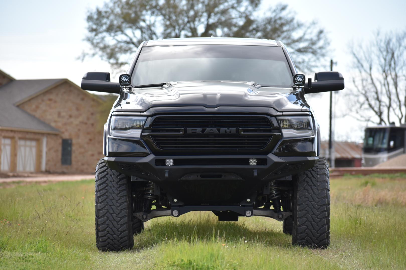

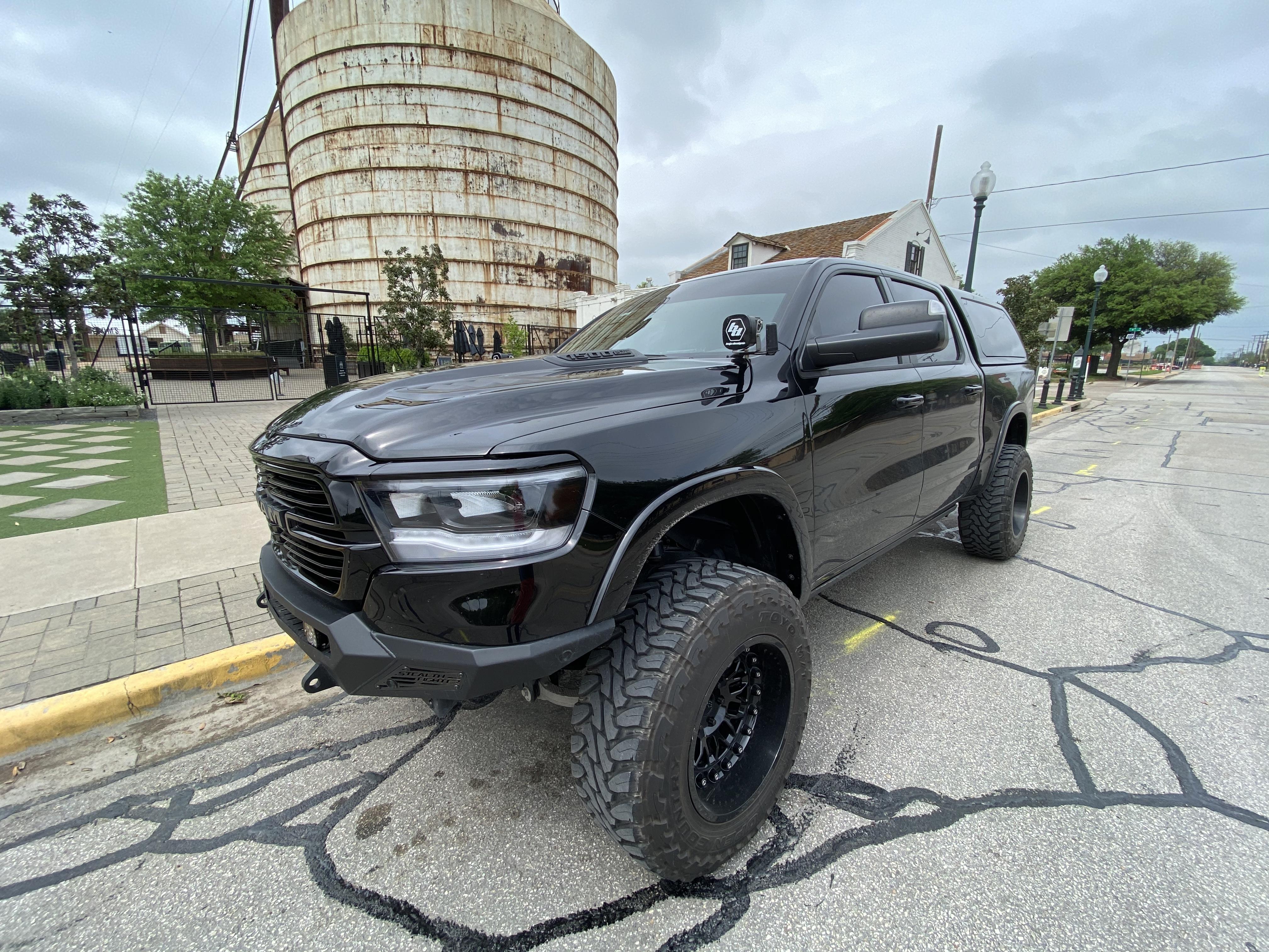

BDS 6” Coilover Kit with UCA’s
20x11.5 Black Rhino Fury -44
37x12.50r20 Toyo MT
NO Rubbing!!
How is the ride quality on that setup? Have heard it’s as good as stock if not better. Can you vouch for that? I’ve been eyeing this kit, but do a good bit of highway driving and don’t want to absolutely ruin the highway ride.

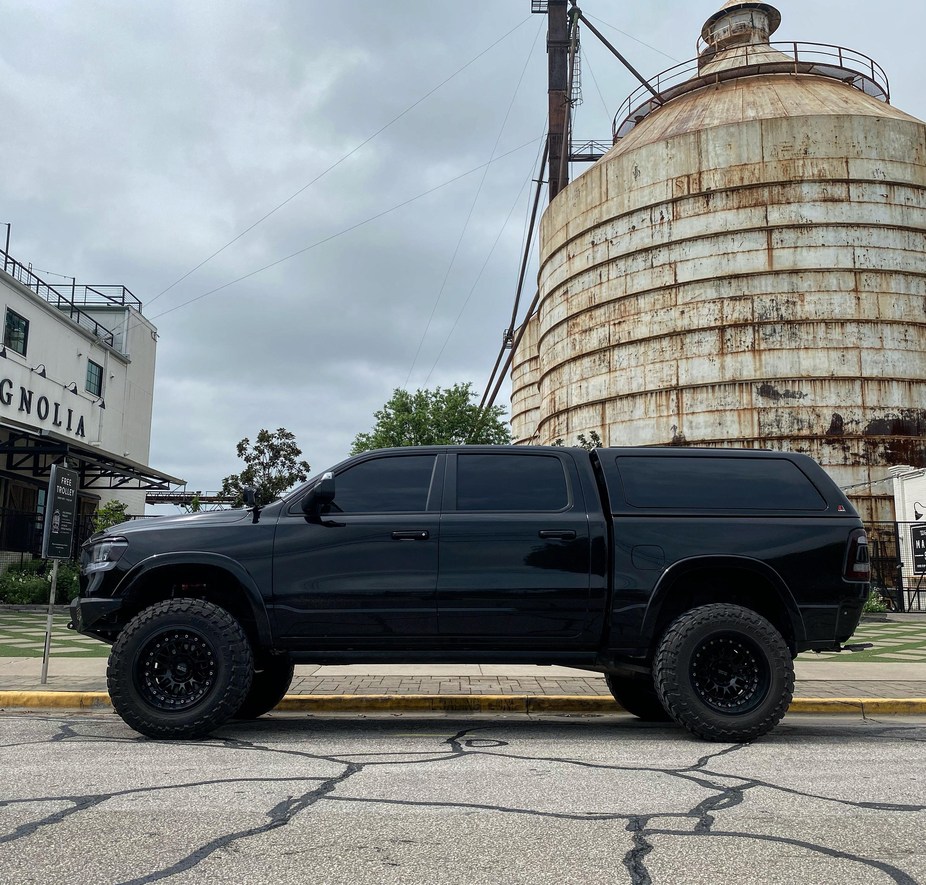

BDS 6" coil over kit and UCAs on Nitto Terra Grappler G2 37x12.5x20
Hostile Venom 20x10 -19 offset
