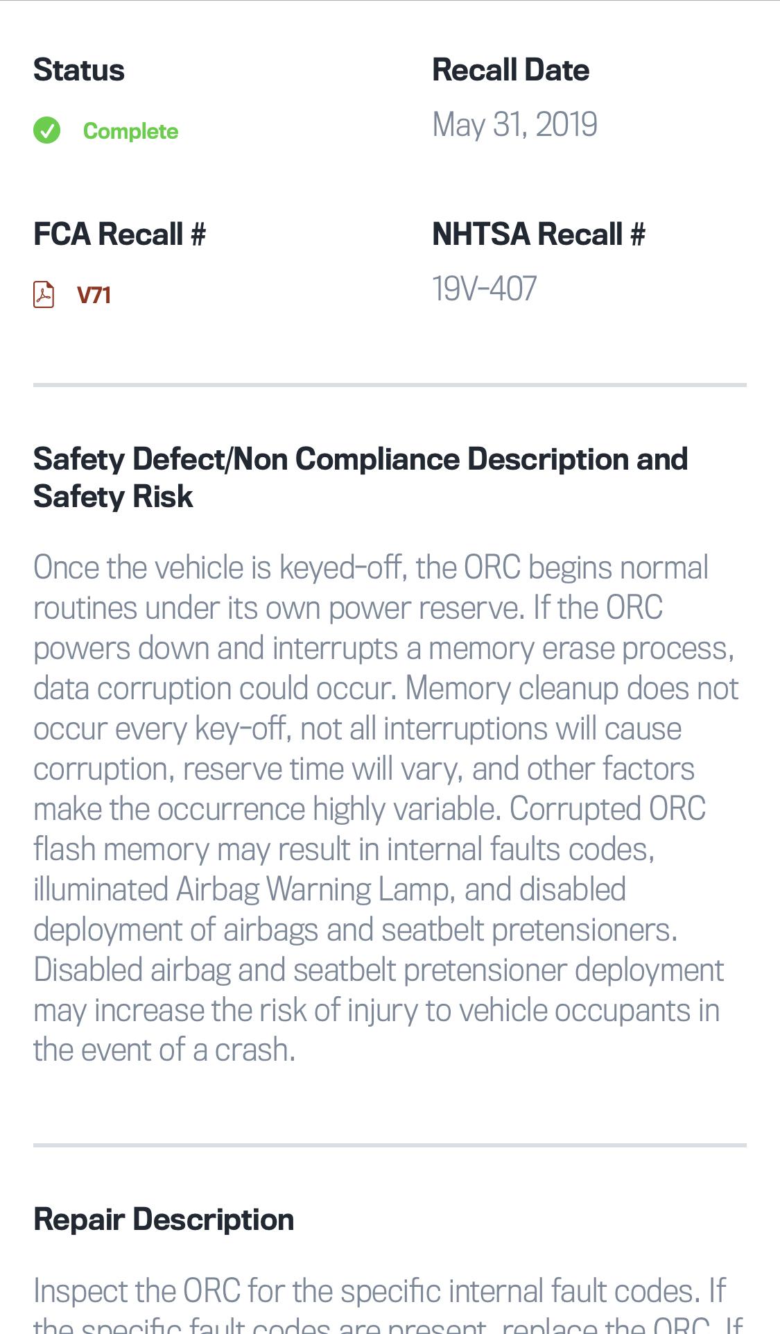

Also, just recently (2 weeks ago) had the recall done for the ORC. (photo attached). Shows repaired, not replaced.
