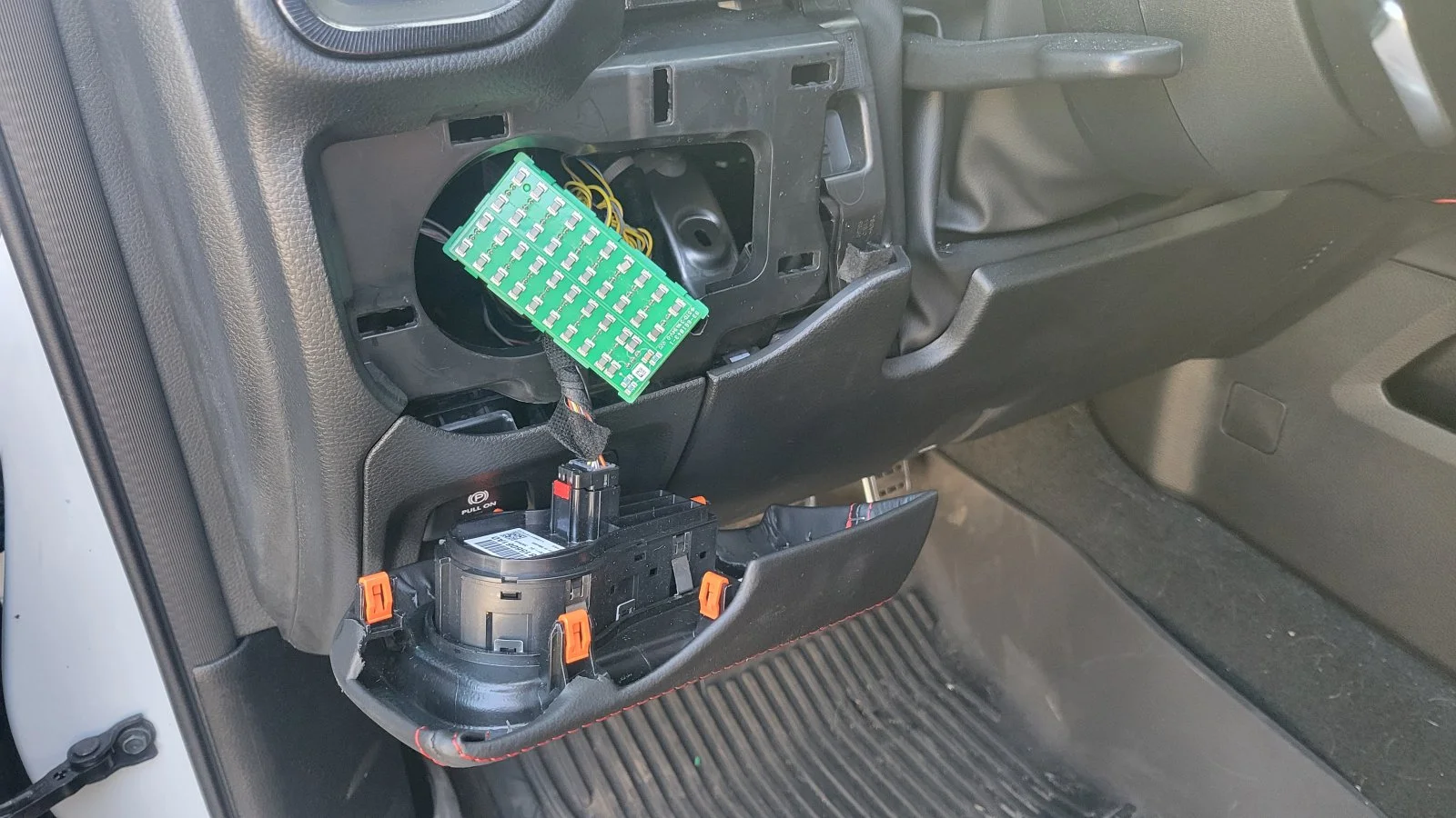

and to do this they don't need access to the OBD port, they go to the canbus connector behind the headlight switch?
Yep
That is one location they can go, its just the fastest and easiest and right next to the sgw which makes it even faster. They could technically T into the can almost anywhere, they just need to bypass the sgw
