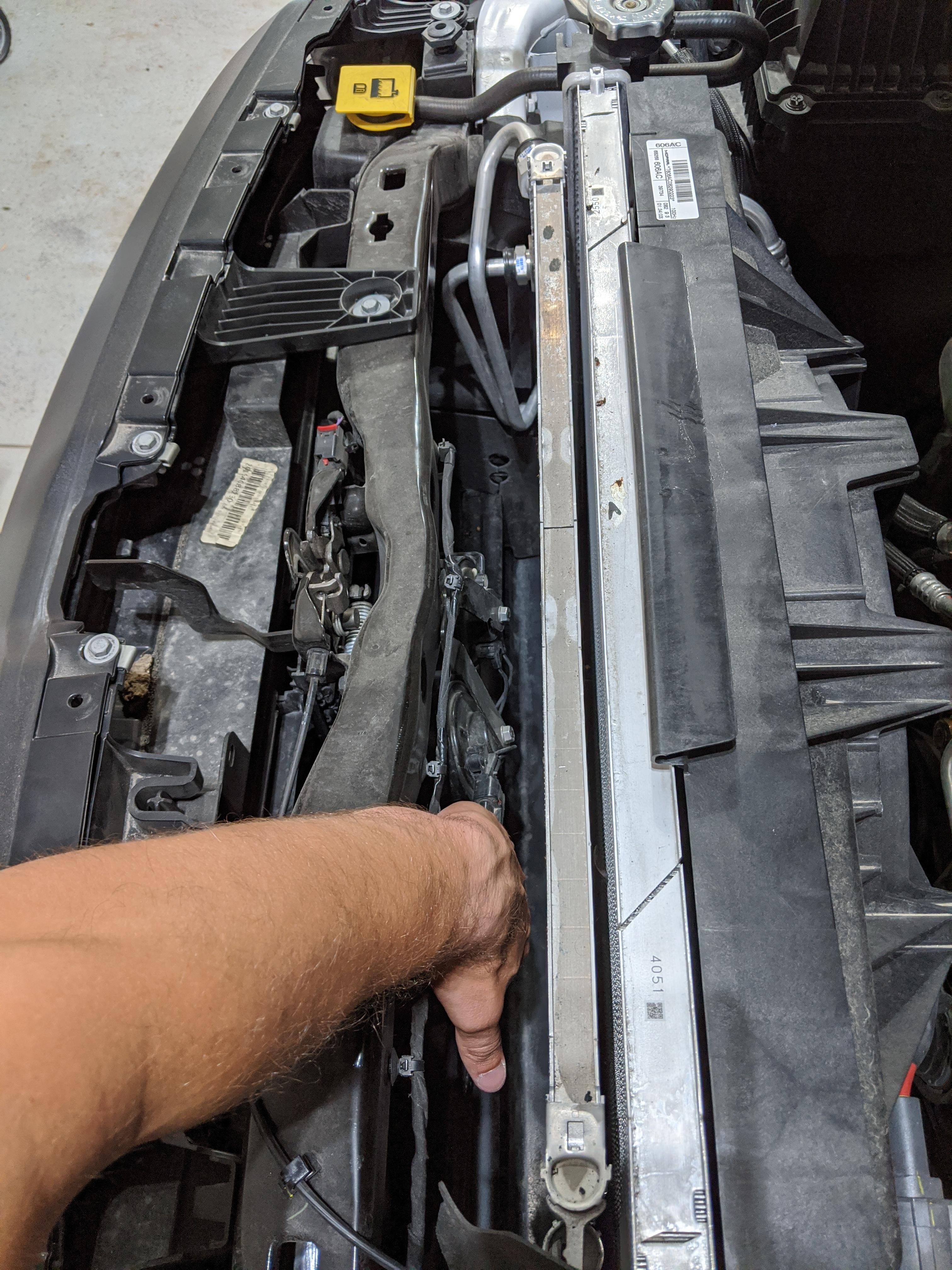

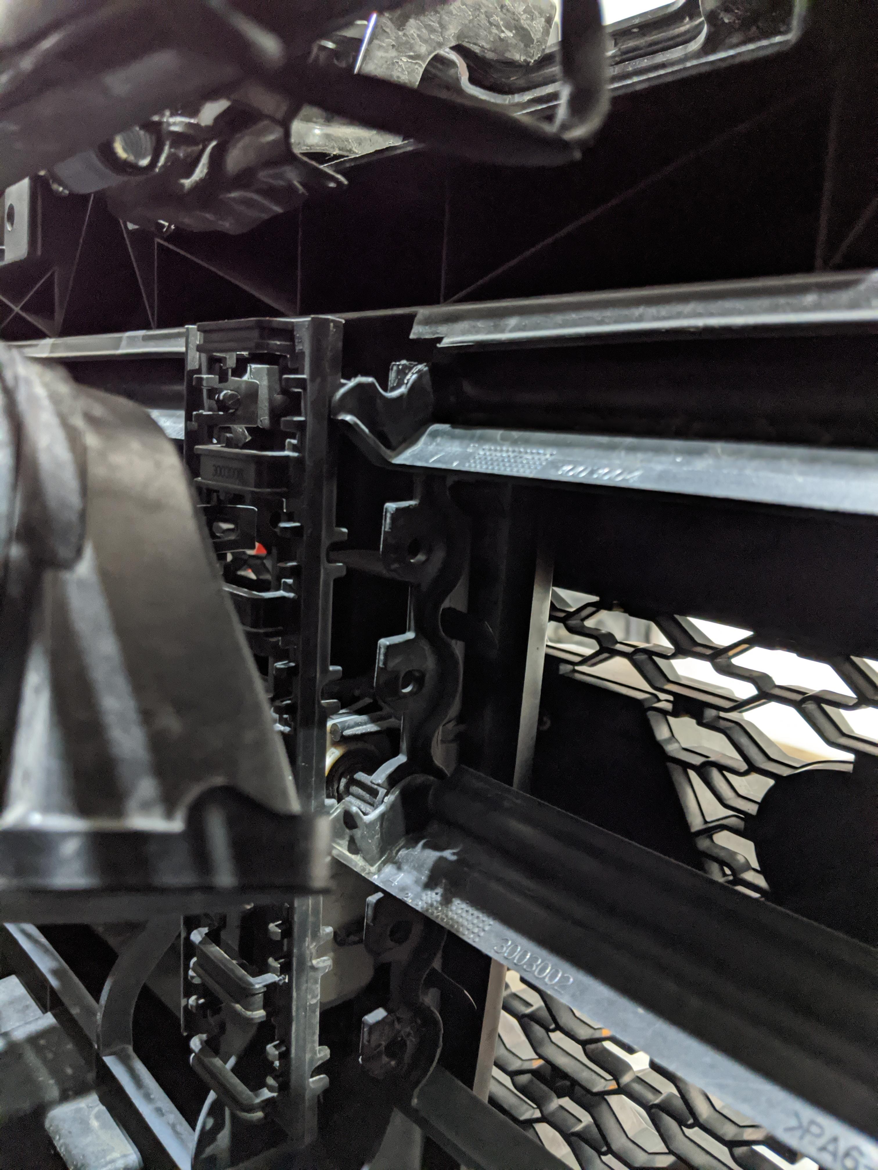

Here are a few pictures of how it looks and the route I went to remove the shutters. When you remove the plastic piece that says RAM covering the radiator, there was enough room to get my arm pretty much all the way down.

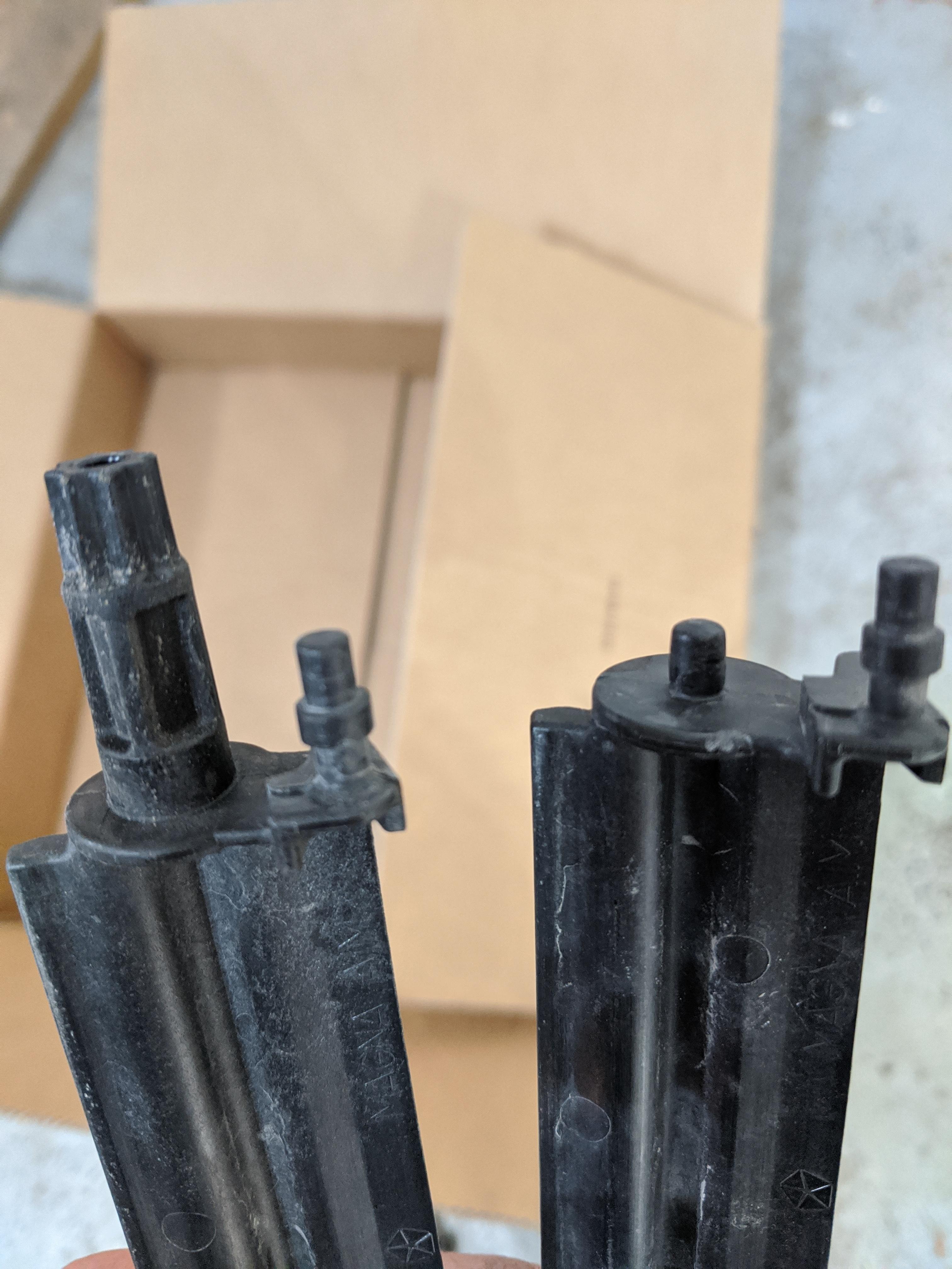

Here's a picture of the middle shutter vs the others. It doesn't look like the motor has an arm, rather the middle shutter has what looks like a gear end so that when the motor opens and closes, the middle shutter is what powers the rest. Point being, I think the middle shutter needs to stay on in order to keep the CEL off. I'm just guessing though.
