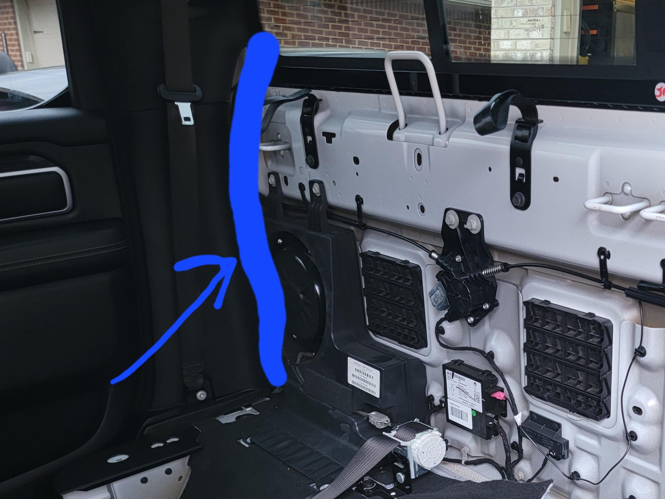

Within the past 2 months I've had a rattle/tick coming from back seat passenger side what seems to be behind the seat. My headliner rattles like crazy but I know that's not the noise in back. Driver side door rattles like crazy all the time. I took the passenger side door panel off and fixed a rattle but that was from door panel not full being clipped on. Driver side is all clipped on as I can tell by checking panel as it's not loose on Driver side. Anyone have these issues and have a fix? 2019 laramie sport with 49,000 miles.
Right here between the back panel and the side plastic panel. Before all my sound deadening, I stuck a piece a foam between the two panels and it fix it. Drove me nuts.
