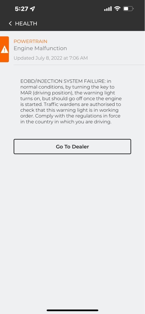

Any update on the resistor took mine off yesterday and the Uconnect app gave an alert that the was a code but no check engine light
An update I put back the aad and sure enough alert was cleared
