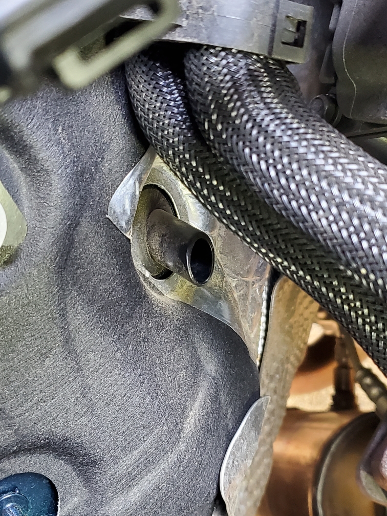

I shoved about a foot of drip hose down my condenser drain, No luck.
It's the small hose poking out on your firewall on the passenger side. fairly close to the engine.
is this the hose you talking about?
