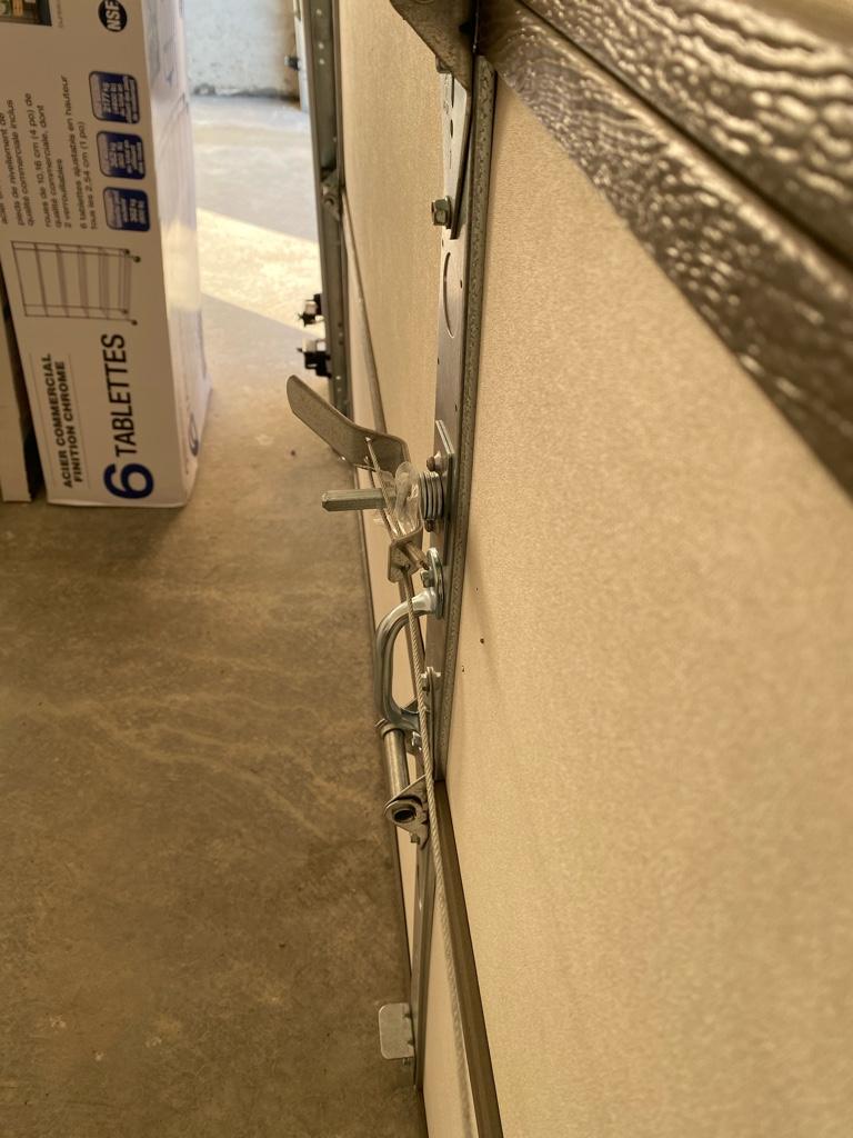

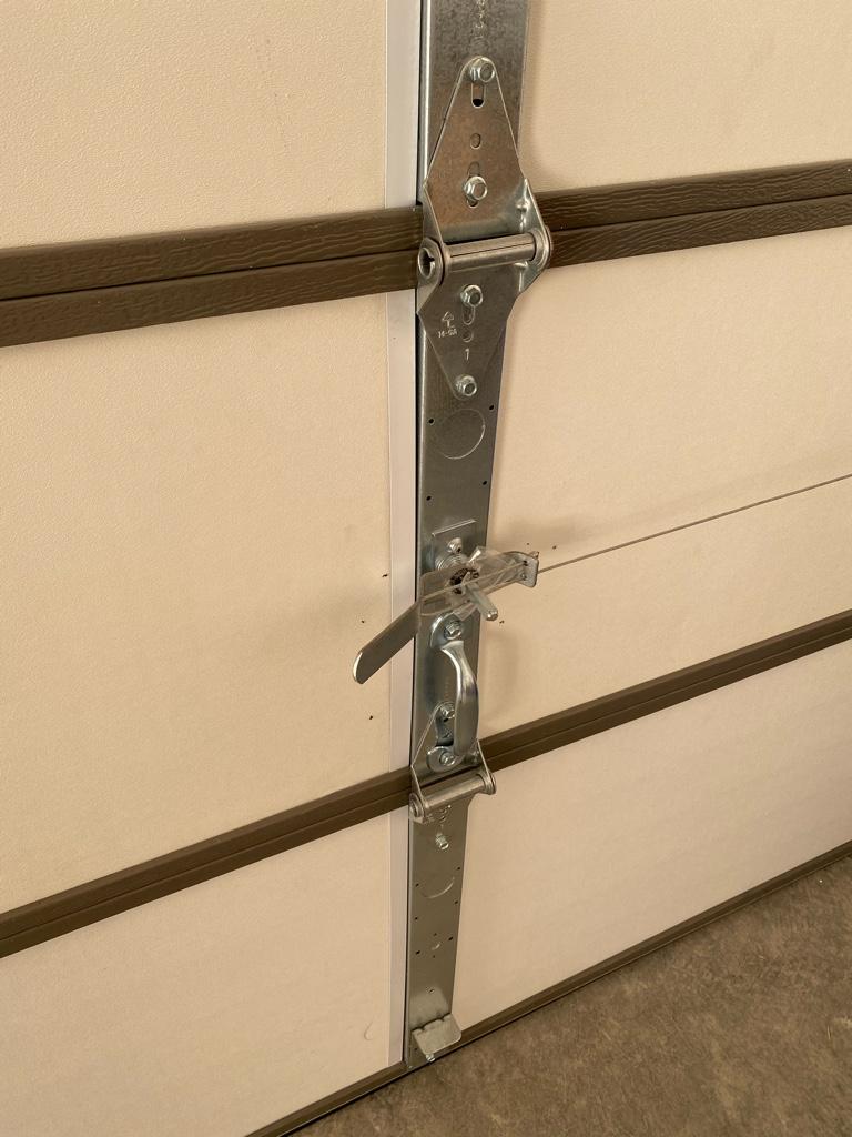

I parked inside and measured to make sure there is enough space between the garage door rail and the front bumper. However, I failed to notice that the garage door also has some metal hook that is sticking out so thats the one that damaged it on the way down and then on the way up. I win a Darwin award for this, I know...:(

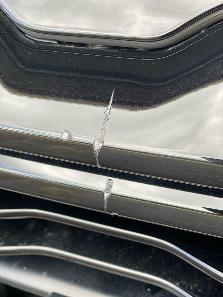

Found out today that the truck doesn’t fit into the new house’s garage - door went down and damaged the front of the vehicle, pic enclosed.
Please let me know how should I heal it now...

I'm very sorry for your headache. This happened to me a few years ago with a brand new Lexus SUV. $580.00 damage and repaint.

No idea what it’s there for

One of a handful of ways to manually lock the garage on the off chance you don’t have a garage door opener, or the opener completely fails for some reason. Mine is simpler and just one side, but I’ve seen your style as well. In your case, I’d remove the components but keep them just in case.

Locking mechanism. On my garage doors, I have clamps/slides on either side that I have to go over and manually slide to lock/unlock, where U could turn what appears to be a center handle, probably with a handle on the outside of the door (no idea if U have lock/or just twist handle) on exterior of door) to release lock and open door. Would need exterior pick of door handle, but I bet U have a twist handle on the exterior.
As others have said, it's the locking mechanism. If you have an electric opener then just pitch the entire assembly. If you don't have an electric opener, add one, and pitch the assembly. - they are cheaper than repairing the truck again. Throw out anything that sticks out farther than the hinges, then you could add padding to the lower part of the door so if it hits the door will reverse.
If power fails just pull the disconnect cord and the door will open and close manually.
Exactly a twist handle
Take a sawzall to the peg and cut it down some and stick a tennis ball over it. Bend the handle inward. Just enough so you can still turn it.
