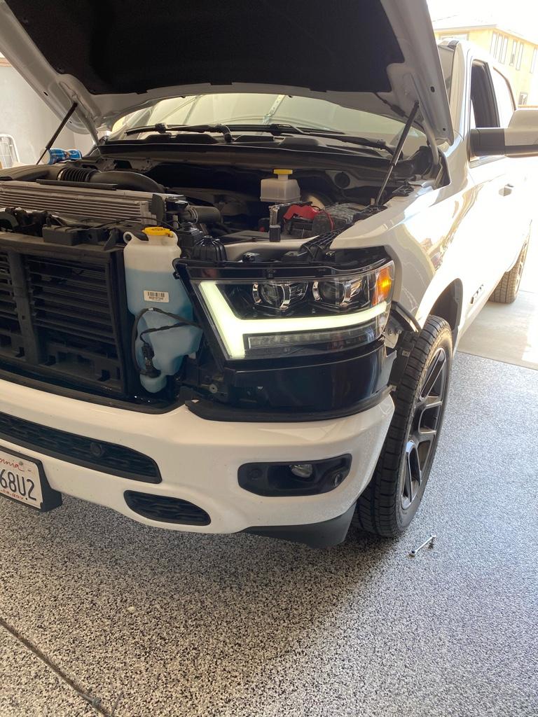

Did you smoke these? They look tinted in the picture. . .looks great!So the Wicked LED’s perform very well. And the AlphaRex headlights have a distinct horizontal cutoff . I need to fine tune the height and the LED clocking, but I’ve donated enough knuckle skin this weekend. One thing I do like about these on my all white truck, is that th LED DRL’s blend in almost like body trim, giving the truck a “look” I like. View attachment 53076
No smoke. These have the black background which kind of adds that look. I did a full demo for the guys at the dealership the other day. They approved!Did you smoke these? They look tinted in the picture. . .looks great!

When I ordered the AlphaRex PRO-Series Headlights, I noticed that they did not have any installation instructions posted on there website. So I contacted the Tech Support at AlphaRex. They told me to use the F66 fuse. Which is valid for the 4thGenRams but not the 5thGenRams. After he told me that he did not know which fuse to tap, he said that I could wire it to any 10 Amp - 20 Amp fuse that would come on with the starter.
When I saw that the fuse that was on the pigtail for the DRL's was a 15 AMP fuse I went with a 15-20 Amp fuse. I tested the fuse box with my Multi-Meter to figure out which one I could use that would only turn on when the truck was running. Most of the fuses had power all of the time. The only one that I could find was a F60 Fuse : ECM / PCM / ACT Short Running Valve.
Since this is a critical fuse I decided to use a fuse tap so that the tap was clean.

Here are some pics of the install:
Here is a link to the Headlights: I purchased the Black but they have three options: Black / Chrome / Jet Black

Finished comparison. Boy those panels under the lights....one came right of and the other was a bear. Make sure you look at the beam heights, took a lot of adjusting to get them right, one was way high, the other way low.
