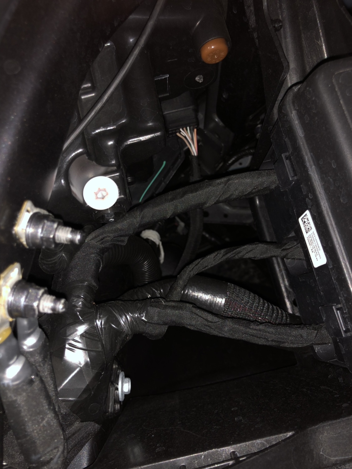

Anyone have success aiming their own headlights after lift or level?
Or is this a dealer only thing with the new LED's?

Was that pic looking down or up? And sadly I didn't create a height benchmark before I leveled my truck. Good'ole eyeball will have to do!

Anyone have issues with the limited LED’s? I see the set screw and read that counterclockwise will adjust down. Since day one my drivers side light is aimed higher then passenger side and it doesn’t react to turning the screw and I have turned quite a bit. Thanks
My driverside headlight has been pointed higher then the passenger side from factory as well
It’s hard to get it to turn with a Phillips I use a thin flat blade that only goes In one slot not both like a Phillips. I tried number one and two Phillips neither fit well. Try a small flat blade and I’m sure it will adjust.
Interesting, to me it looked like an allen/hex head, but my small phillips turned it with no problem... both headlights adjusted properly. So those that can't adjust might have something else wrong.

First night driving after the level/tires, realized I’m that a-hole lol.. in the limited it's white.. I used a 7/32 hex
Is the adjustment the same for the traditional headlights? I have the Bighorn without LEDs.
I used a big flatbit that fit really well in the hex. I think ram did a great job- you can basically use anything with a handle.
