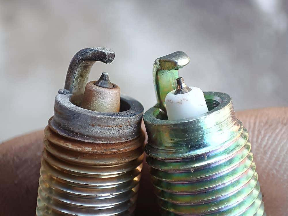

Couple folks have said they’re still good. 112K miles on em. I’m no expert, what’s a “bad” plug look like? How many more miles you reckon I could have gone? I’m split 70/30 on highway vs city driving.
Generally, when the ground strap starts getting eaten back from the electrode, is when it's time to replace them. As long as the porcelain isn't cracked and the ground strap is intact, the plug is still good.
Strangely, on my previous truck (2003 hemi) I changed the plugs around 155K miles hoping to improve the fuel mileage; the ground strap was missing about 1/16th" yet the truck still idled silky smooth and drove fine. Fuel mileage didn't change one bit, I'm guessing the dual plug configuration on the hemi does have benefits other than emissions.
Left is a bad plug and similar to what mine looked like at 155K miles
