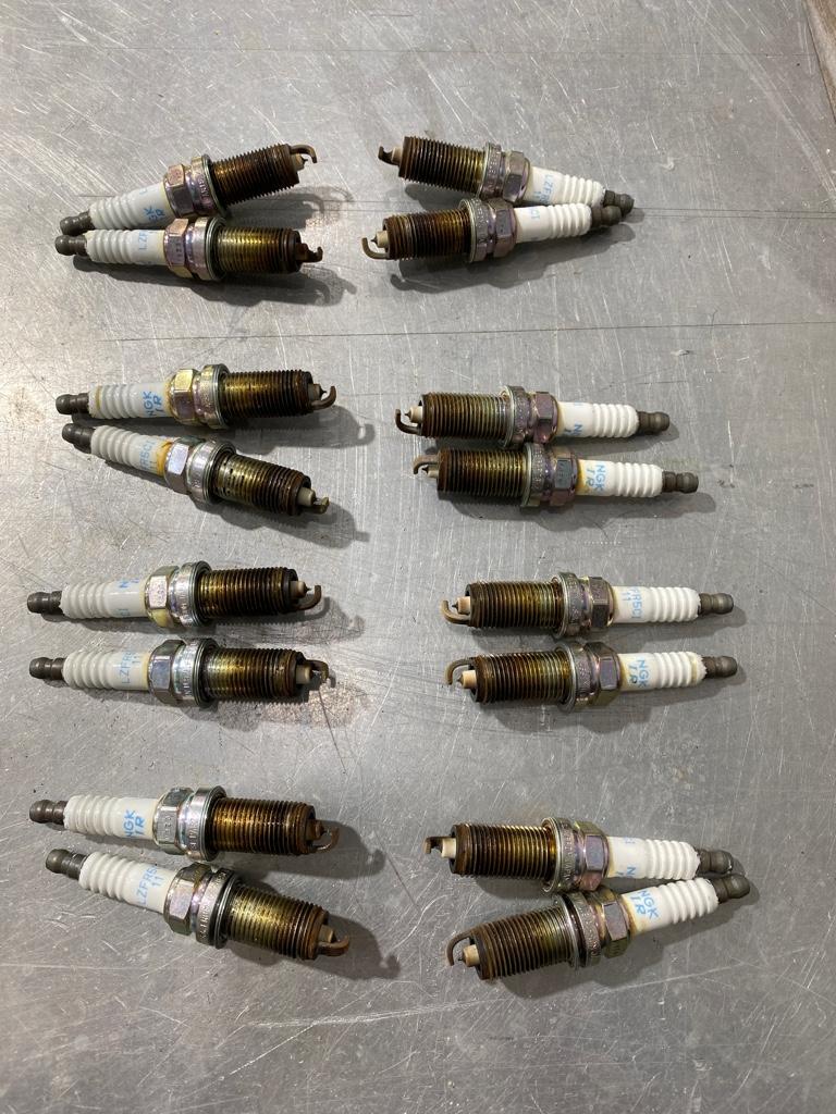

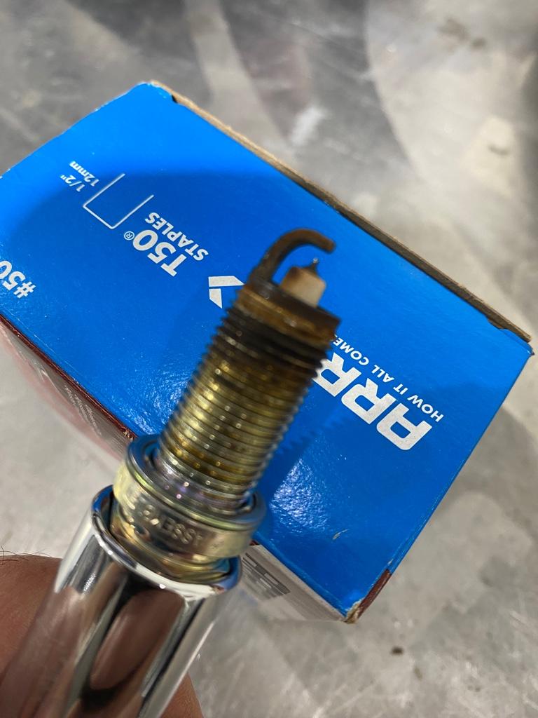

I didn't notice a single bit of difference on my previous truck, 140K on the original plugs with the ground straps burned halfway off (used-up). Truck idled perfectly smooth before the changes and idled the same afterwards. no improvement in mpg or performance and after seeing the plugs, I expected an improvement. The fact that it has 2 plugs per cylinder may be why there was no noticed performance/mpg gains

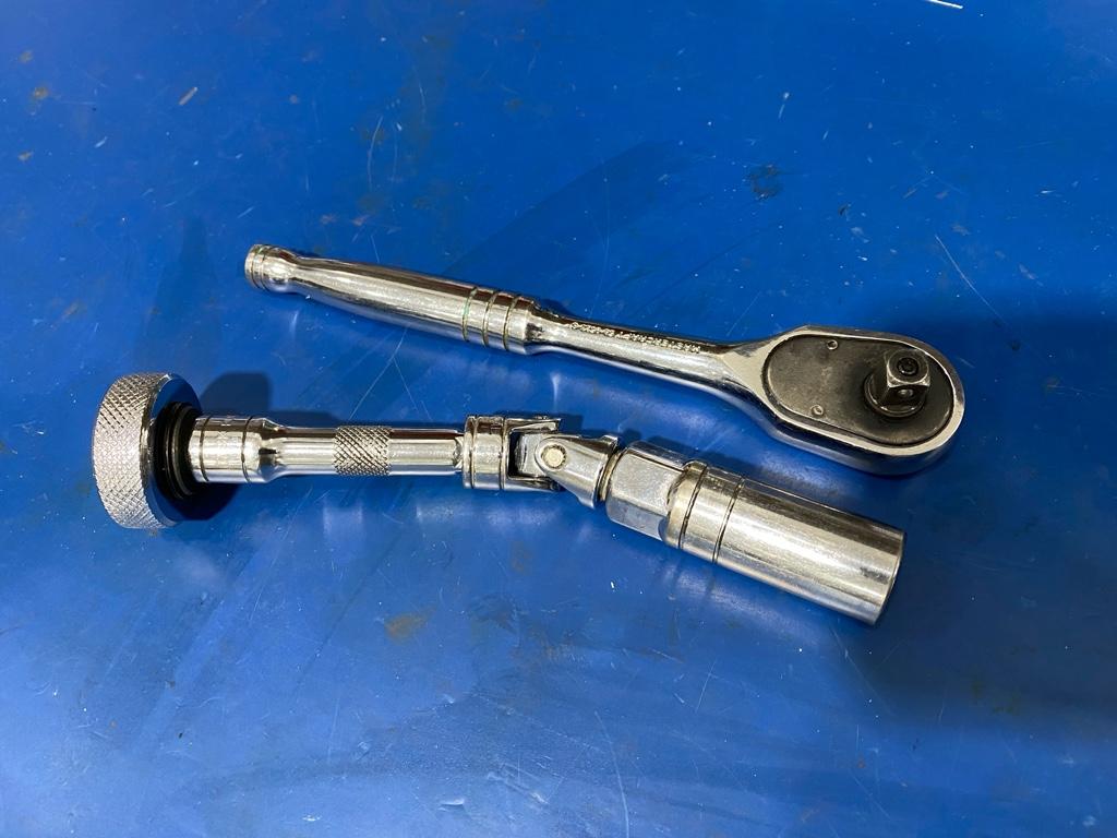

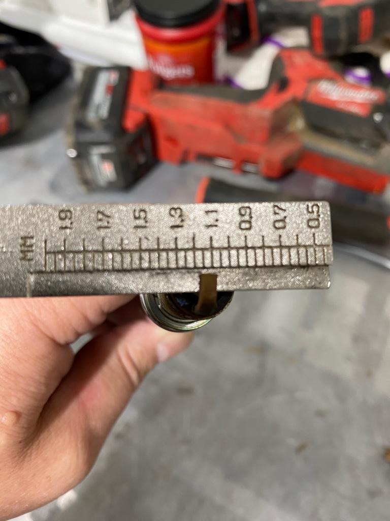

I swapped out the serpentine belt and spark plugs today as part of my 100k mile tune-up. I'm pretty tore up from doing yard work and firewood so I just took my time and finished in around 2 hrs. Pretty straight forward in the end but I cycled through a bunch of different combinations of sockets, extensions and swivels to reach each hole without dismantling anything. Everybody talks about having a lift to work on vehicles but this is one job where you almost need a pit where you can sink the whole truck down about a foot and keep your feet on the ground.

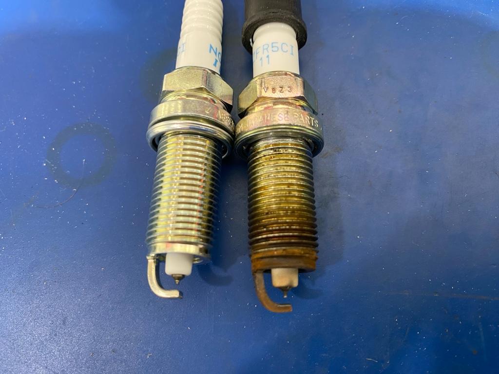

I skipped the Mopar plugs and went with NGK OE Series Laser Iridium plugs from Advance Auto, (LZFR5VI-11). Stockers looked pretty decent still so I don't anticipate much of a difference, if any.

I just saw the other day, counterfeit NGK plugs being sold. I forget about one small detail on the boxes, but your old plugs have that lot number on the hex. True NGKs should have that too. the counterfeits don't. The guy making the video took ohm readings on both types, and the true ones were all close in the readings, but the fakes varied by thousands of ohms. His used ones tested better.

Interesting video. I didn't inspect each plug that closely but I'm pretty sure mine are all authentic NGK. One case had the plastic thread protector, the other 3 had paper so that detail may not be a positive indicator alone. All 4 cases were the same size and had the same print. I've been burned on Amazon before with either counterfeit, factory seconds or just used or returned items so I am careful what I buy from them now. The Mopar plugs on Amazon were setting off red flags for me so I decided to buy local rather than take the risk. Dealer only had 8 pugs in stock so I figured I could trust Advance auto and save $2/plug. Combine that with an Advance Auto Perks coupon and I got 16 plugs and a Dayco Serpentine belt for less than what the dealer wanted for plugs alone.
