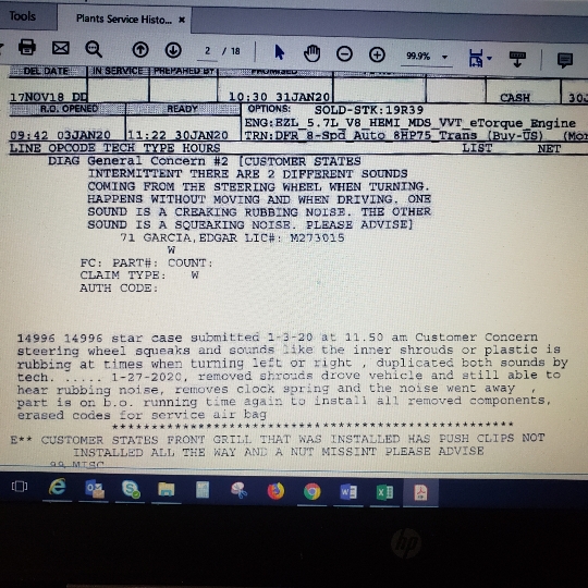

I have a intermittent grind/squeak when turning either direction while driving or standing still. Dealer has "clock spring" on order (back order with unknown date) for replacement. Dealer opened Starcase and supposedly got engineer involved.

Negative. Squeak/grind when turning. They replaced clock spring, no more noise so far.
