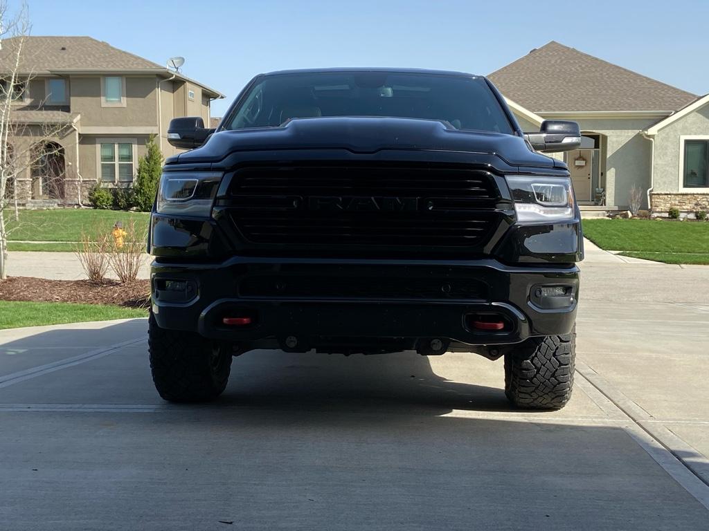

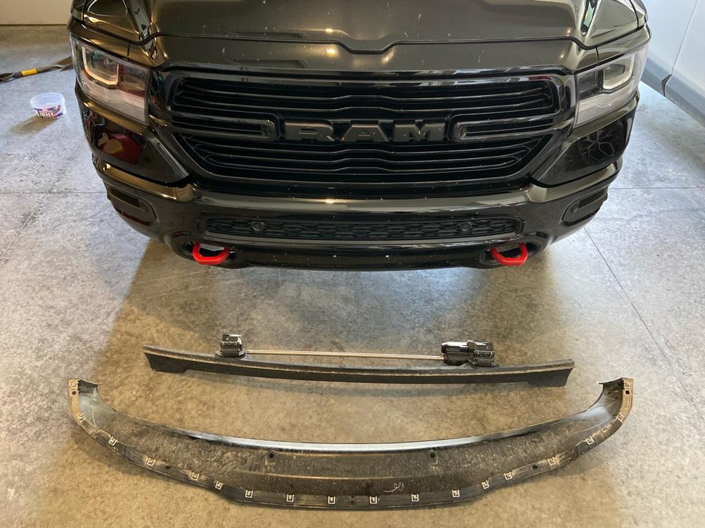

Looks. So much cleaner, if my rebel came with one it would have been the first mod.
Love mine removed and have take off for sale if anyone with a Limited wants to drag the ground with it.
Now that’s what I’m taking about. Ty for the pic. I’ll be trying this after I get truck back!!!

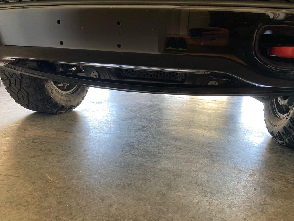

Sorry the picture is crumby, my truck is in the garage but I just hung it back on without the front air dam to see how it hangs. Overall, the active air dam hangs 3” lower than the bumpers lowest position (below the tow hooks) and about 4” lower at the center.
Thanks for doing that. I agree it would not look good to put the active air dam on without the fixed air dam in place
Wouldn't do anything as you would have a big gap between the bumper and the retractable airdam.
I agree. I hadn’t been under my truck lately to see how everything was arraigned

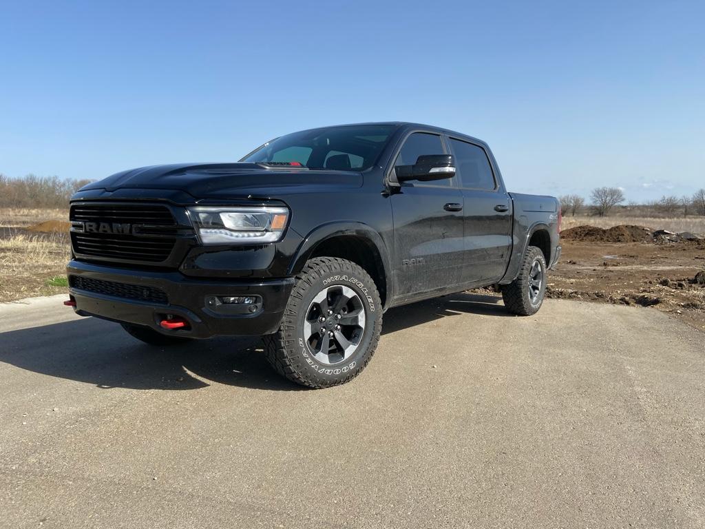

Removed it today, looks way better , g
Going to be way better off-roading and during winter times
