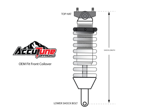

I'll show you how to measure your coilovers give me a minute to pull the info.
Form accutune
How to Measure your coilovers
With your vehicle at ride height on level ground, measure from the top of the “top cap” to the center of the lower shock bolt. This is the shock length at ride height with the vehicle weight on the shocks. With some quick math, we can figure out where the shock is sitting and how much up or down travel it has from that point.
(see chart for max height suggestions)
[IMG]
In your case, you have Fox FOX-883-06-166 per your OP, those are the extended travel version so they should be 1" longer than stock

Measure from your top hat to the lower bolt at ride height. From all the examples they have you want to keep 1.5-2" delta from their extended lenght tops at ride height
so in your case, the lenght of your assembly at ride height should be no more than 22-22.5" if you had the 883-06-166
or 21.25"-21.75" if you had the 883-06-165
You can contact Accutune for a more accurate statement. they make a living out of this and will give a better run down as to what the max lenght can be according to you what have.
