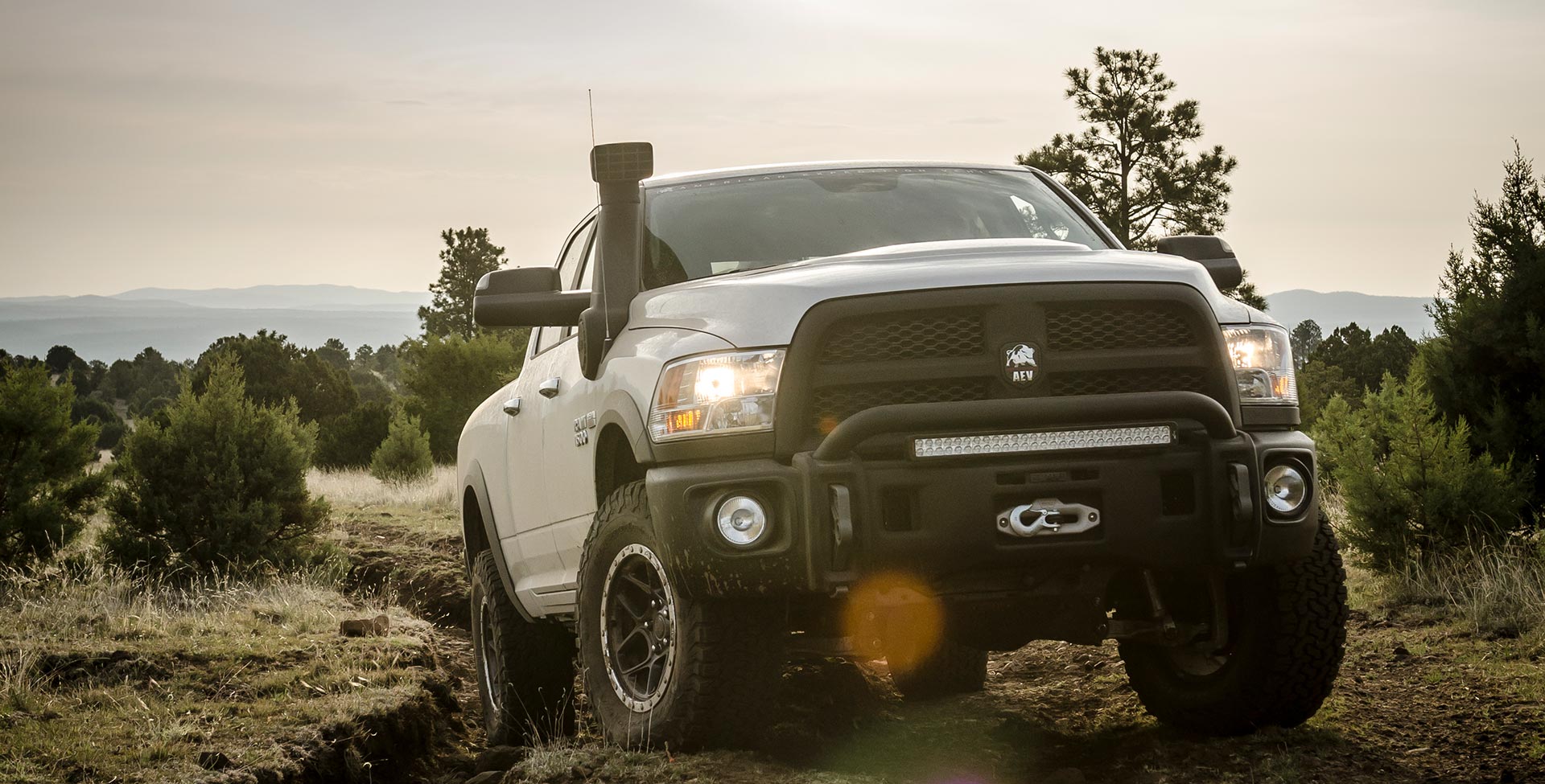

Hmm. as much as I'm a little bit of an "air bag skeptic" (Firm believer in rake), I do like the falcon's enough that I'd rather go to level, put on the tires I want, and then use airbags in a pinch when needed. I'd literally rather use airbags and the shocks vs mess with them too much.
For now happy with this set up and tires size. Works well hauling the family and the trailer. Handling is good as a daily, at least as a well as I can expect a truck to handle.
Once AEV comes out with their lift for the DT I will go that route if I really want to go bigger on the tires. Have the full set up on my jeep and it is all factory level or better stuff. Or maybe just get a Powerwagon, or TRX, or a diesel gladiator. Need to go check my lottery tickets...
