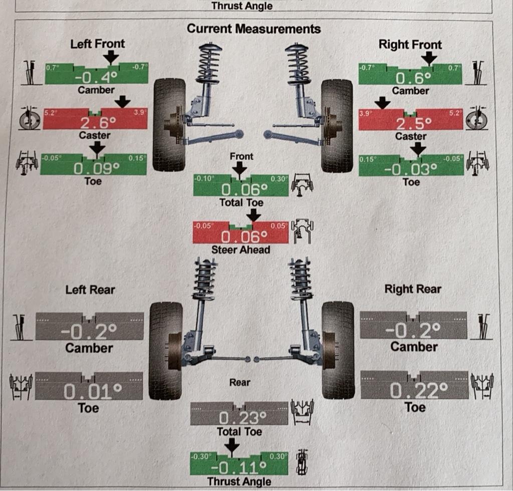

Has anyone here experienced any type of issues when installing the Fabtech 3” Lift Kit?
Everything bolted up fine, however, the front will not realign back to factory specs.
The alignment tech was telling me that he felt like the upper control arms were too short and he wanted me to put the factory ones back on. He was saying that if the caster was aligned properly that the camber was way off. The way it currently sits is what he described as the best he could get to make it drive straight with the equipment that’s installed.
I’ve been emailing back and forth with Fabtech support and they are saying that according to their R&D team, everything is fine on their end and they don’t know why it won’t align properly.

Does the kit come with UCAs? Do you have a part# on those UCAs?

When you lift them it’s going to change the alignment specs some... the new upper arms should help but not always. There’s only so much alignment adjustment in them. Now a better alignment tech could probably get things closer to factory specs but you reach a certain point where it’s not feasible.

Typically with lifted trucks the caster is more around +4-5 range. You can't follow factory specs if it's lifted because nothing is factory anymore. A good offroad or truck shop will be your best bet for a proper lifted alignment

OP, you may contact Fabtech and ask them if their UCA's are stock lenght/offset or if they're built with an offset for their 3" lift. If they're built in with the offset then all you have to do is find a competent shop that can do alignments. 4wp and the like are not that type of shops for example.
This is the lift of UCA's i have. They're for 4th gen but should fit 5th gen, you'll see Icon, BDS, and others that are already showing in web sites for 5th gen with the exact part numbers so you can bet the house 4thgen and 5thgen UCA's are the same thing.
