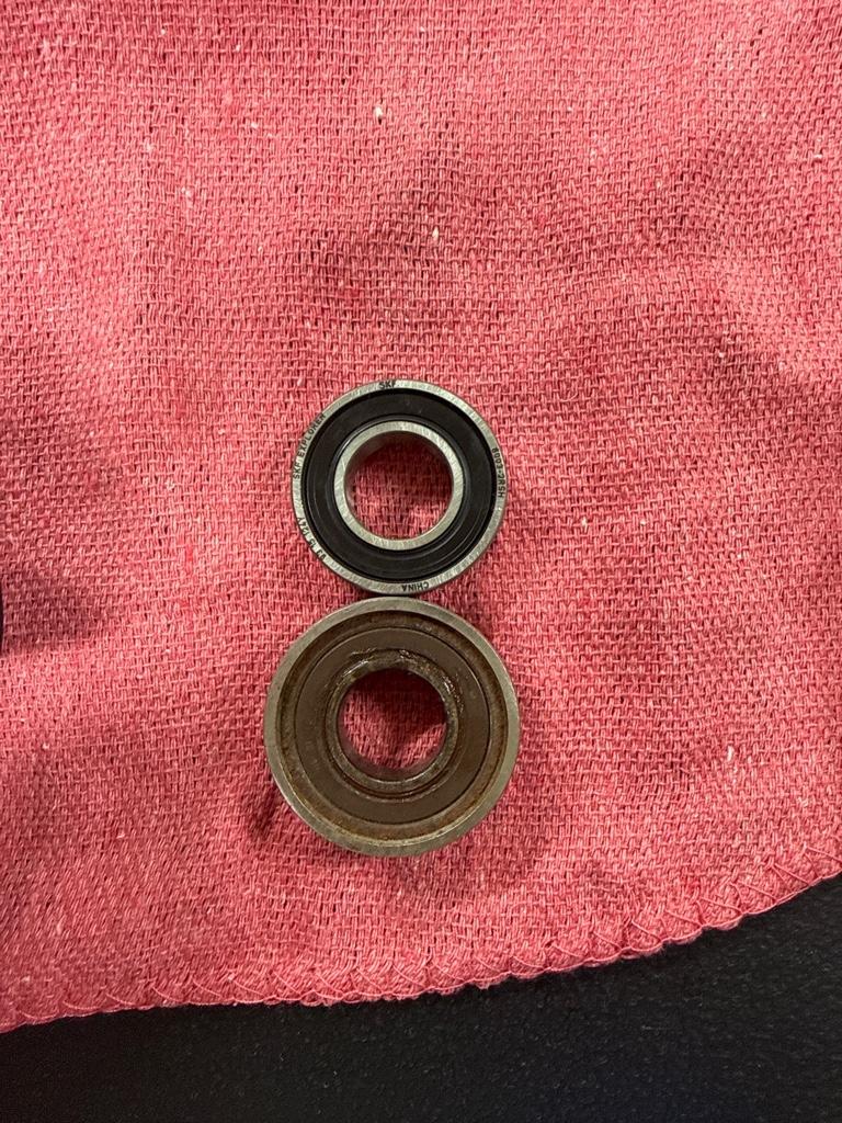

Does anyone have the correct size bearings for the MGU? 2019 ram 1500 5.7 I’ve tried the McMaster part number 6661k86 and I’ve also ordered the 6003-2rsh. Both are too small
From another thread-
He has a 2019 and just opened mine up today. Both bearings are different than any listed anywhere online. The front is a standard 25x62x17mm bearing with snap rings on both sides. The rear is weird. It's 17mm ID, 40mm OD, but the outer race is 13 mm wide, and the inner race is 10mm wide offset, flush with the outer race on one side. This one has a snap ring as well.

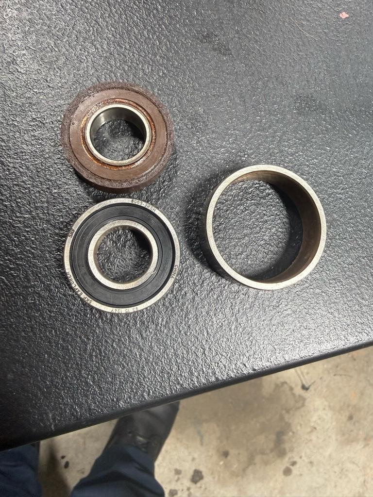

So this is hilarious, it’s not a special bearing.. it is the 6003-2RSH bearing. After a closer look, what had happened was the inside sleeve that was supposed to stay with the housing was frozen onto the bearing. Once I had it off, it just had to be tapped back into the housing. I tried to still get the pulley off but don’t want to damage it and really be screwed. Put it all back together and it’s quiet . Before hand the thing was screaming in agony . Funny enough how the bearing looked in the sleeve when it was out it looked like it was all one complete piece and even a couple of bearing shops didn’t catch it and thought it was a special bearing
Wow, nice catch. This will be useful to others who happen upon the same situation. Thanks for posting!
