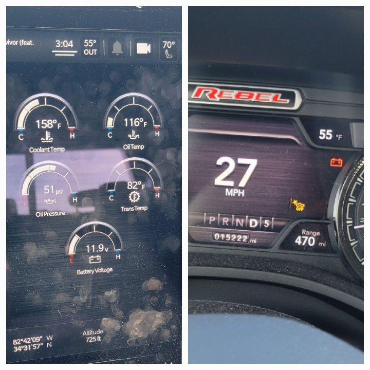

Tue. 12/14/22 ~ 3:03 pm (15,222 miles)
- while making a left turn from Whitehall RD onto Sullivan road the truck abruptly shut itself off, went into PARK & applied the e-Brake with my truck stuck in the oncoming Lane. Oncoming traffic luckily stopped for me to clear the road.
- Same scenario as before, with the “Battery” fault symbol on the dash but was able to start the truck, release the e-brake, and get it in DRIVE again to get going again. During the rest of the 30 min drive to work, I had the digital gauges up on the radio and could see the battery voltage was at 11.8v - 12.0v for the entire drive to work.

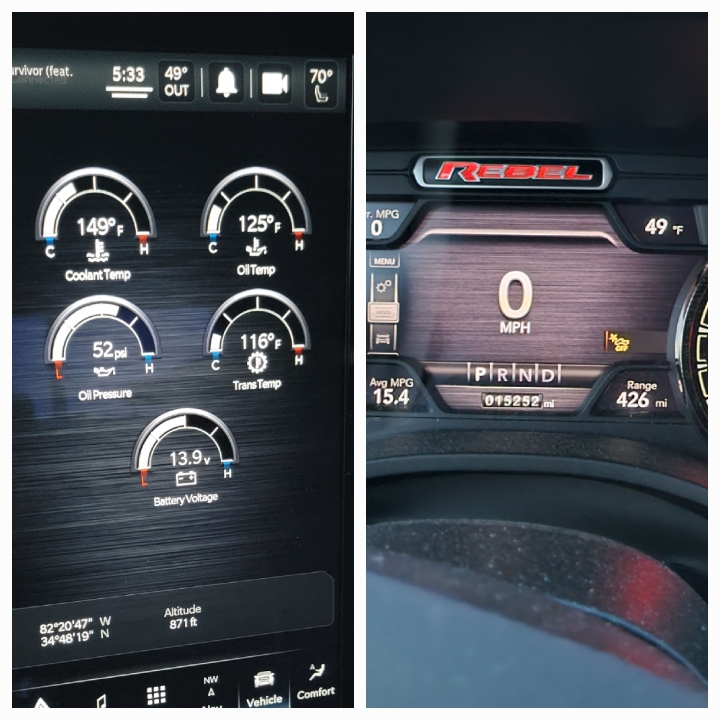

Tue. 12/13/22 ~ 5:33 pm (15,252 miles)
- After sitting for 2hrs, I came out to call the dealer service for an appointment from the truck and saw the digital gauges on the radio and the dash cluster back at 13.9v -14.0v.
The issue hasn't repeated itself (yet).
- The only other recent change I can think of with the truck was that I reconnected it to my home WiFi for future radio SW updates/downloads a few days before. (v26.17 is getting released? TSB 08-211-22)
** No issues between 7,427 miles and 15,222 miles? **

how long was the truck running?
imo the coolant temp gauge shows a low temperature
show pictures to dealer
