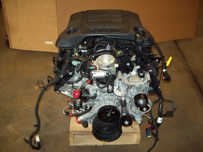

Was browsing ebay for something and came across 2 engine listings.
12k miles $4200 and one under 1k miles for $4600. In case you want to look into it. You may still want to go new but just passing this info along. Do your own checking as far as warranty, buyer protection and stuff.

Thank you guys for all your input. I really do appreciate it. I’ve already moved forward with dropping a new engine. Had to put 7k down to get the ball rolling. I also went with, what I was told, is the newer version of the hemi that does not cut out the 4 cylinders when driving highway or maybe, i guess “eco mode”. So one final fact, that I didn’t mention, is that I had my 2019 RAM idling a lot. Like 4 hours everyday. And I heard a guy, that you might know, on YouTube (Scotty Kilmer) that a hemi should never be left idling. He didn’t say why or if my specific issue would ever happen. But does anybody think that excessive idling could cause the oil cooling system to fail? And two, do you guys know that the newer engines does not go down to 4 cylinders and did I choose the best option of an engine? It cost me an extra grand to go that route. Thanks for any replies!
Update, as you might can tell, I am not a mechanic. I understand that when I am referring to the engine going to 4 cylinders, that is the MDS. I see nothing on the interweb which tells me that RAM has gone away from MDS. So I might have ignorantly trusted my guy that is dropping my engine. Unless someone knows why I was told that they have stopped using MDS, I am going to call my guy tomorrow to understand why he told me this.
Id assume its aftermarket cam and lifter setup that deletes the MDS function. Im not sure if it needs to be tuned out of the ECM. I would get stuff in writing so its spelled out what you are buying.
get the specifics of what your mechanic is actually installing because I don't believe there is a new hemi engine, the only upcoming ram engine that I know of is the hurricane engine so the only thing is as Gmetal noted, the after market delete. Did you specifically ask for that
The only engine with no MDS is the trx engine
The 6.4 hemi doesn't have MDS.
Not sure if it would fit in a 1500 though.
All current 5.7 hemi have MDS
I don't understand why the OP is getting sold something so expensive.
Can get a 5.7 hemi crate engine for $6000, obviously need to spend more for the rest of the parts, but $1600?
6.4 hemis have mds.
