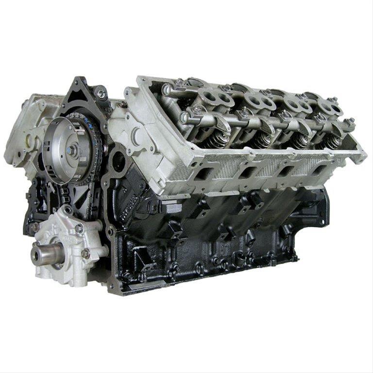

Engine locked at 74,000 miles

Update, as you might can tell, I am not a mechanic. I understand that when I am referring to the engine going to 4 cylinders, that is the MDS. I see nothing on the interweb which tells me that RAM has gone away from MDS. So I might have ignorantly trusted my guy that is dropping my engine. Unless someone knows why I was told that they have stopped using MDS, I am going to call my guy tomorrow to understand why he told me this.
To get the extra grand outta you?
Sorry, could resist... ;)
Id assume its aftermarket cam and lifter setup that deletes the MDS function. Im not sure if it needs to be tuned out of the ECM. I would get stuff in writing so its spelled out what you are buying.
Yes, must be tuned out, and there ain't no way a dealer is doin' that.
I mean to be fair, if you are getting a new or rebuilt engine put in you may as well have MDS completely removed imo.
I do wonder if the ECM is going to need a tune so it doesn't try and trigger MCS electronically?
If we had the option I'm sure at least 60% would opt to not have the "feature" from the factory (assuming you are getting a v8 and not a 4/6 cylinder)
No one should wonder "if" you would need a tune. Of course who cares if nothing actually responds to the solenoids to trigger MDS, you could plug in any kind of fooler. FCA closes down the valves for a reason - continuing to pump air thru would most definitely raise the O2 before the cats, overheating and melting them and driving NOX thru the roof.
What are you even talking about?
Disabling MDS is a common thing.
The thread moved into MDS removal discussion, reread about the last 5 posts. To build the motor with Mopar or aftermarket non-MDS parts is not OEM EPA rated, and FCA assumes it will be "off road" and tuned accordingly. Reread the cats problem. There may be other problems related to running straight air thru the cylinder and valves. I really hope you are not talking about pushing buttons in the OEM truck.
