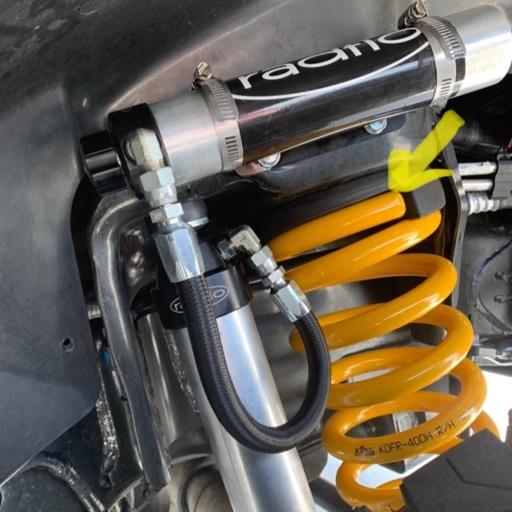

You can take your finger or use a light and feel for where the top of the spring coil touches the upper mount making sure its lined up and against it. Hope this makes sense. Arrow is where the spring would seat. (Random mount picture).
I guess if it wasn’t seated in the right position and there’s a huge gap that could effect the height.

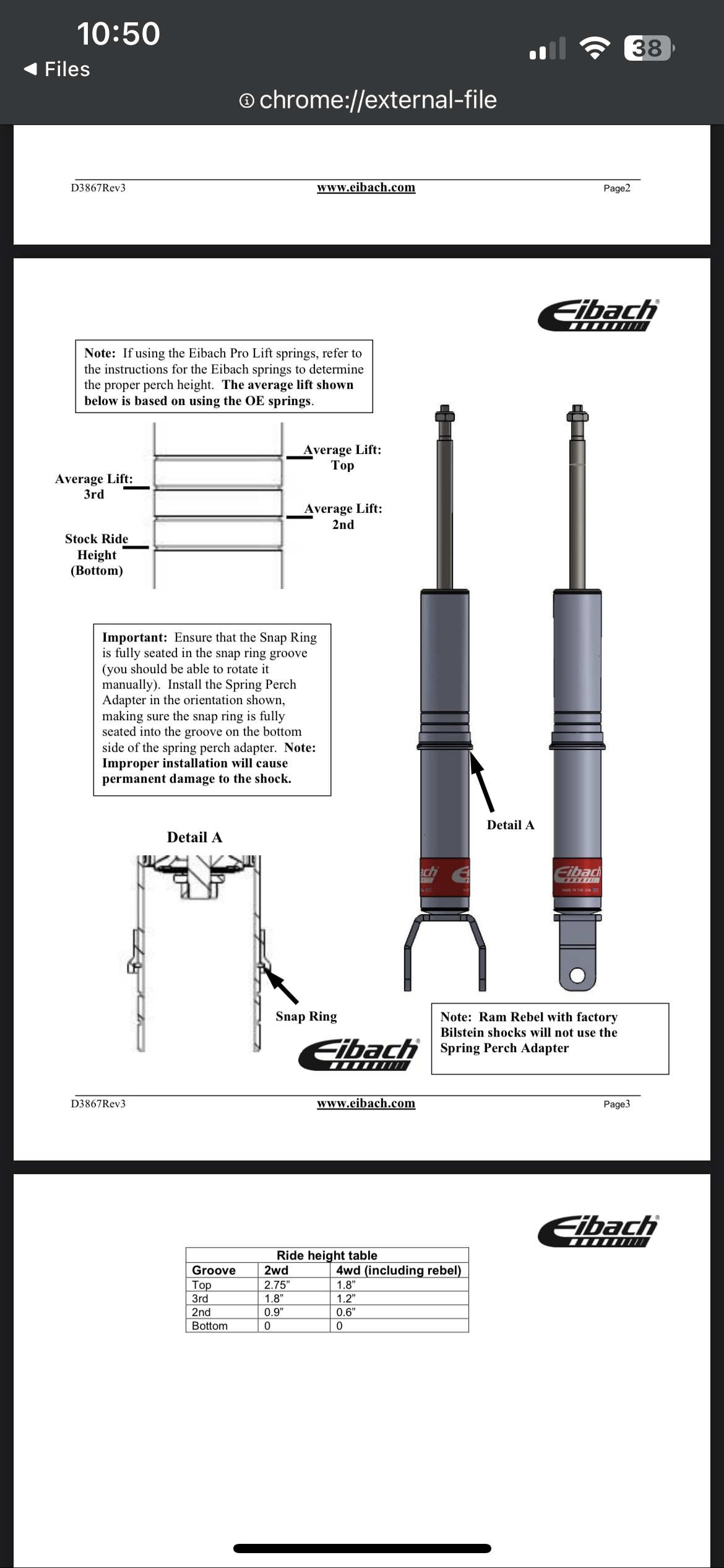

I have a non-ORP Bighorn that I recently had Eibach front shocks installed with ORP springs on clip #3. Eibach told me I would get a 1.2" lift at position #3 on 4wd Ram 1500 which would put me around 2.2" total lift with the ORP springs. I think I got more lift than the 2.2" but I could not find my original numbers. I ended up being 39.125" from ground to fender (23.5" from center hub best I can tell) on my driver side but the passenger side is 1/2" higher. I took back to the shop to check the the numbers on their alignment platform and confirmed that the passenger side was higher by 1/2". They visually inspected the install and did not see anything wrong. Once I got it back, I started taking some measurements and found that the passenger side is 1/2" taller from the bottom of spring to the top of the strut mount. I also checked from the top strut mount to the first 2 spring coils and they are not the distance from the top mount. I tried to take the measurement as close to the same spot on each side since this could easily be thrown off. The distance between each coil seems to be the same on each side so it doesn't seem like one spring is getting compressed more than the other. I'm trusting the first measurement from the top mount to the bottom of the spring since that is not as location sensitive. I took some pictures of each side where you can see the spring is not sitting the same. Maybe this is normal but I wanted to see if anyone else has experienced this and would know what could cause this. The shop offered the swap the springs to see if the lean moved with the spring but I am thinking there is just something going on with the passenger side since that is sitting higher than it should. I attached pictures of what I am seeing.
This probably is not the reason you are a 1/2 inch higher on one side, but I believe Eibach’s lift diagram is off. Guys on this forum that installed a few months ago were getting the height mentioned in their old instructions (the photo w the lift on the strut). Recently, Eibach revised their instructions to match 2wd/ 4wd and Rebel. We all know Rebels and ORP a little more lift than the stock 4wd. Compare Eibach’s new instruction to the Bilstein 5100’s and I believe there is a clerical error somewhere in Eibach’s lift diagram.
that shows the same lift for standard height springs on both versions of the docs for 2wd. Is that what you’re referring to?
TJ1789
Aug 16, 2020
26
9
Yeah but it doesn’t make sense lol. 2wd shouldn’t get more lift than a 4wd and a 4wd shouldn’t equal the lift of a Rebel because of the springs used. Maybe I’m wrong but I believe it’s a typo.
