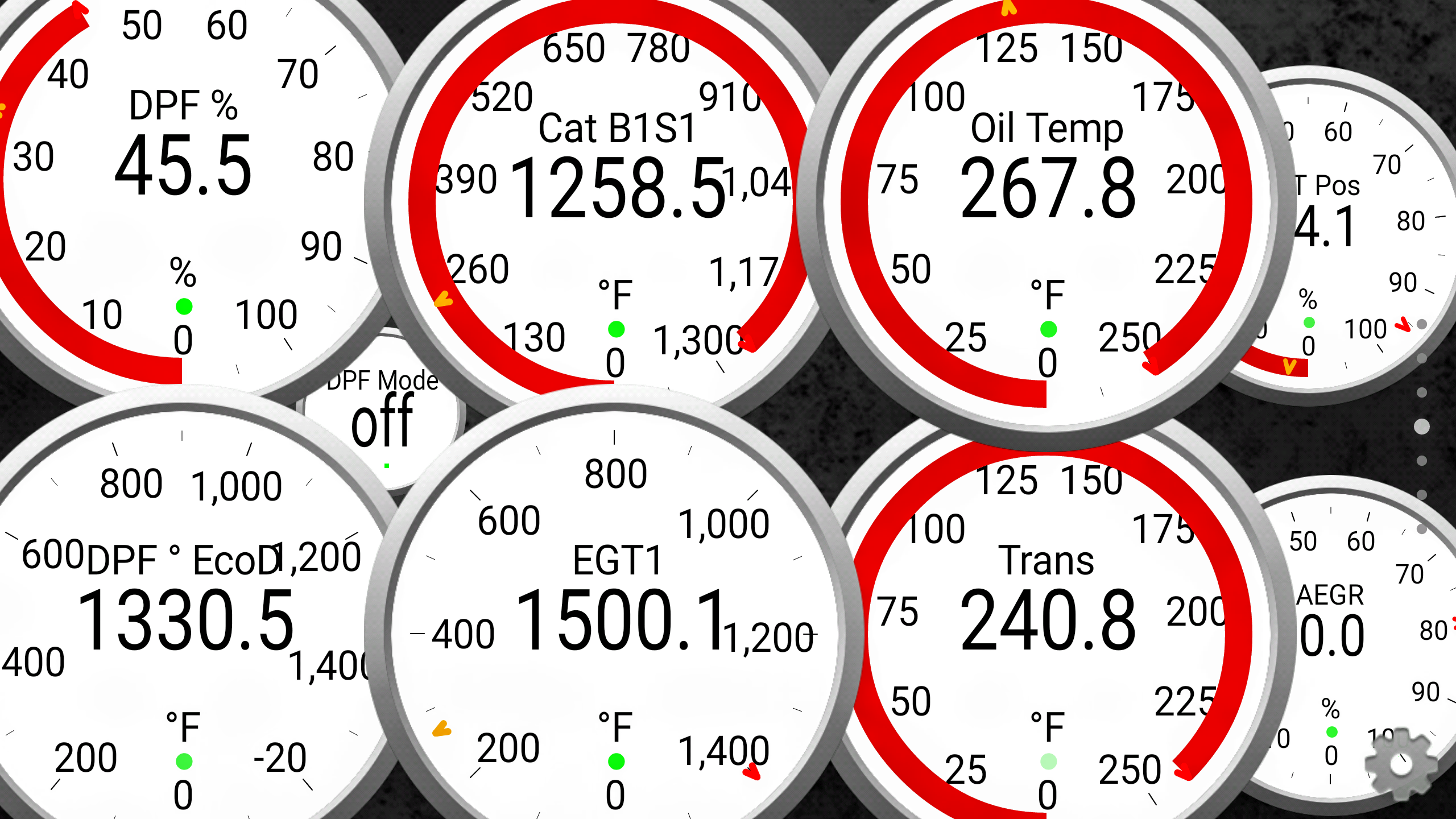

I was just wondering. If it did that I'm sure EGT's would soar if it stayed in 8th lol
My 2015 ED EGT held 1500° ALL the way up Loveland Pass while pulling my 6,000# Travel Trailer.

That would've had me worried in my old truck. Downshift that baby next time and they'll be lower.
