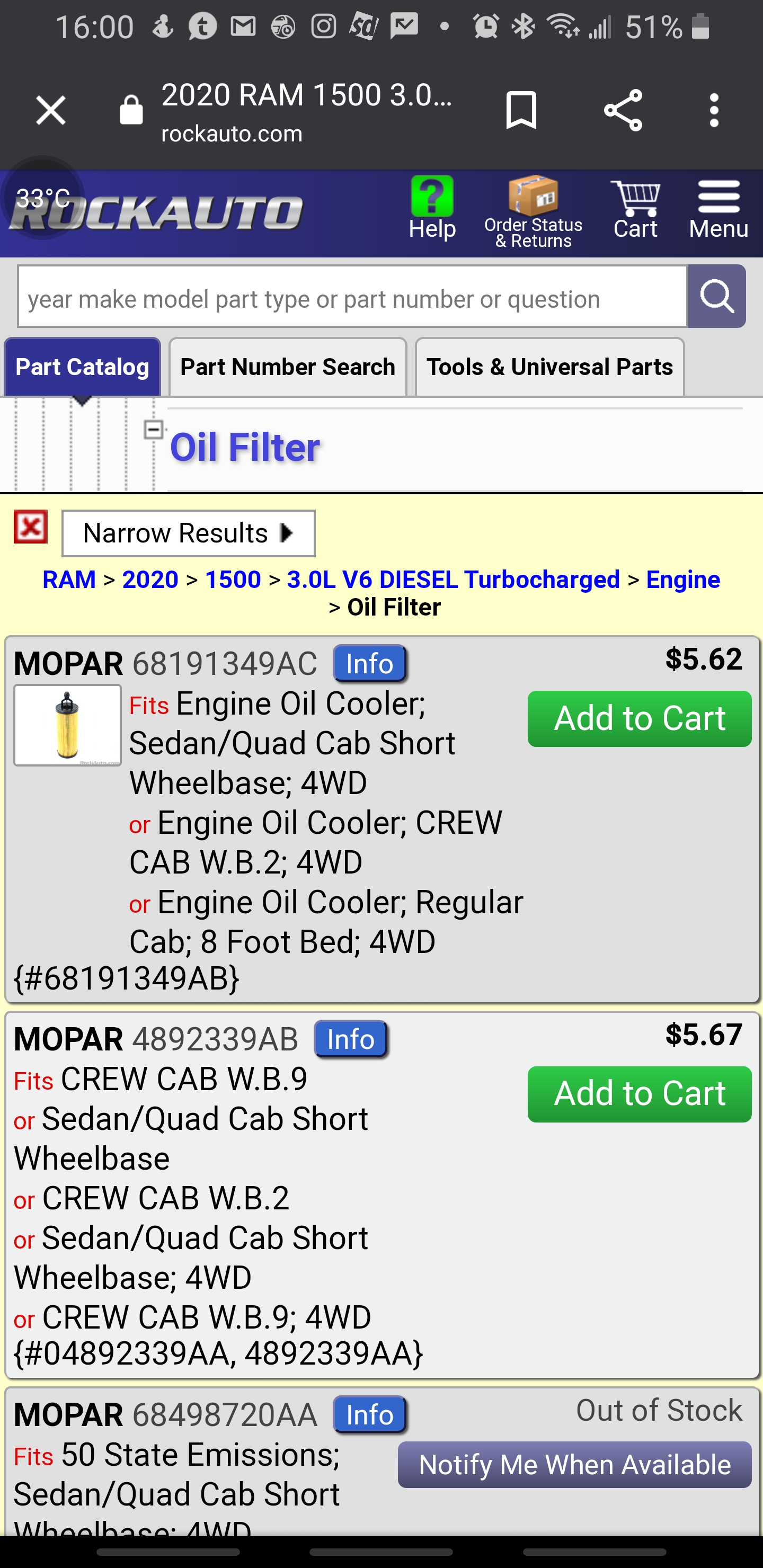

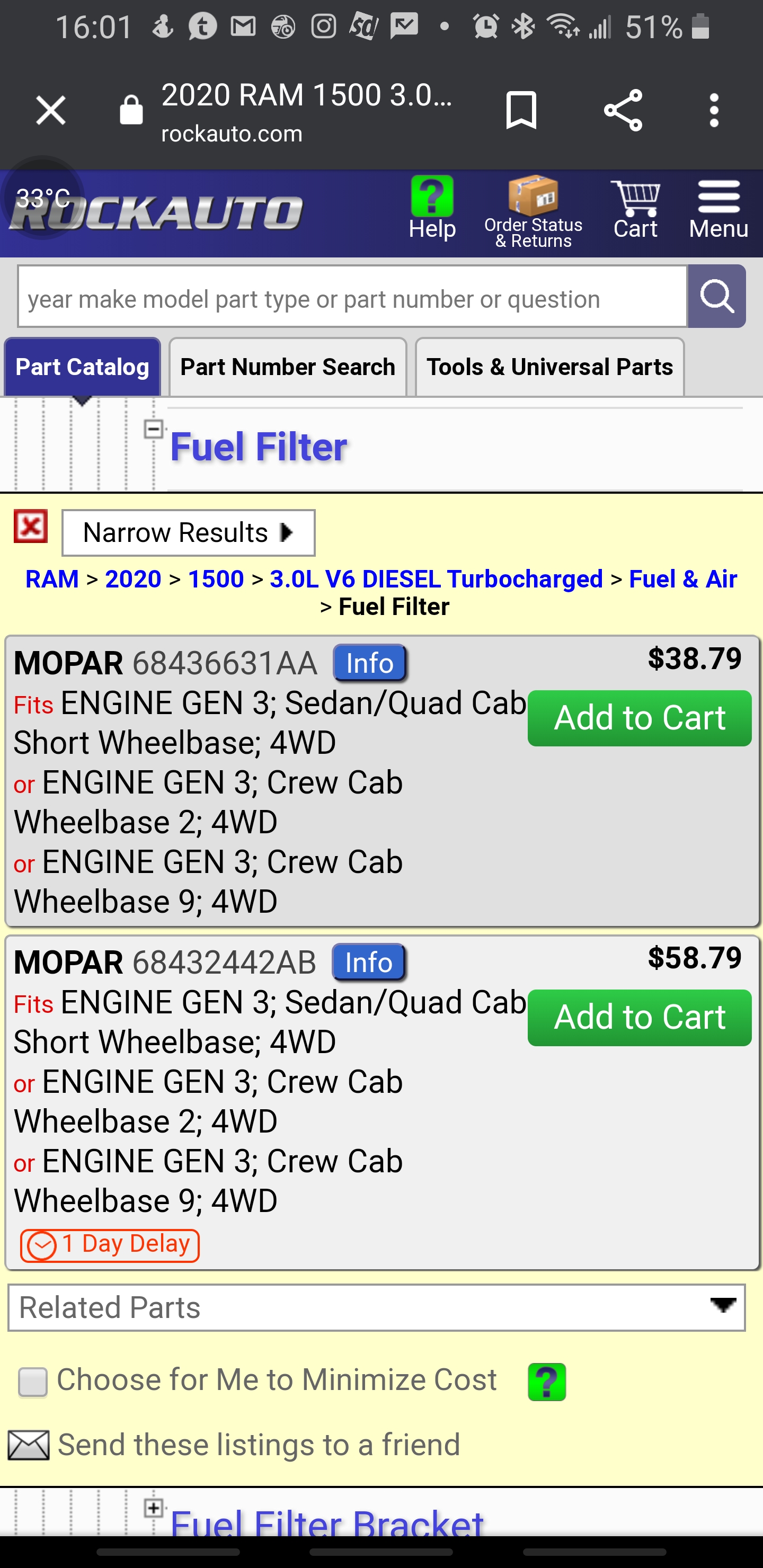

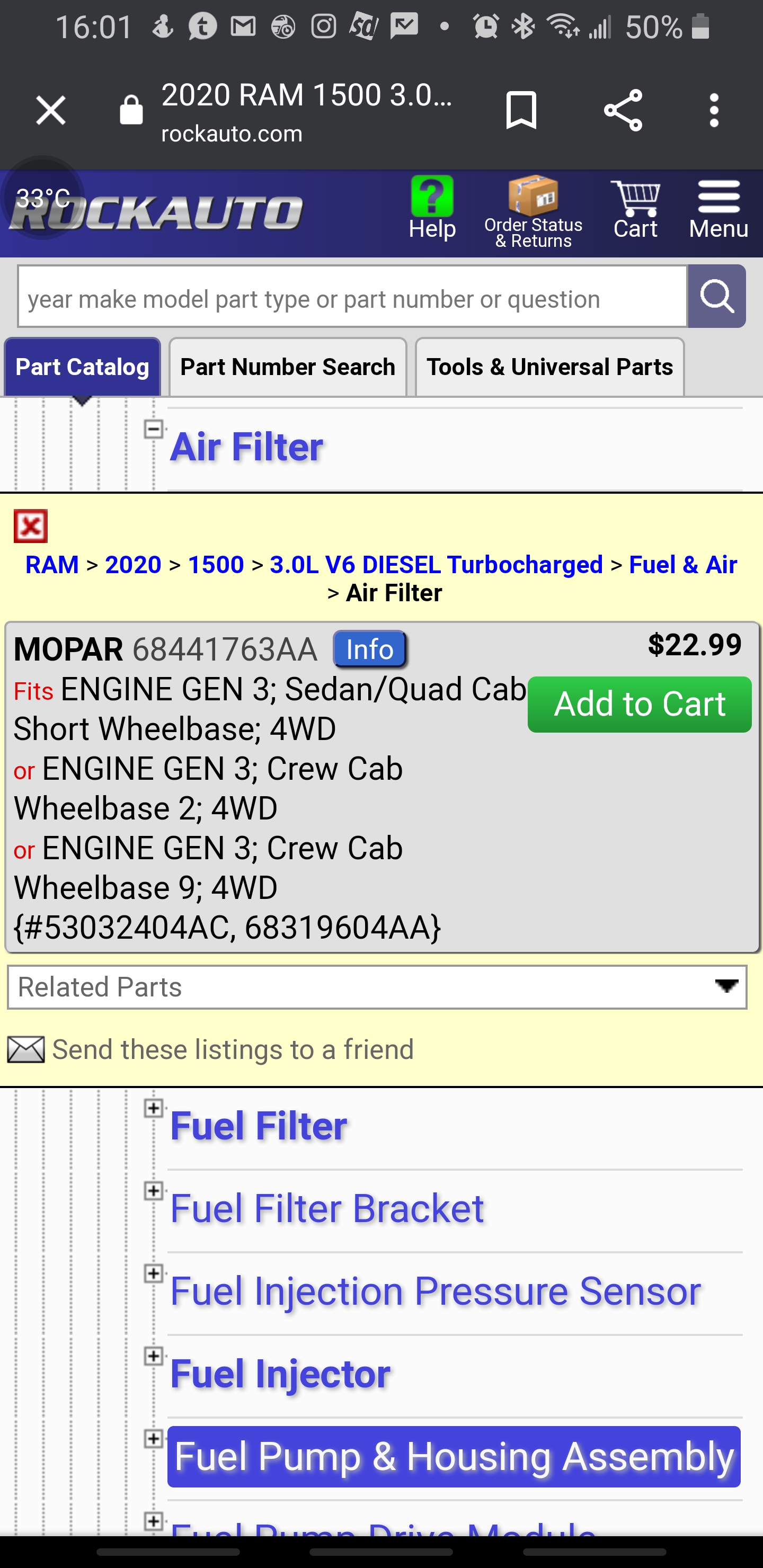

Kidder
Jul 29, 2018
393
237
DFW, TX
Do you care about gas mileage? Then get the EcoDiesel. Do you want to go fast? Then get the hemi. It's as simple as that. Either will to w that small of a trailer easily.
Ecodiesel is more expensive to maintain with its ridiculously expensive oil filters, oil, and then there is the fuel filter(s) and DEF.

I beg to differ. The EcoDiesel only calls for an oil change every 15,000 mi. With the savings in fuel mileage, it comes out even with, if not ahead of, the hemi. BTW, I have owned both, and currently work for FCA.
J-Cooz
Jun 28, 2019
966
738
If he's getting a better deal on the diesel and with the fuel savings it will more than pay for itself.
Deezl
Aug 26, 2019
64
54
Spot on. Just drive both, and get whichever you like best. You really can't go wrong with either.
Deezl
Aug 26, 2019
64
54
Oil, fuel, and air filters.
