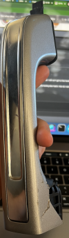

In the rare case that someone else experiences an excessive amount of downwards force on their 5th gen door handle... you may anticipate this to be the break point as it is not very strong plastic.
The below image points to two points that are connected by a 90 degree piece of plastic which allows your outside handle to lever against the door cable. I think that replacing part #6 from the diagram will do the trick.
Thanks again @MannyN for your superior ability to navigate these forums and get me the info i needed!
