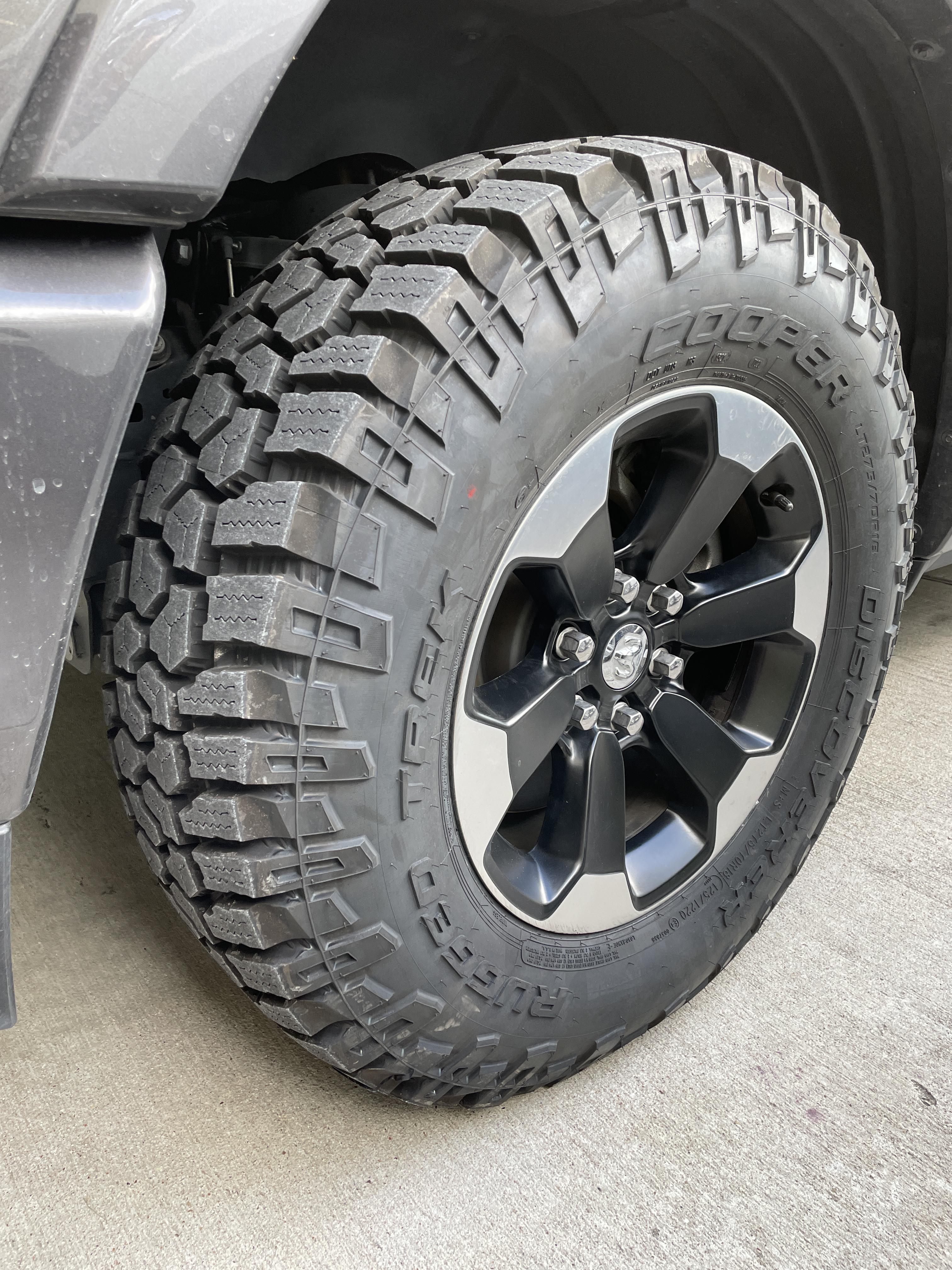

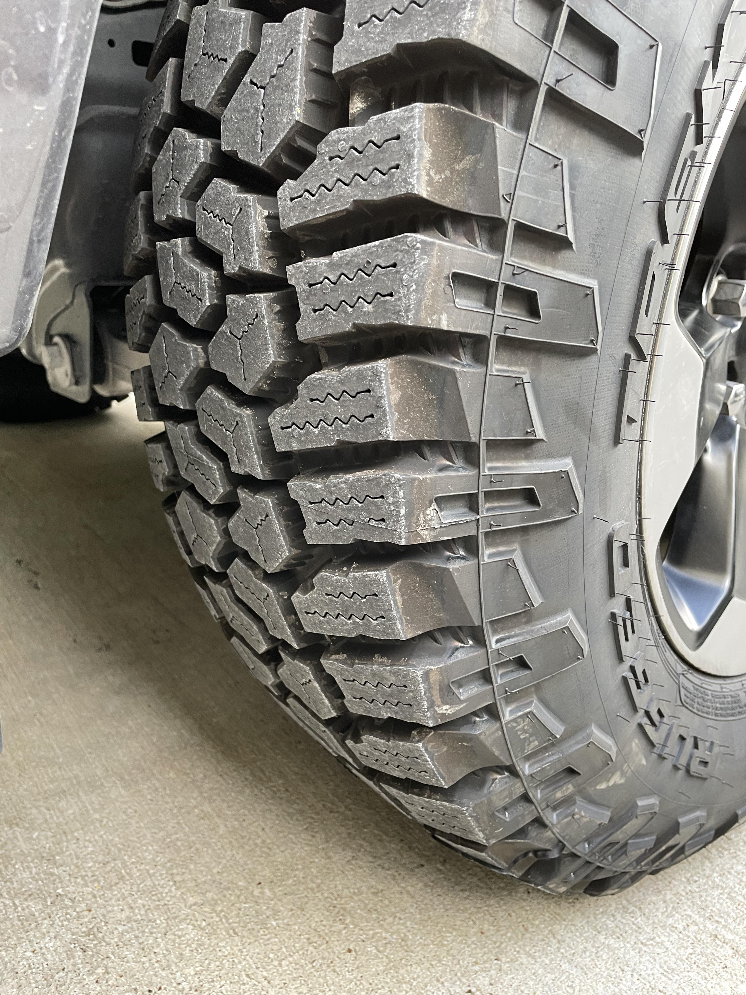

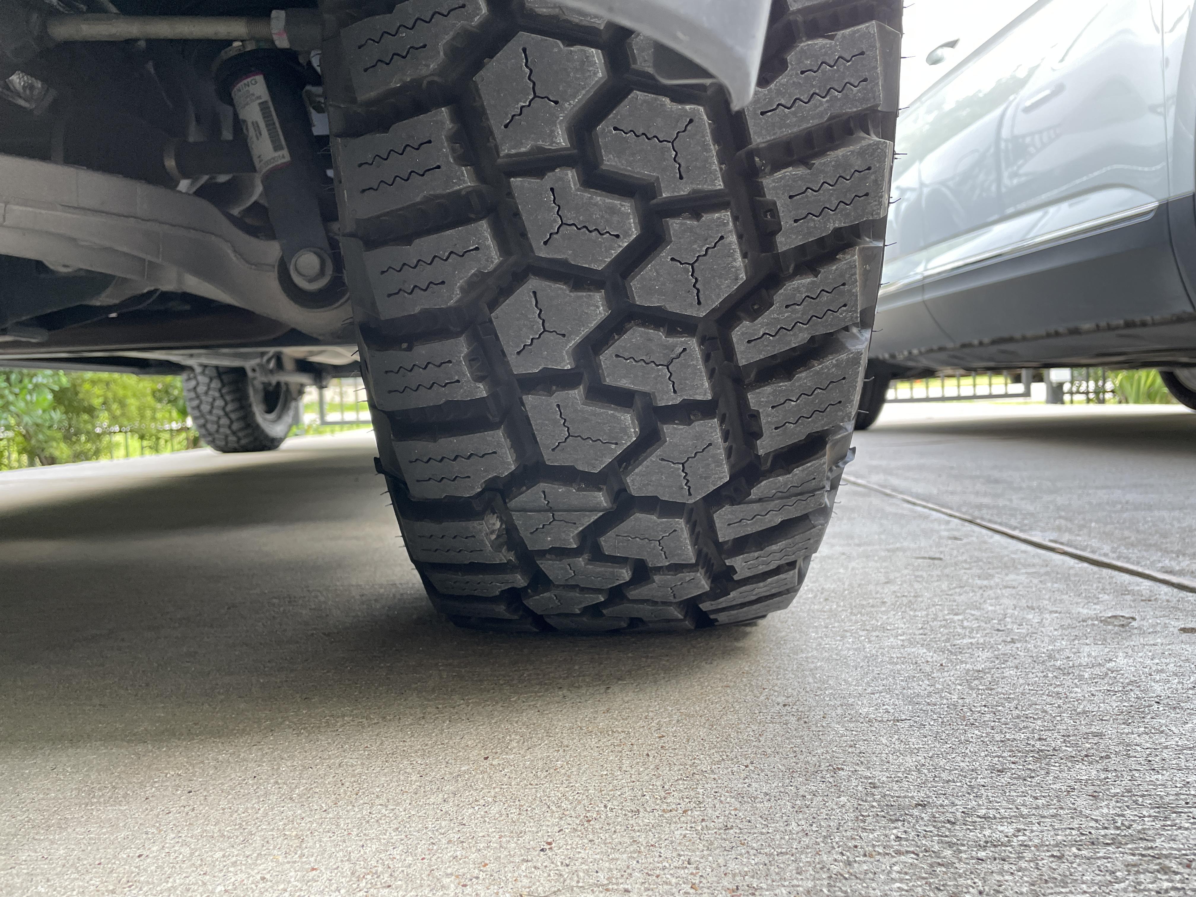

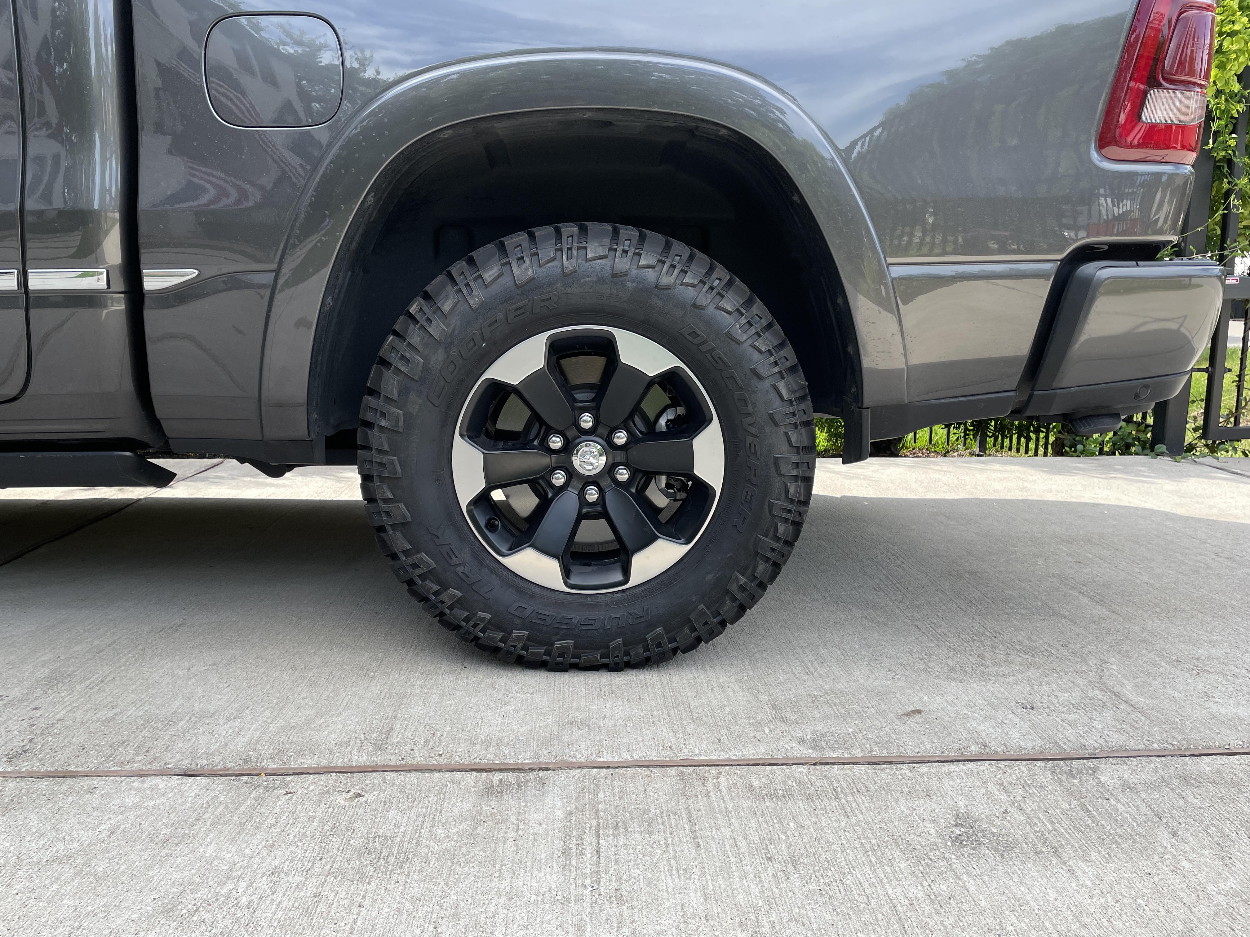

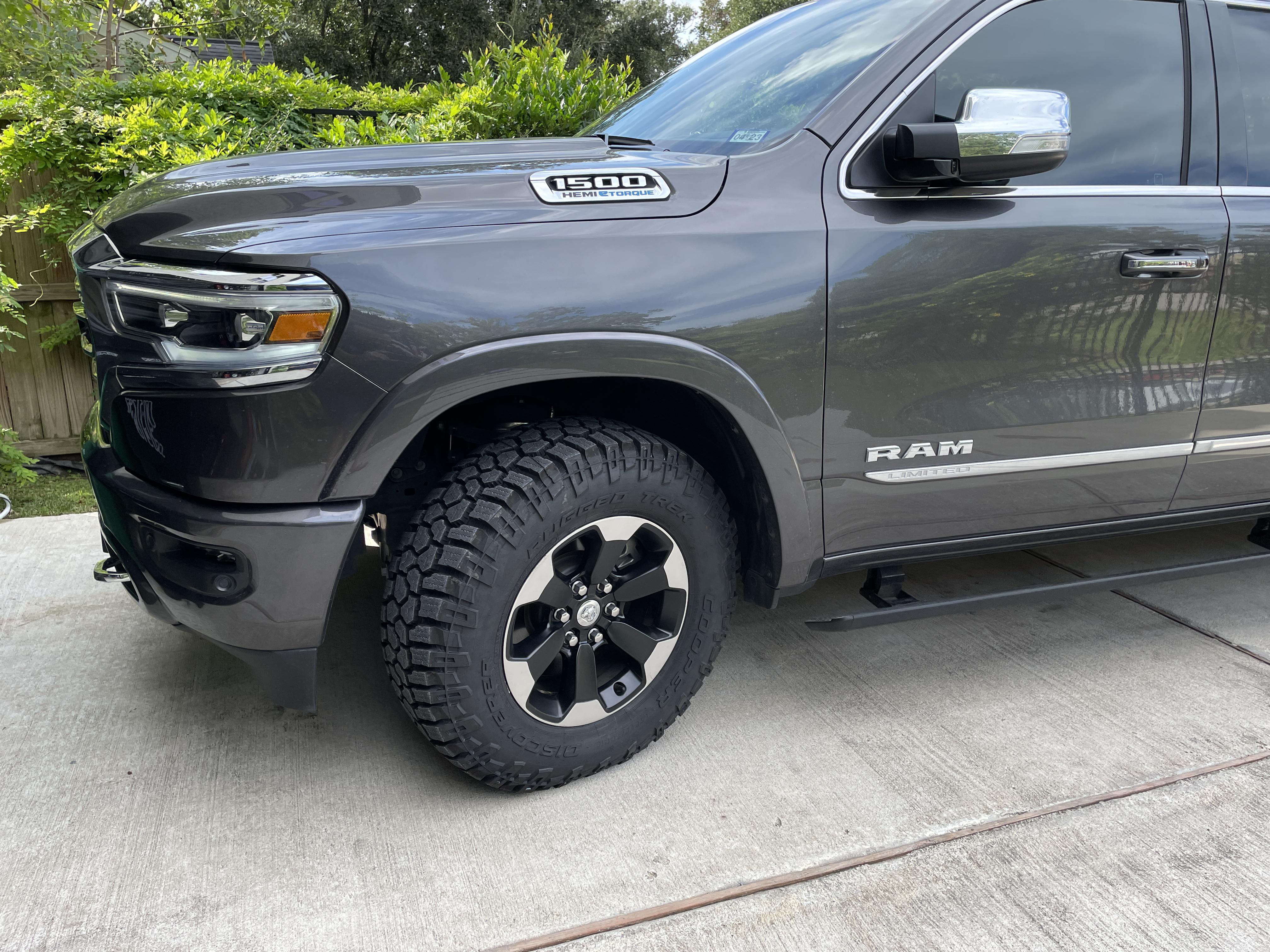

That's a great looking tire... very similar to the Ridge Grapplers sidewall. Are they heavy? I looked at Cooper's website and they don't list weights.Just to update, installed some lovely Cooper Discoverer RT 275/70R18 on the set of Rebel 18s
Love them both so far!

hows the clearance, could you have gone 34sJust to update, installed some lovely Cooper Discoverer RT 275/70R18 on the set of Rebel 18s
