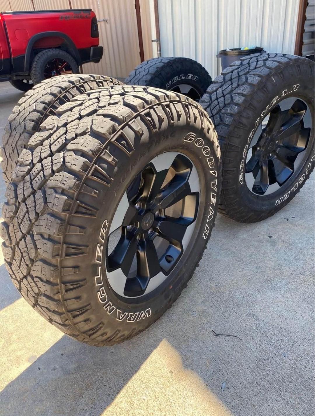

Just bought a set of Rebel wheels with the oem goodyear AT tires for $500, local pickup. Perfect condition.
Still need to find what tire size I can fit on the stock Limited air suspension

Picked them up today. Two of the four tires need immediate replacing so was thinking just move up size now.
What is the max size that I can I run without modification on stock limited air suspension on these 18s??

Oh nice! Love that look on your truck. Yeah 33's look like the winner on stock suspension height. These Rebel wheels have 275/70R18's on them, which is like 31.2". So going up a couple ticks will look nice and beefy!

The ones i bought had like 20-25k miles on them and tread on 2/4 is gone. They do have TPMS as well though. FYI
