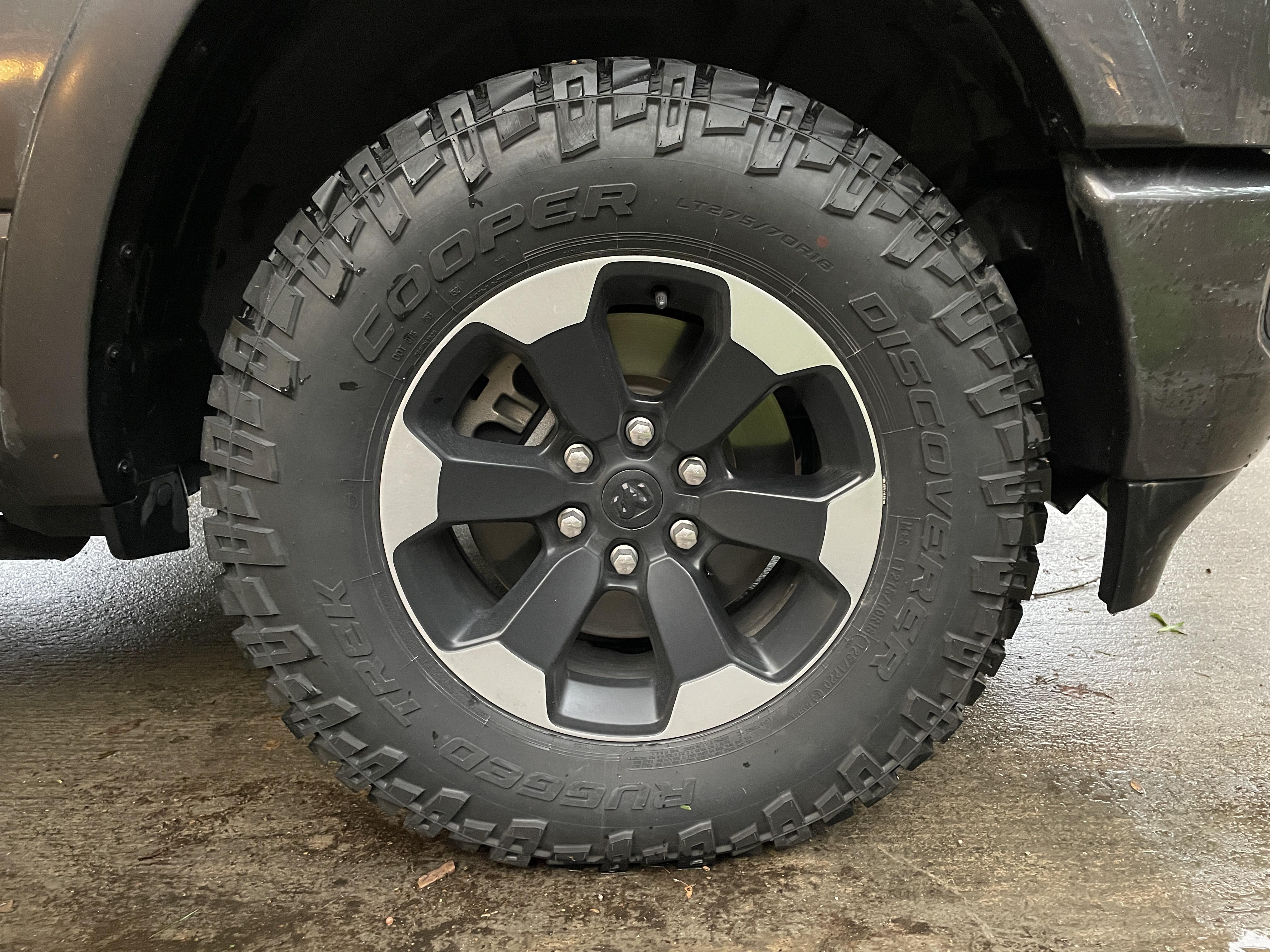

I ordered the same size as you 33's. I ended up going with the 275/70R18 Cooper Discoverer Rugged Trek. (https://coopertire.com/en-us/find-tires/all-tires/discoverer-rugged-trek)
You can shave off the rough casting of the front calipers with a grinder and then any 18” wheel with sticky weights will fit. There is plenty of meat on those calipers

Just to update, installed some lovely Cooper Discoverer RT 275/70R18 on the set of Rebel 18s
Love them both so far!
