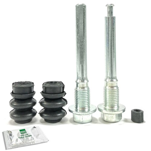

Everyone is using the word "Bolt" I imagine we're all referring to the caliper slide pins?
Yea, I've never replaced one of those. I usually try to replace the boot/rubber, if it comes in the kit, but not the pins.
99% of the time, I completely wipe away all the old grease from the pins, and I try to remove some of the old grease from the boots/hole.
Putting it back together, I will lightly pack the boot with fresh grease, then I'll put a nice long bead along the length of the bolt.

Only times I've replaced the caliper slide pins is when they have corroded on older cars due to poor maintenance of keeping the greased.
I reuse the bolts and put some red lock tight on them
