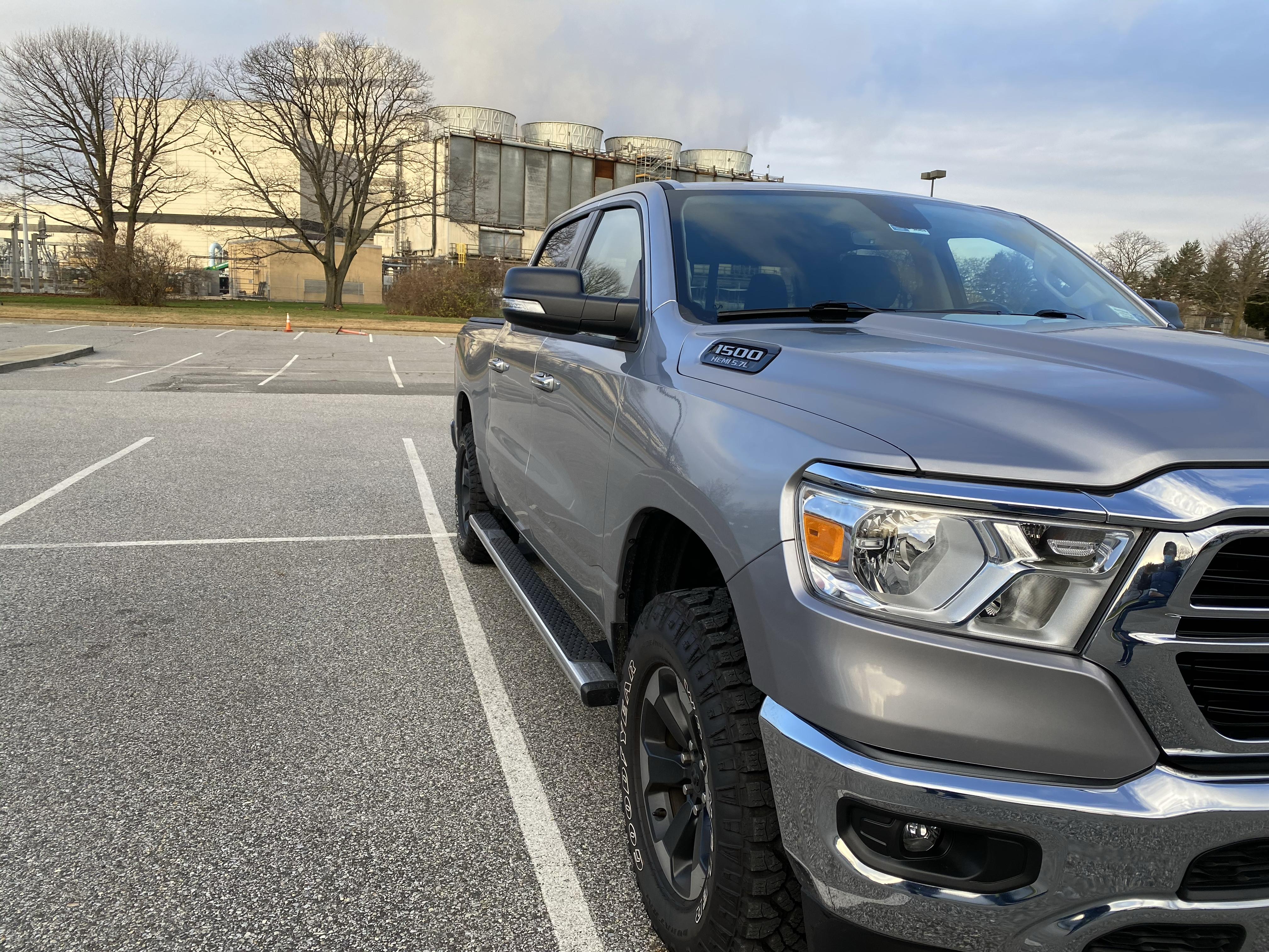

Sep 1, 2019
16
17
Yellowknife,NT
I used fishing line to cut the foam behind the Ram, Hemi, 4x4, etc. then a eraser wheel on a drill, then goo gone. I love the clean look. When I bought my 09 Ram I took off the dealer advertising at the dealership with an eraser wheel I had in my other truck. The Salesguy was like "wtf are you doing?" I said I just gave you $39k you want me to advertise for you too?

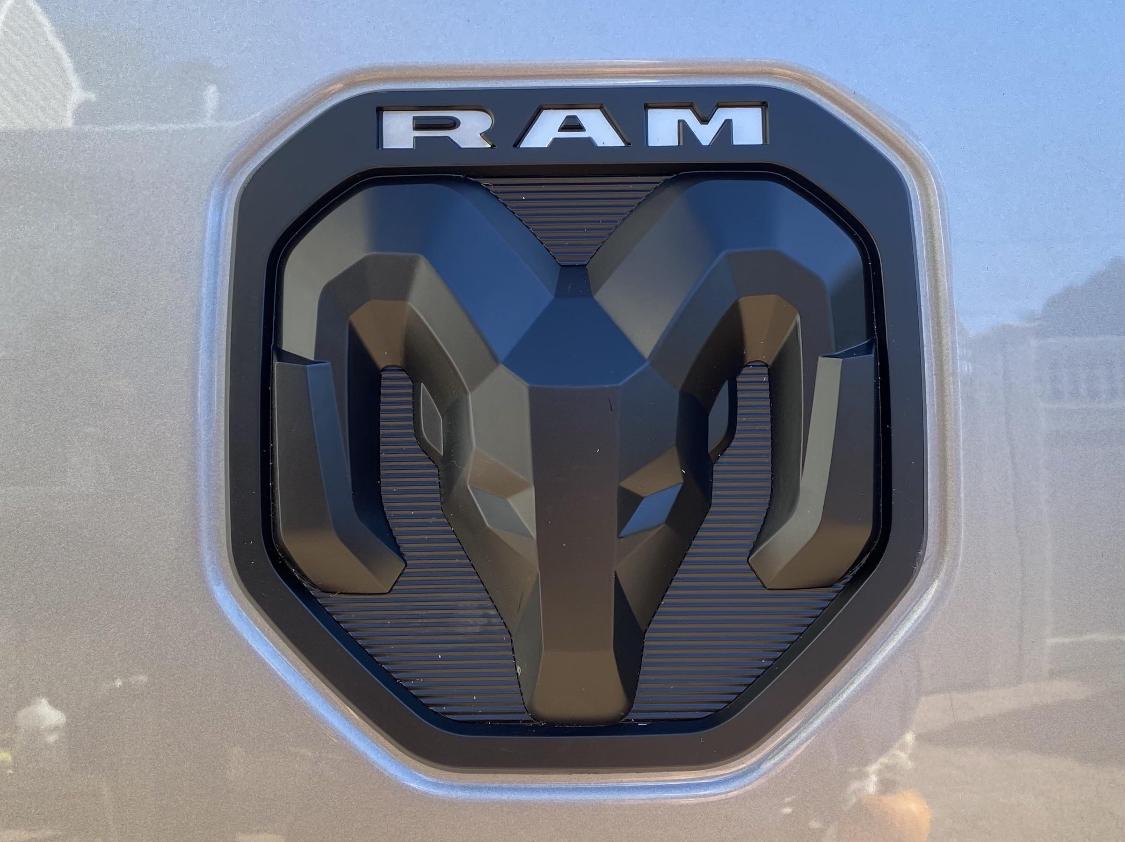

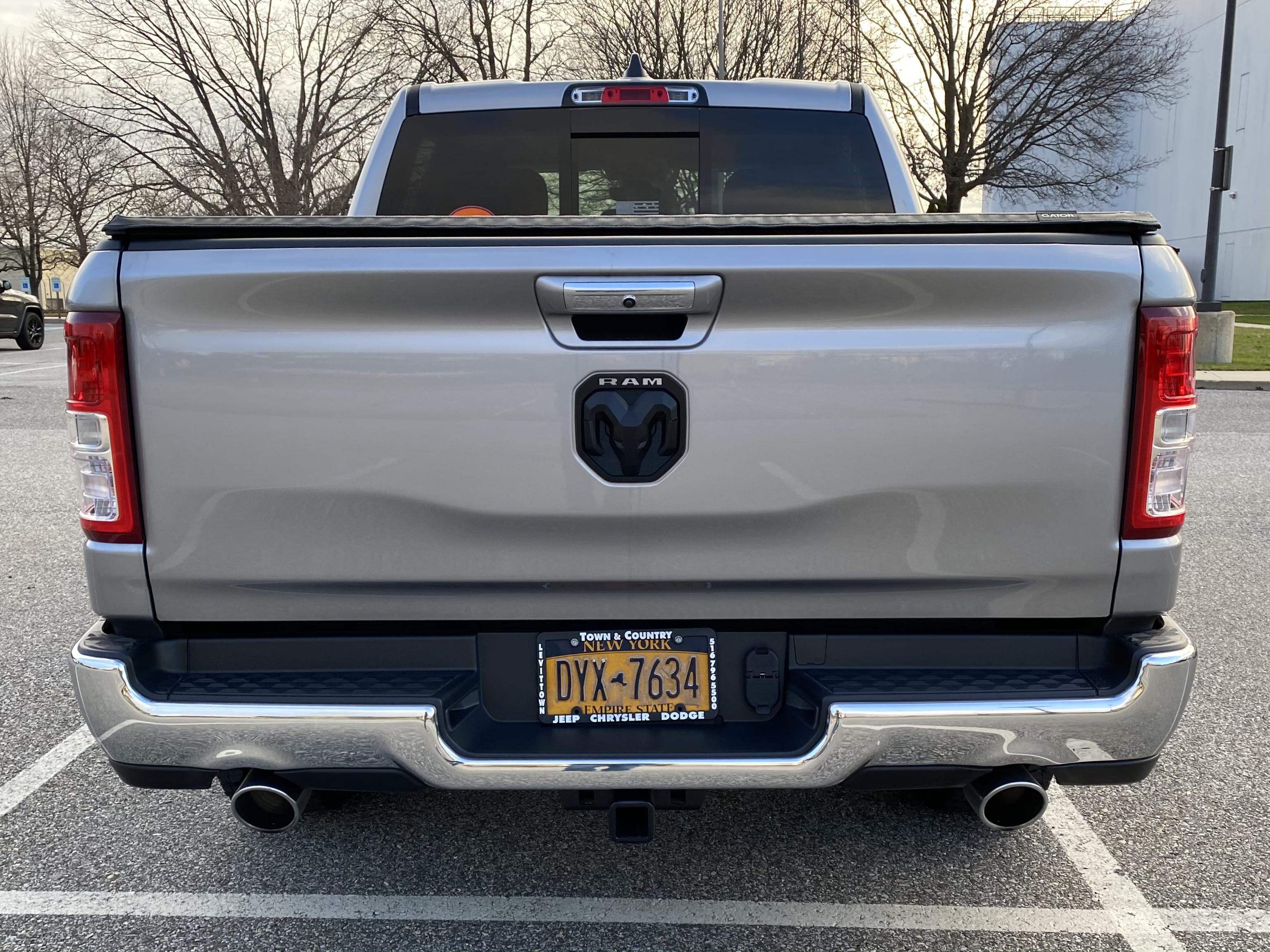

I bought the MOPAR black hood and tailgate badges (removed all others) and then added vinyl overlays from reflective concepts. You can also pay out the *** for custom painted ones.

It’s just the MOPAR black hood and tailgate emblems. Lettering I did myself. I used the vinyl over lays from Reflective concepts to do the lettering. Was definitely a tedious process but the end result was well worth it in my opinion.

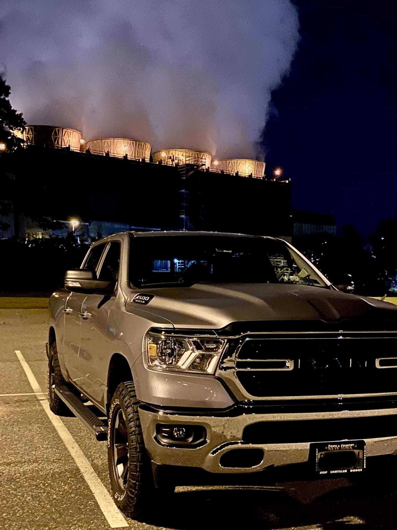

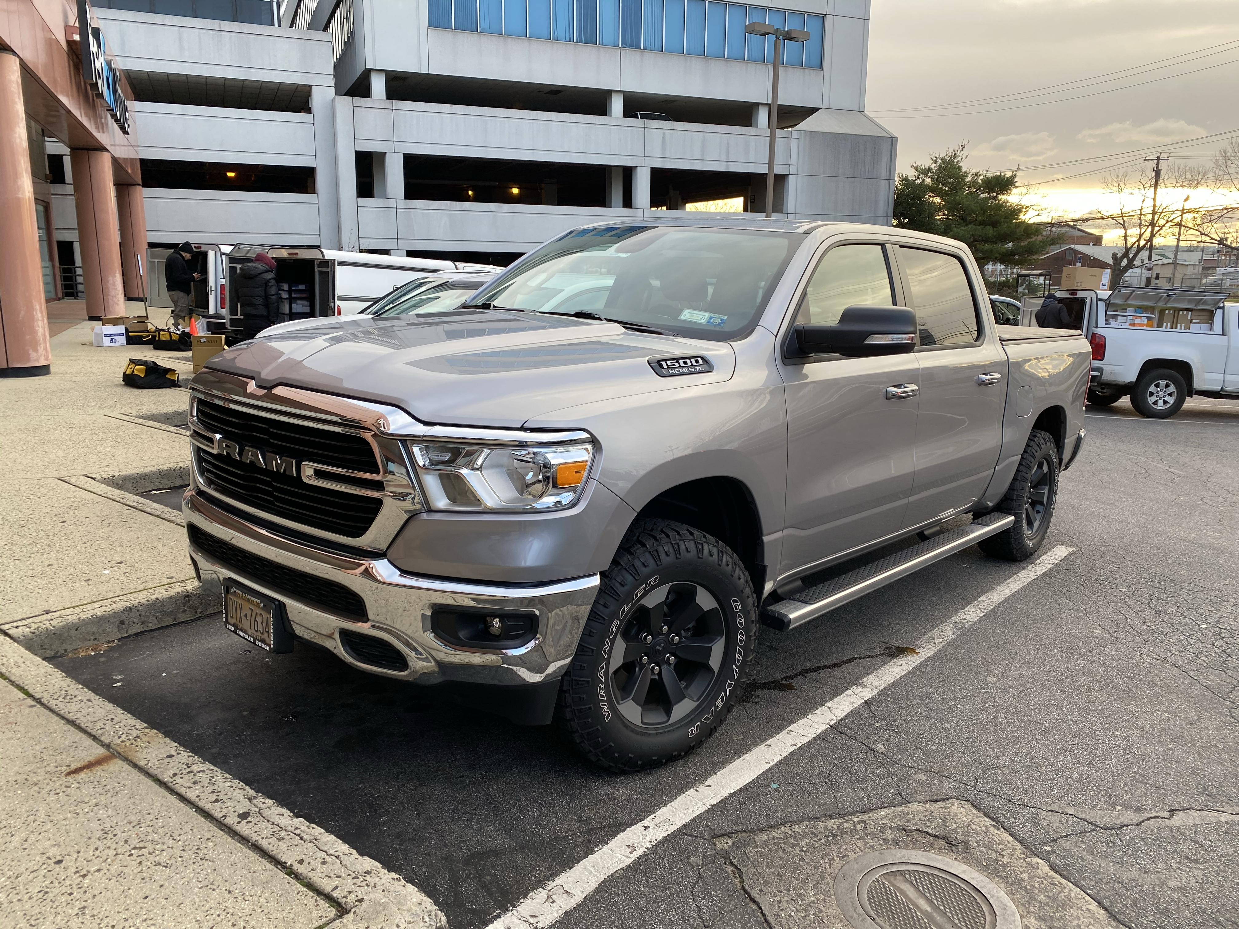

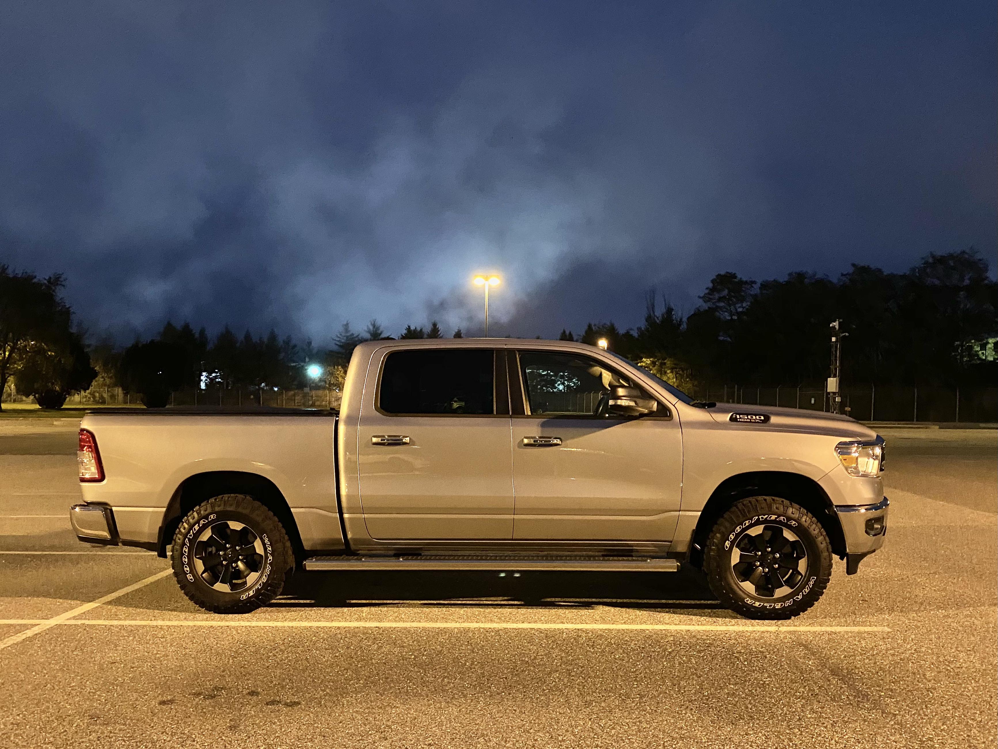

The color I ordered was the non-reflective silver-grey. And that was from Reflective Concepts.
Here’s a few other shots from further back...
