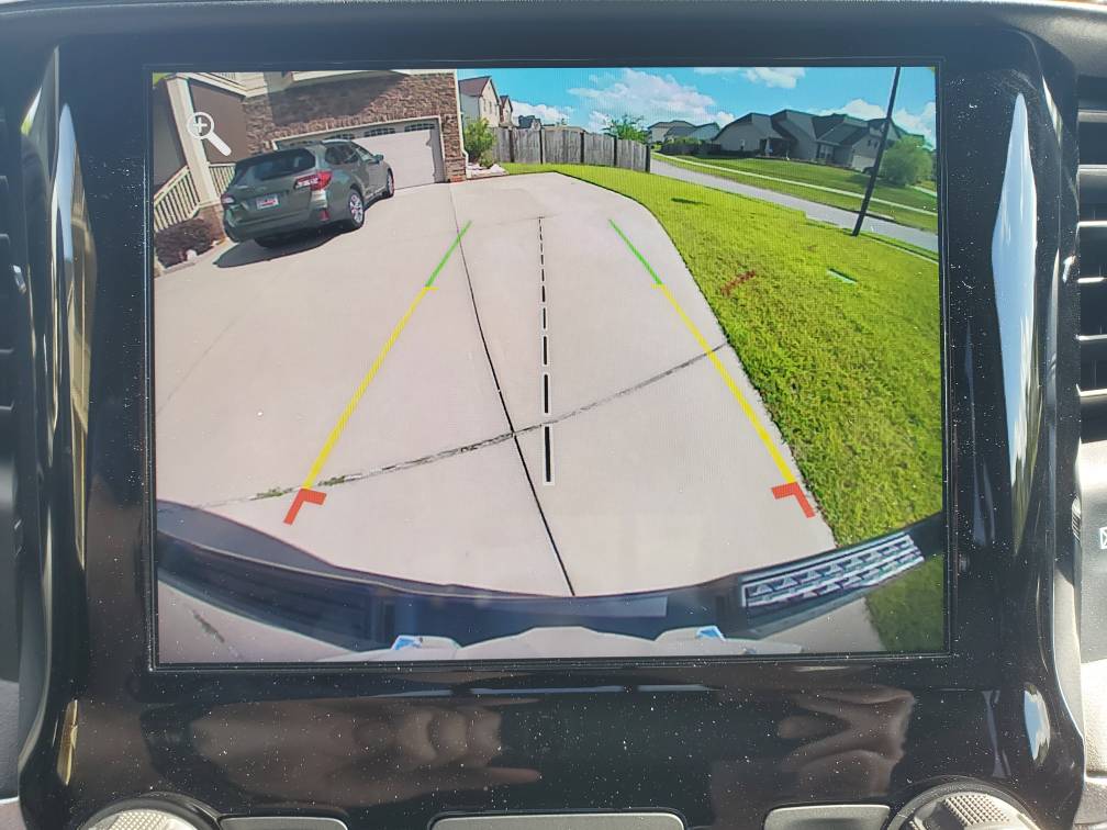

So, I just experienced the worst Fake BRAKE! so far, while backing into my driveway this afternoon. It stopped me twice.
The curb wasn't the issue.
I just deactivated the braking portion in the settings.
