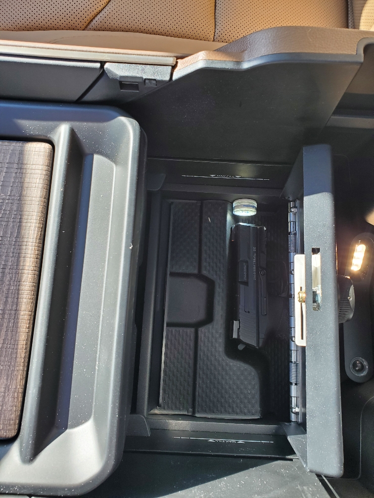

Here you can see a Glock 19 for scale. It’s plenty spacious enough to toss in a couple more full size handguns or anything else you might want to lock up. It still has the factory mat underneath. The spring loaded hinge lifts and holds the lid out of the way.
Also visible are two of the four screws. I was pleasantly surprised that there weren’t just screw holes but actual threaded inserts welded to the inside vault walls. This made installing the screws incredibly easy and kept them exactly perpendicular to the wall. Additionally, this virtually eliminates any chance of being able to lift the whole vault out of the console without removing the screws. There’s no way for the screws to pivot and pull out of the plastic of the console. The screws would either need to shear off outside the vault or cut four paths through the console all the of the way out. In my opinion it’s just a small detail that could have easily been omitted but instead speaks to the build quality.
On the subject of build quality, the lid is well-designed and fits tight enough to the frame that a pry tool can’t be inserted. I’m sure a tool could be hammered in but the shape of the lid would result in more lateral pry force than the vertical direction needed to pry the lid up. On the front side of the vault where the lid closes and latches, there’s a lip that would limit the depth a tool could be inserted and would also resist the edge of the lid being folded in to create an area a pry tool could hook onto and lift from.

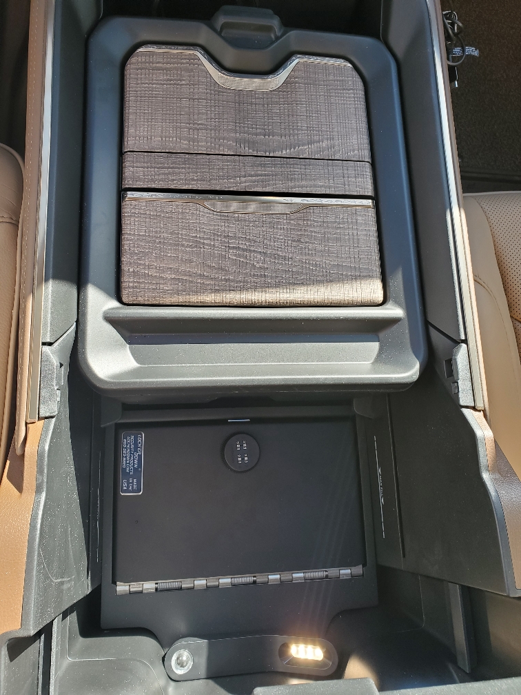

Overall I'm very pleased with my Console Vault. Shipping was fast and instillation was pretty straight forward. I spray painted the mounting bolts black to match the interior.
I went with the 3 digit lock since it looked easier to unlock in an emergency situation. Fits my compact perfectly with room for extra ammo!

Hey just so you guys know, you will lose the option of sliding the try all the way back with this company. Lockr down has a version where it sits low enough so you can still slide the tray all the way back. This pertains to the Limited like i have.
they now have a limited/longhorn version that allows it to slide all the way back now.
