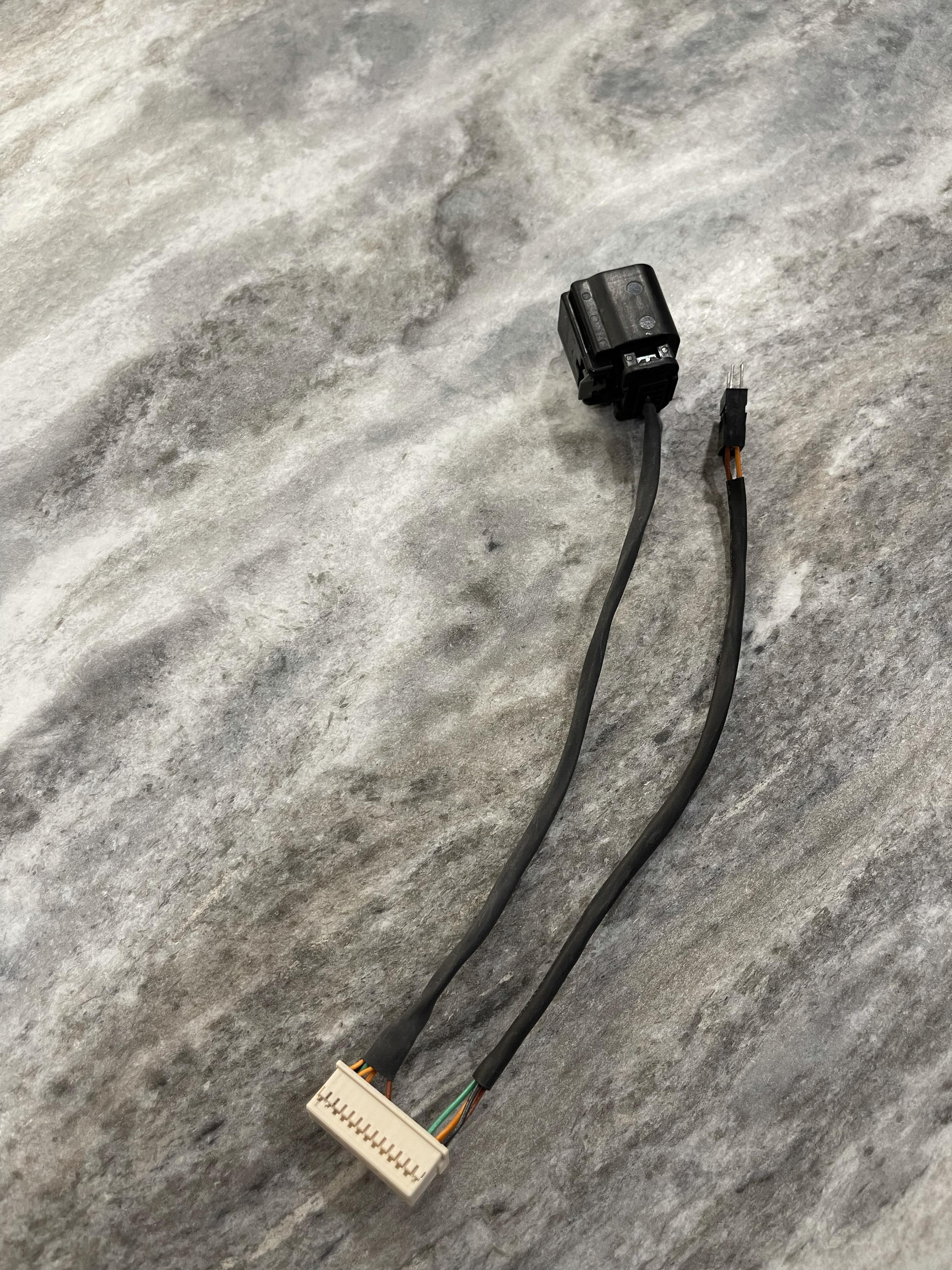

Last three Harnesses went out today at Lunch.

I just finished a batch of 10 Harnesses. 8 have already been spoken for on the Discord Server. I could make
a second batch if there is demand for them. So there are still two up for grabs.
