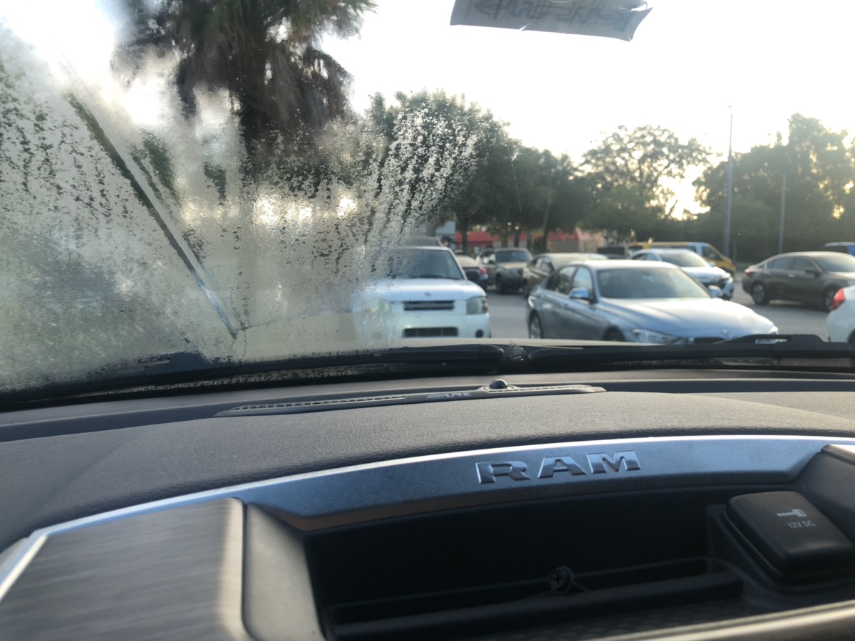

Mine is also minor compared to that. I would be leaving at dealer until fixed if mine looked like that. Easy tom say from my vantage point!! Sorry you are having this issue. I live in Orlando with most humid weather imaginable.same here. Took a pic this am. Glad to see I’m not the only one. Dealer said they could not reproduce. Will be adding my vin to the list. Thanks![]()
Yes, but not normal dew. This complaint is for the air blowing out of the defrost vent and creating a visibility problem. What I posted in my video is after the morning dew has cleared using the defrost the way it was designed. After that I turned the ac back on to get the cabin comfortable for me. The issue is not being able to stop the flow of air out of the defrost ventJust to be clear - moisture is on the out side correct ? I have this and had to run the wipers on a clear NC day for 20 minutes yesterday
This would work but the "fog" is not on the inside. It is on the outside.Those pics are crazy. My truck would have a very short ownership if it did anything like that. Hope they resolve this for you guys. Maybe
this stuff would work. Never tried it, but those pics look like a major safety issue if sun were to shine directly in.
The only way it will get fixed is to drive it to the dealer WHILE IT IS FOGGING the window so they can’t say “we can’t duplicate the issue “
This is what mine does when it starts cooling down in the evening. Of course nobody cared and I eventually reached buyback for other reasons. View attachment 36126

That's hard to do when the hours of them being open sucks. But as @poma31 has done, it dosen't matter, they know what is happening and just do not have a fix. So with no fix they prefer to BS the owners and force them to waste their time driving around making them reproduce the problem. I can easily reproduce the issue without waiting for it to fog up. Basically, when in vent mode there should be no air coming out of the defrost, that's all. If they stop the air from coming out it will solve the fogging issue. Simple cause and effect, cause: conditioned air coming from the defrost... effect: windshield fogging resulting in poor visibility and increased chance of accidents and injuries.The only way it will get fixed is to drive it to the dealer WHILE IT IS FOGGING the window so they can’t say “we can’t duplicate the issue “
