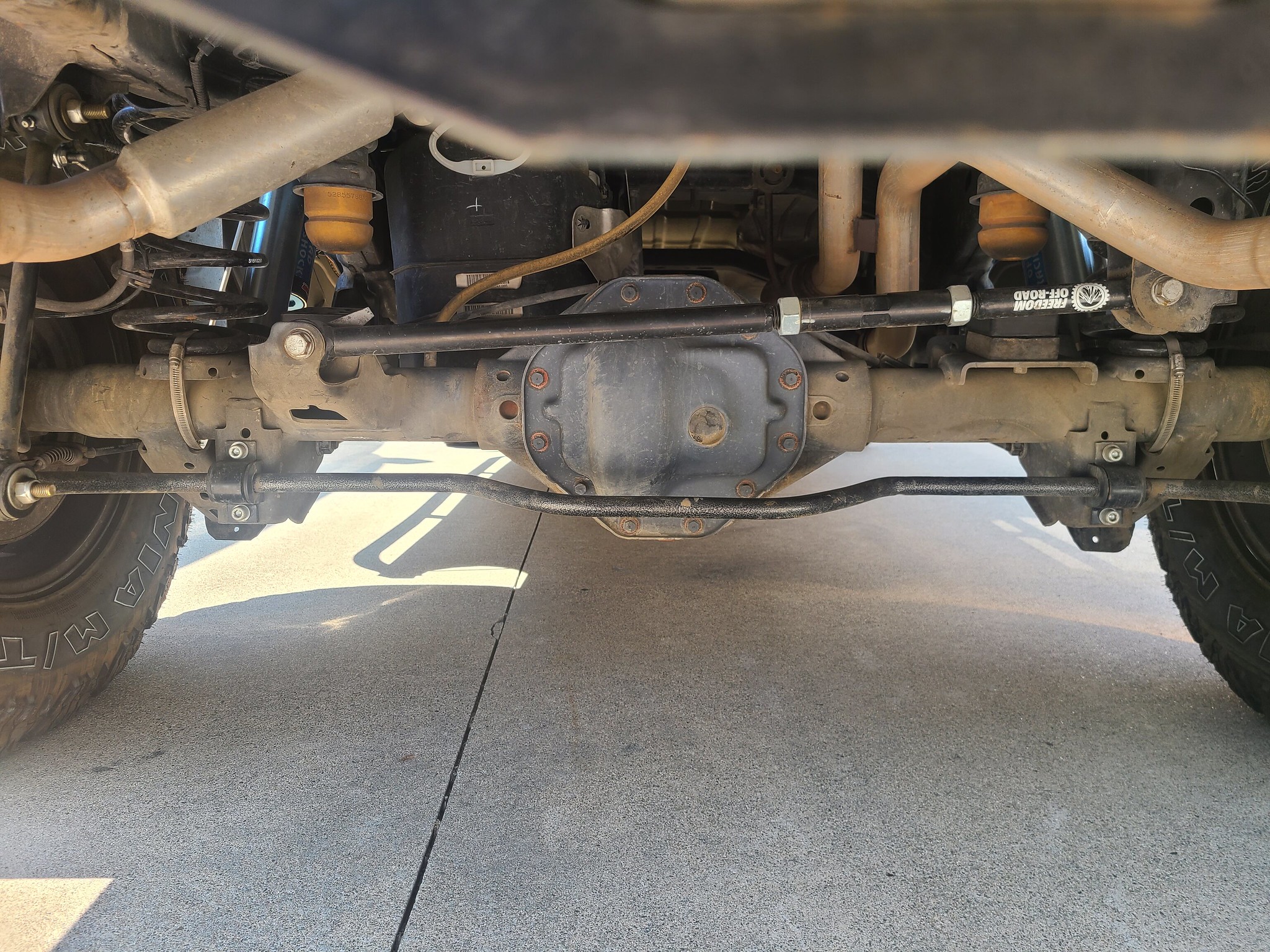

Also do you have pictures of how your rear trackbar angle looks like before/after the clayton springs ?
Awseome, Ty. So this the level with the panhard and your stock ORP springs ?
Can you do me a favor and snap one more pic similar to this to check how the panhard angle looks like after lift ? Carli offers a panhard relocation bracket for the 4th gen RAM but didn't address that on the 5th gen because they say is not needed in your application since in theory the angle is better when stock. I want to see what's different about the new truck rear panhard.

This is how mine looks like with the Clayton springs.

It looks like the 5th gen bracket on the driver side is taller. On ORP springs I'm getting 6.25 inches from the top of the sway bar to the bottom of the panhard bar, as measured closest to the driver side panhard bracket.
Here is another angle. My trackbar is pretty close to parallel with the ground. Honestly, the only think I need to replace now is my rear sway bar links. Everything else looks good to my untrained eye.

That's where i'll put a panhard relocation bracket if we had one for just 2" lift. On the axel side. That's why i haven't/didn't cared much for the Carli bracket. Glad to see how FCA addressed that in the new trucks. Thanks again for the pics. I'm learning a lot about the 5th gen suspension :)
