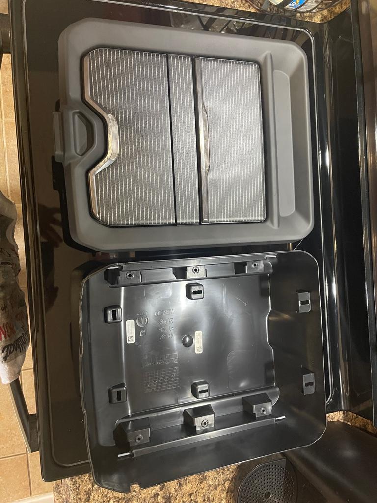

So, I had been eyeballing this as a possible modification for quite some time and was unsure if it was possible. I posed the question but no one really had an answer, so I just up and did it.
I swapped the sliding center console cupholder/tray compartment in my Rebel for a Limited compartment with the covers. I think it looks alot more finished, initially I intended to wrap the wood grain finish with something similar to a pattern inside the Rebel, but after installing it I'm going to leave it be. I think it meshes very well with the 12A black package.
Anyway, for those interested - The existing cupholder is removed by popping the front two retaining pins out from underneath the compartment. This is by far the hardest part. I used my phone reserve camera, light, and a set of needle nose pliers to push up (towards the roof) from underneath on the front two white retaining clips. From there I was able to grab the top portion of the tray and pull it up and out. From there its super easy, just unscrew the six screws and remove the bottom portion of the slider tray and pop in the new one.
Parts needed:
5YE132X7AGAccess Cover$496.0
6LY66TX7AARetainer-Floor Console$26.74
Overall, worth the mod I think. The replacement sliding compartment is crazy expensive in my opinion, worth 500 bucks ? That's up to you. I have my old one for sale if anyone is interested and needs a new one.

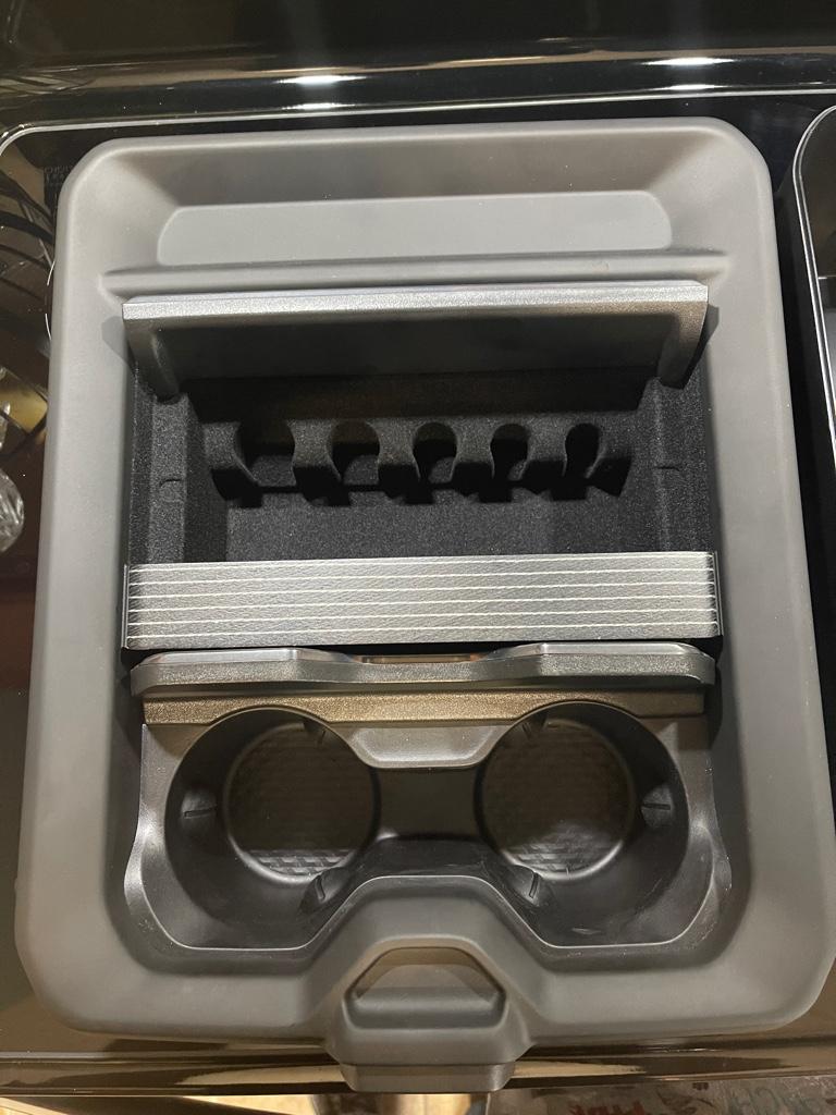

Here's my solution, for just the cost of a small board. Call it $5.

Posting this for anyone searching or reading this thread in the future. My console sliding had bubbling edges, so I've spent the last few weeks researching. Turns out, the console from older models does fit the 2022 at least (which is what I have). Part numbers are totally different, prices are staggeringly different ($130 for a 2021 console vs $600 for a 2022 console) but I can confirm the older console part number fits perfectly for a 2022. I received mine yesterday from MyMoparPart and it clipped it exactly how the old one did.
Part number I used is 5YE132X7AG ... and I purchased from here 5YE132X7AG - FCA Cupholder. Console. Trim: [no description | Libertyville IL
They did ask for my VIN to confirm fitment so I gave them a 2021 VIN and took the risk it may not fit, but as mentioned, perfectly replacement.
Off their website, it looks as though this part number is meant for 2019, 2020 and 2021.
