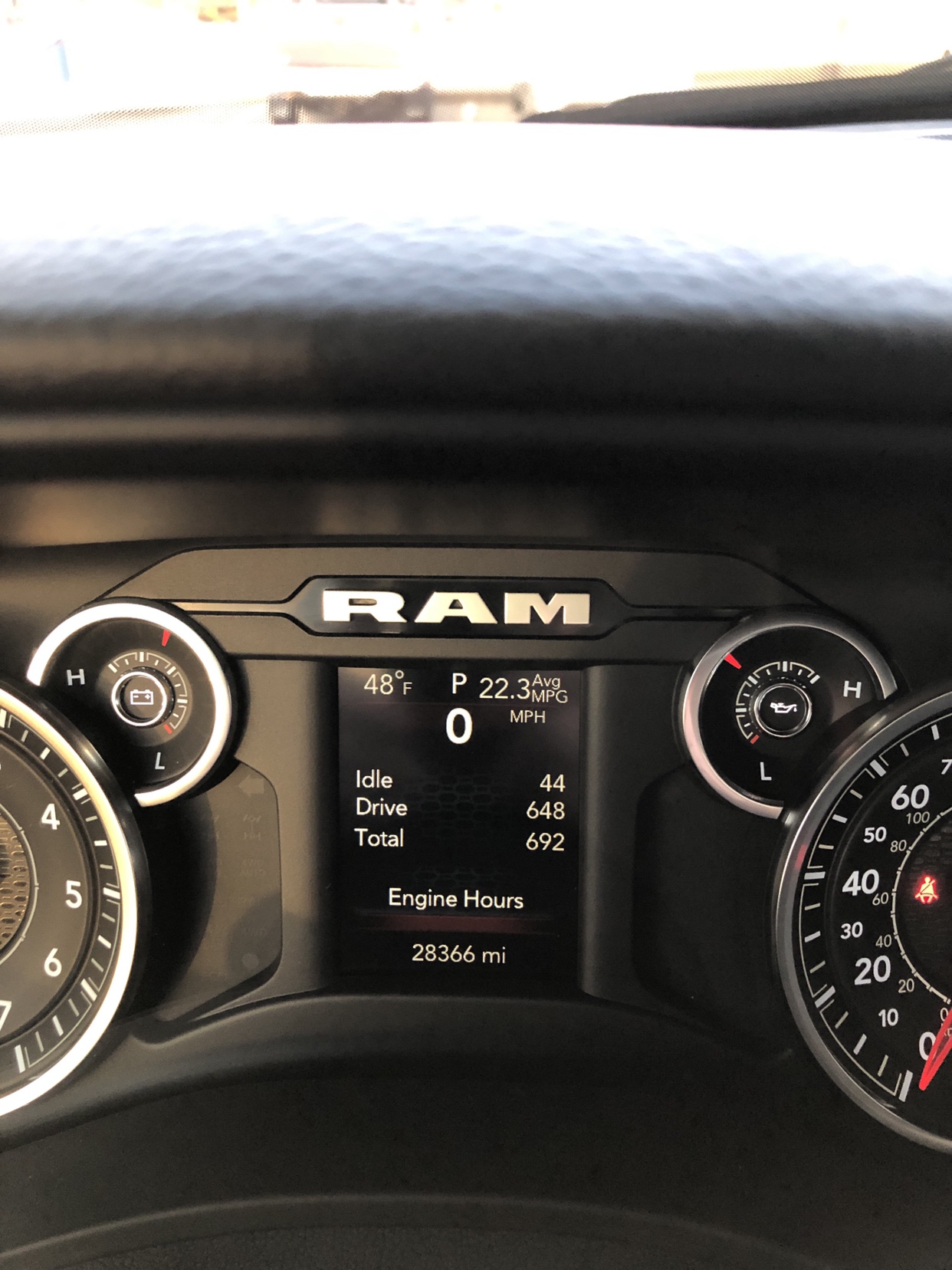

Here is the “mod” with a K&N drop in and a borla muffler swap. The EVIC was .2 mpg on the positive from hand calculation. This was done on 384 mile round trip. 3/4 highway and 1/4 roughly back roads
Just for info Bighorn 4x4 6’4” bed 3:21 gear stock Goodyear’s
Before this with just Borla installed was 19-20 average.
