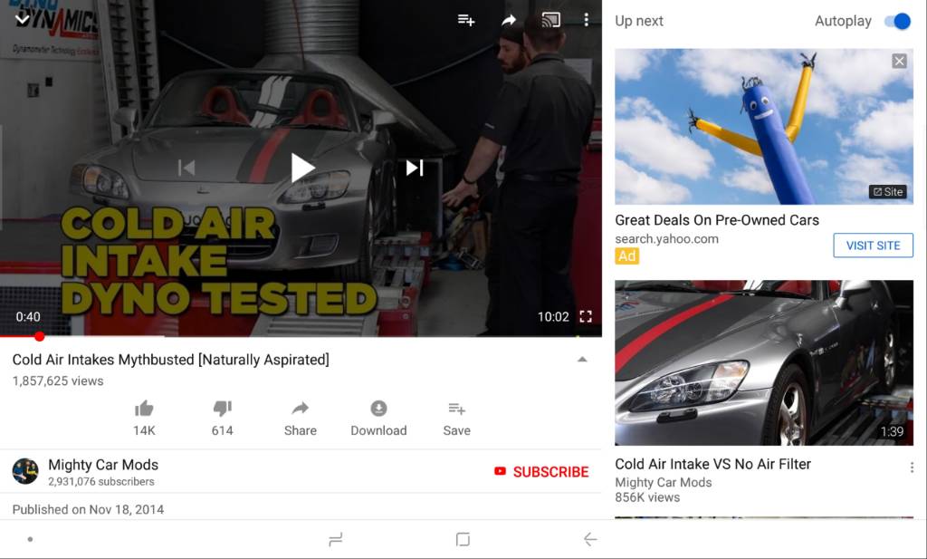

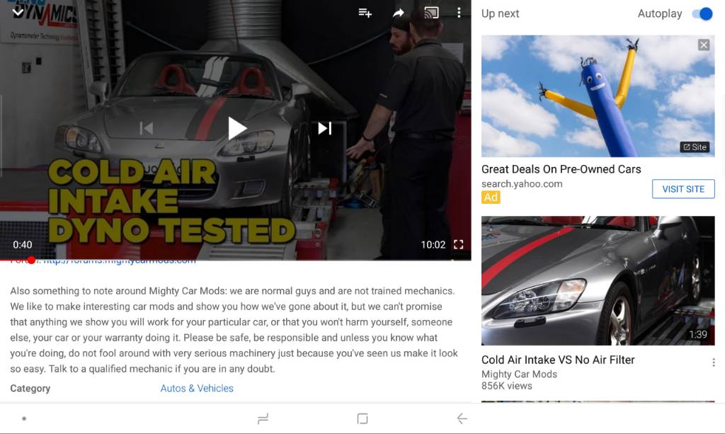

There is a YouTube video cold air intake myth busted. They dyno a stock Honda s2000 and it showed some gains. I tried to get the link but can't get the url.
I don't know if this will work
Thanks. I'll maybe try this and an AEM or aFe dry filter. The AEM is $30 cheaper....
