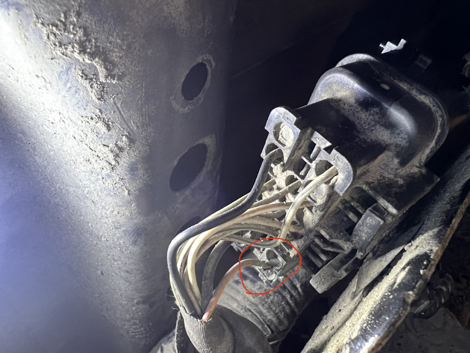

Here's my story. I also noticed a few more wires that are stressed.
