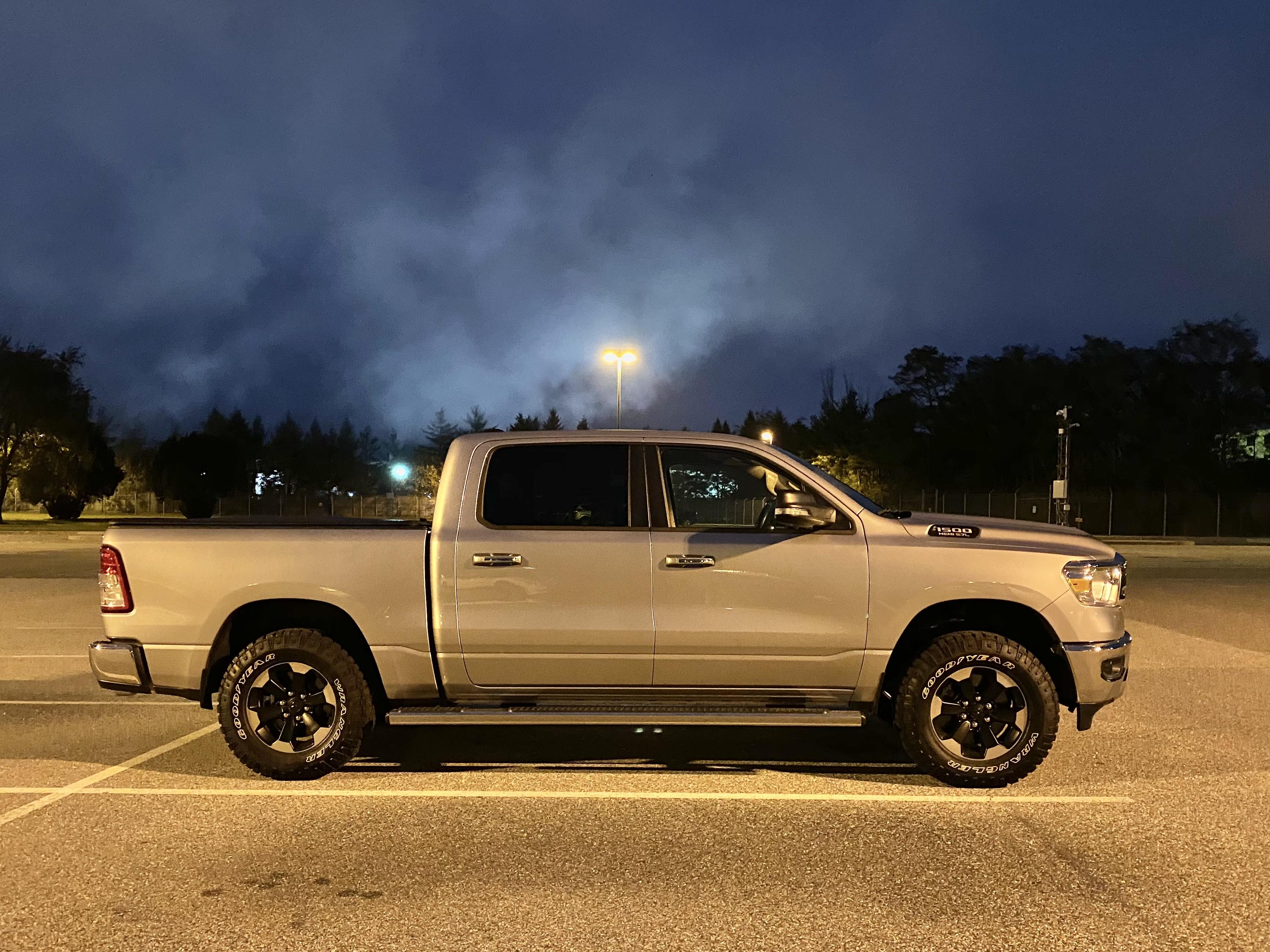

Mine is setting 4, but with ORP springs and 33.5” duratracs if this helps at all. View attachment 71575
So you've got 5100's in the front on setting 4, front and rear ORP springs and no modifications to the rear suspension?

This is the side view of mine on duratrac 33’s sitting bilstein setting #5
