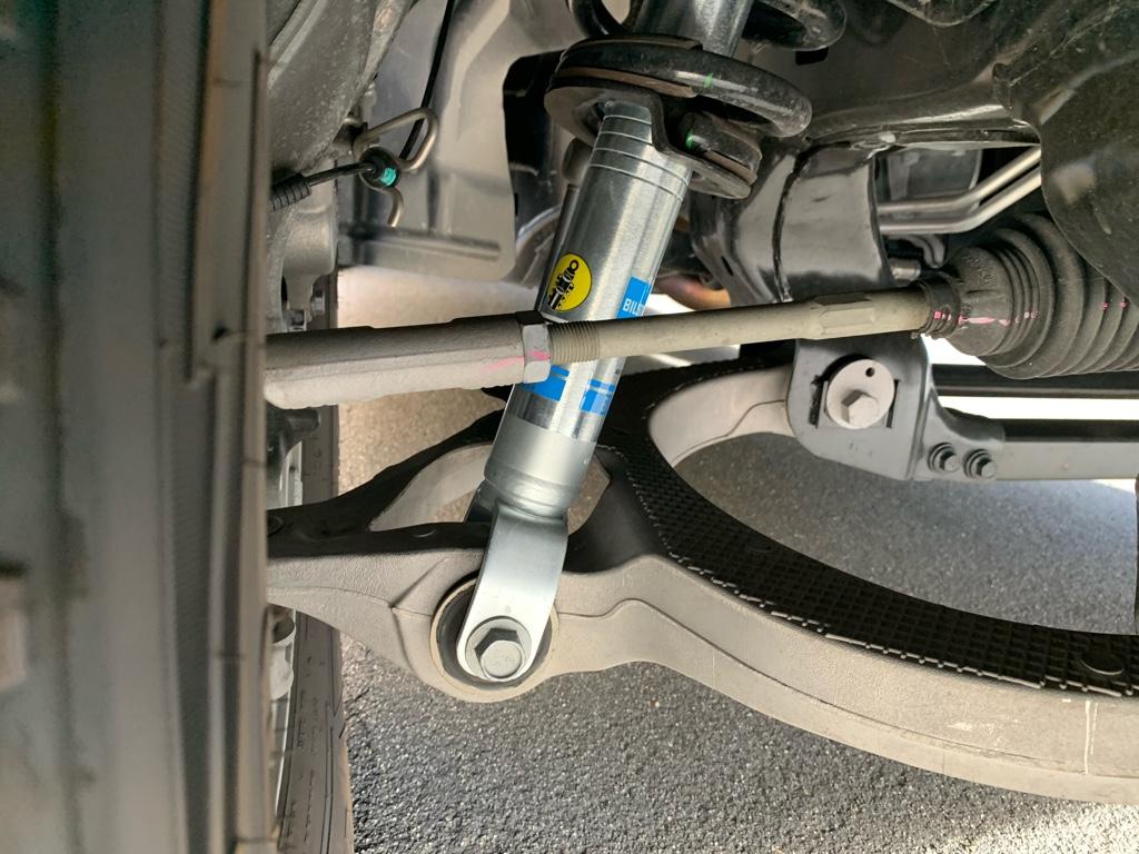

I confirm that the 5100s definitely fit the Rebel. Position #5 has perfectly leveled me, even with 300lbs of sand in the bed.
Just chuck the silver perch adapters from the included install kits. The OEM Rebel parts fit perfectly without those adapters

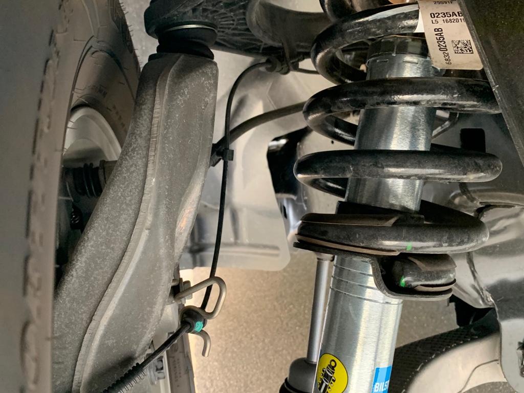

Did your oem coil springs ends, both top & bottoms land in the same place on passenger and drivers side, seems like my tops are 180 deg different, did my 5100's yesterday also used # 5.

I asked the mechanic who did mine, he said no, i guess they cover ORP & NON ORP.

Just installed mine. Took 4 hours. Most of that was me trying to get the OEM strut out of the spring. Super happy with them
