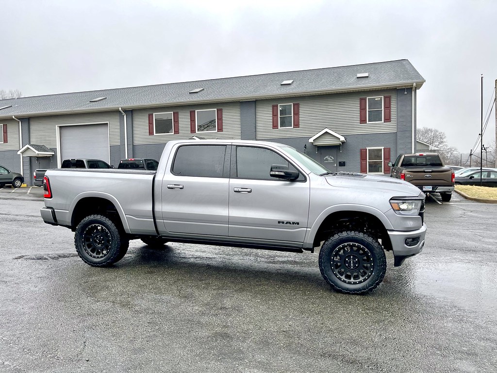

Mine is a 2020 but everything you want to do is what I did. I would go 1” or 1.5” spacers in the front. I did 2” all around and it looks great but I had rubbing issues in the front that required me to trim the inner plastic. Not a big deal but also not ideal.

That was in OR2. With the 2” spacers up front I always go there when parking or anywhere I have to make tight turns
