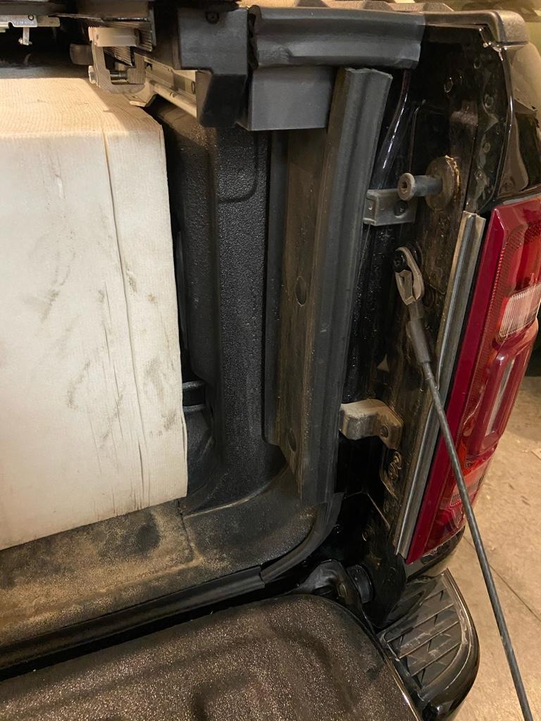

Stopped by a local truck accessory store today to see if they had some kind of topper seal I could use and they gave me over 4' of it. Tried to pay them something but they wouldn't hear of it saying they have **** loads of it. Good guys. There are two more spots I have to figure out how to seal due to a couple of small gaps from the Extang rails, but this stopped any leaks from the sides of the tailgate. Anyway, pic of the type of weatherstrip and install:

That’s a much better seal design than the ESI product! Looks like it should work out perfectly!

At the tailgate end of the rails is where I still have light coming through and have to figure out as well. I need to get some foam weatherstripping like Zeeya has... which looks like it could be window shaker open cell foam weatherstripping. :unsure: Time for a Lowe's run tomorrow.
