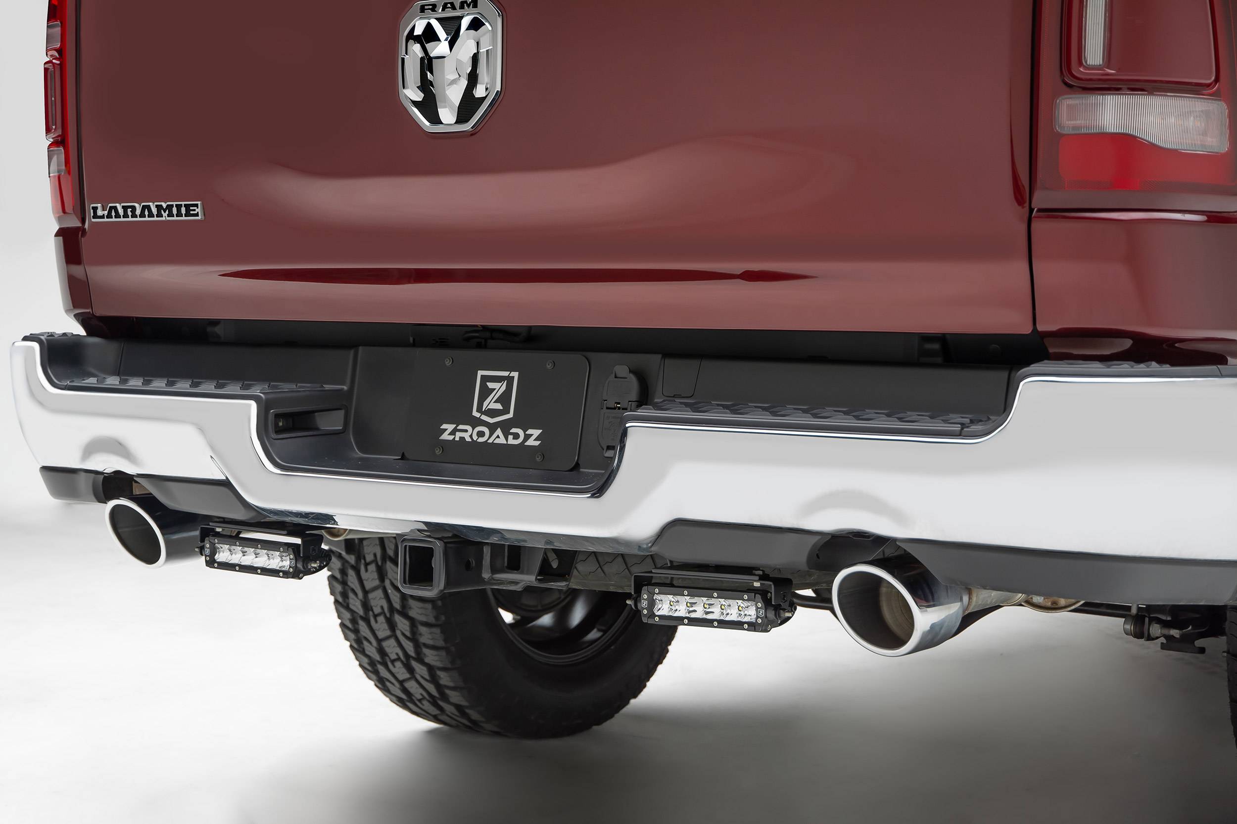

Backup LED Light bar Bracket
Alot of guys are running the VLED license plate reverse light along with a curt harness adapter so there is no need to splice into the factory harness.
This light is not compatible with the multi function tailgate.
Ended up ordering the Brackets, Install was 100% play and play no drilling or splicing factory wires the way I ended up doing it. Part numbers are below for products used and some pictures of the lights on the truck. High quality Product from ZroadZ. Only issue with bracket and using rough country lights is the lights are a little short as shown in the picture, simple fix installing a few washers or a spacer.
ZRoadz Bracket: Z384821
Rough Country Light: 70706BL
Curt Trailer Adapter Harness: 56584
Curt Trailer Harness (not nessasary but cleaner install) : 58550

Has anyone tried out the Zroadz Backup light bracket below? Looking for a way to mount some lights without drilling any holes, so everything is reversible.
