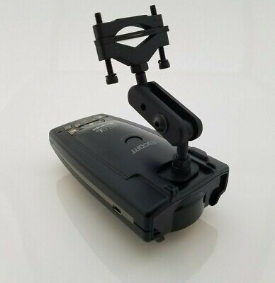

I just received mine. I mounted it up to see how it would look, it's WAY too low for me.
I wish it tucked closer to the mirror.
You do know it is adjustable...correct? You can get it to butt right up to the bottom of the mirror if you want ;)
I tried, I wasn't able to get it right against the mirror.
