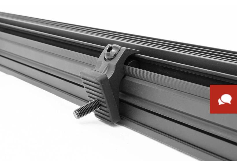

Bought a 40” bar and factory grill mesh today. I’ll need to fab up my own mounts for it, but there appears to be plenty of room behind the grill. The adjustable foot mounts should be a lot easier to work with than attempting to reach the ends of the bar. Looking forward to getting it installed!

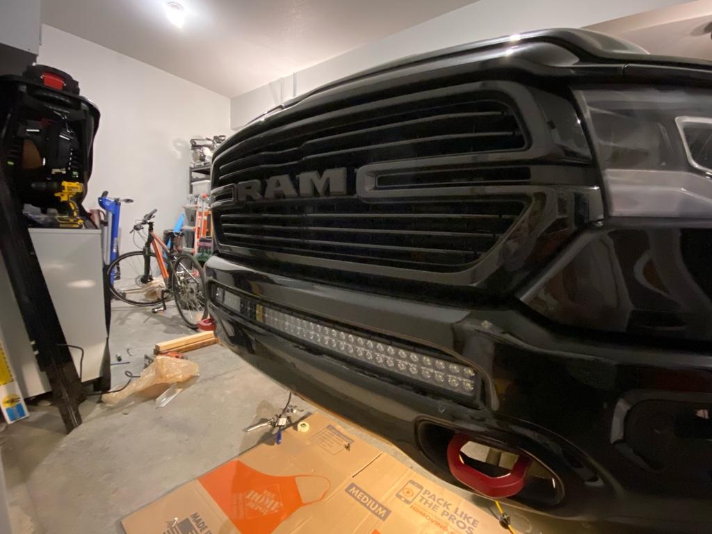

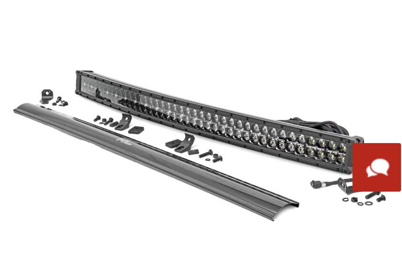

I’m mounting a 40” bar. Just received the light bar yesterday and did some rough fit checks. Hit the Home Depot and got to work on a mount for it. I’m about $20 into hardware, and looks like it will work out. Should have the grill mesh delivered today so hopefully I can wrap this up over the weekend.
I chose a Rough Country 40” bar with bottom mount feet that can move anywhere along the light bar length, which made the bracket design a whole lot more simplistic.

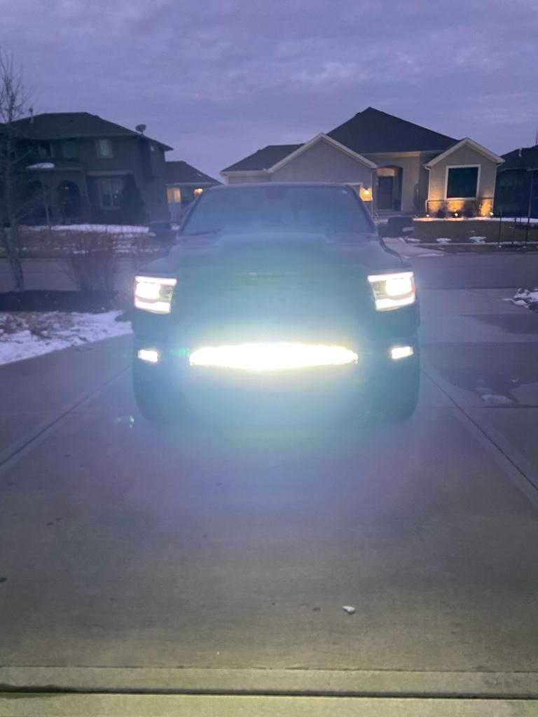

Got it installed, still waiting on the lower grill sensor ports, so I just taped my front sensors out of the way for the time being. Looking forward to getting this out tonight to see what “36k lumens” looks like!

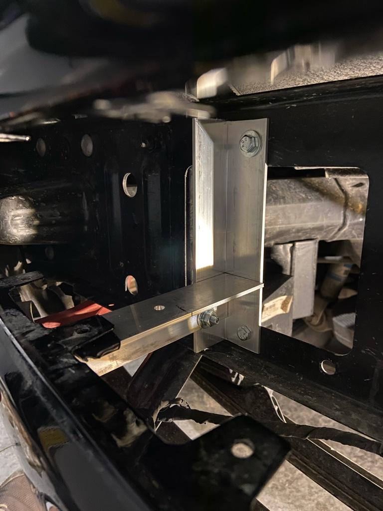

This is exactly what I am looking to do. Would you consider giving me details on the brackets you made? Also, do the sensor's from the old grille not come out to put into the new one?
Sure thing. Scroll up a couple of posts and you’ll see the mounting brackets I made. There are factory holes in the sheet metal part I connected to, so I didn’t make any modification to the vehicle. I just used 1-1/2” angle aluminum since it is stable and easy to come by. Since I don’t have a lot of tools at my disposal, I made everything with bolted connections. A saw and drill is all you’ll need.
The key for me was selecting a light bar with movable bottom feet, so I didn’t have to get so creative trying to reach the end of the light bar with mounts... that would have been a much bigger challenge. I selected a curved 40” Rough Country bar, partially for this reason.

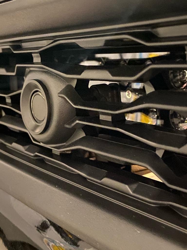

Yep, super easy. The grill has two little sensor holders to hold the sensors. Those are just thin plastic parts which plug into the grill. So I installed the light bar back far enough to allow clearance for the sensor and wiring. It’s only a couple of wires that go into each sensor, so not a big deal, they tee out of a main harness from the factory.
Mine are just taped out of the way right now. My new sensor holders will be here on Wednesday and I’ll grab a pic after the install.

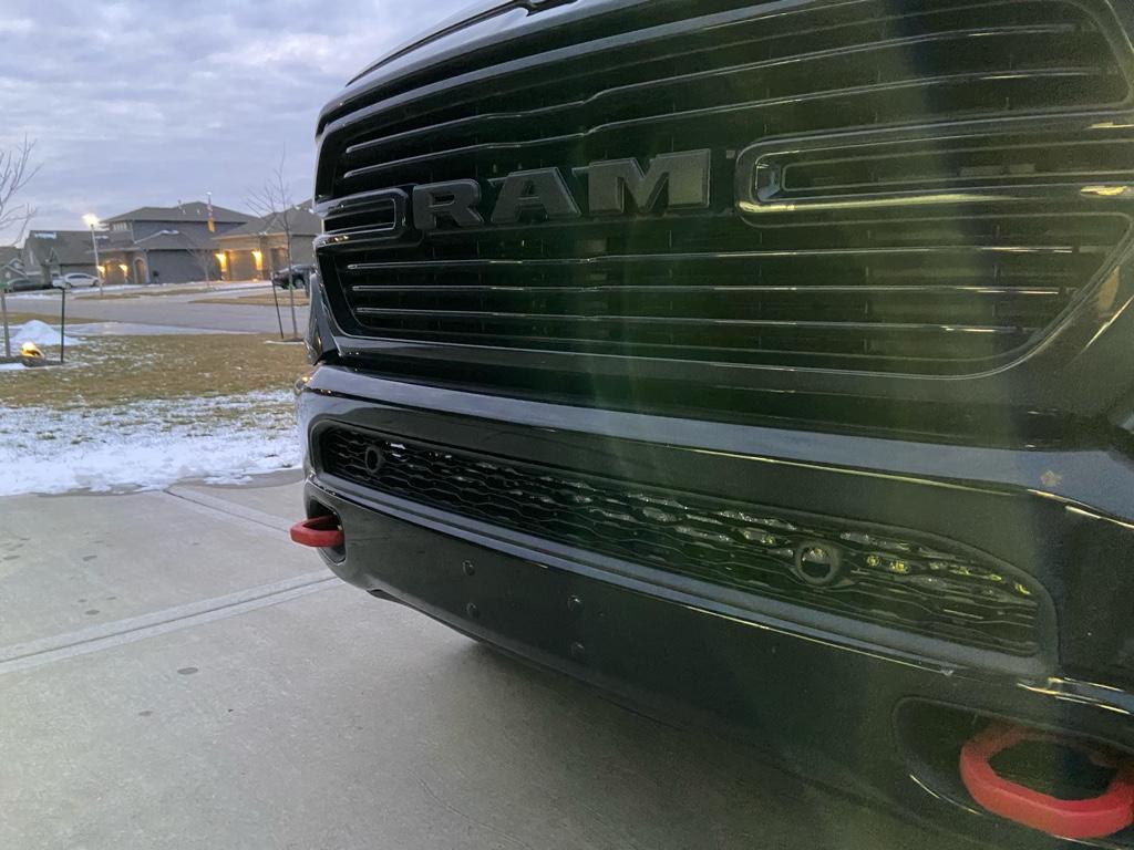

Also, I received my parking sensor holders yesterday and installed to the diesel grill. Here’s a pic to show the sensors installed with the 40” light bar behind it.
Update in case anyone else is looking for this information in the future: the HI beam wire on the drivers side is white with green stripe on the factory LED headlight harness. It was a PITA to get to, but I tapped into mine.
I still need to decide how I’d like to operate my light bar DRL functionality, whether I tie into the factory DRL or low beam. I currently have no idea which wires carry those signals. If anyone knows or has a wiring diagram, I’d greatly appreciate it.
How did you take that lower grill off? I have a rebel with the sensors already. Reading your posts, is it possible, all I need is the light bar and the bar mounting brackets? Or will I need a new grill as well?

Sorry Joe, I’m not familiar with the Rebel lower grill. If yours is an open mesh, there shouldn’t be any need to replace it. My lower grill on the Laramie was 100% blocking, so I could not leave it in place and see any light output... had to change to the diesel grill mesh which lets air in to their cooler.
If you get under your bumper you’ll see the removal is very straight forward. Plastic clips on the bottom and some screw nuts that hold the top in place. Grill pulls out from the front once those are all removed.
