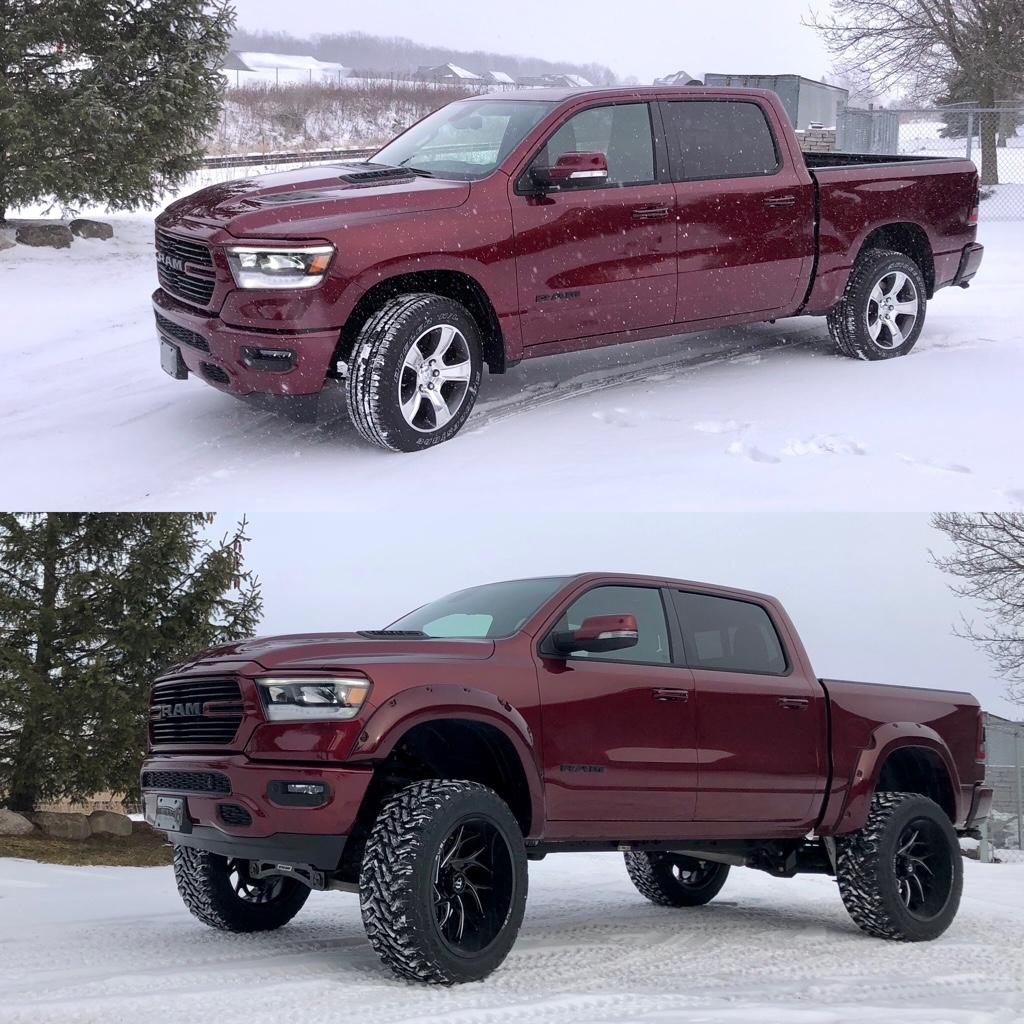

I have a 2020 sport with 37x13.5s on it. Truck has plenty of torque to move these beasts! And I have 3.21 gears! Everyone says “how are those 37s with your gearing” I say “just great!”
I don’t off-road. I don’t tow much. And I don’t care about fuel mileage! I love my truck and wouldn’t change a damn thing! Also, you’ll need a 2” body lift on that 6” sus. Lift to clear these. I have a 2” daystar on a 6” pro comp lift. I don’t rub at all, maybe on a turn into a steep driveway but she rides
That is one sweet looking truck Chris. I've been looking for a body lift. I'll check out day star see if they have for 21 rebel. What offset are your rims? Mine are -1 think they will rub with 37x12.5s with out the body lift? Zone shows 37s will work with 0 offset. I appreciate you chiming in! So being I have the 3.92 I should be good as like you no off roading but I do pull a trailer every now and then for my bikes if I do Ling distance and worried about it I'll throw the 35s back on at that time..lol any again I love that truck. BTW the flares are they stock ram flares? Or aftermarket? Thanks again!!

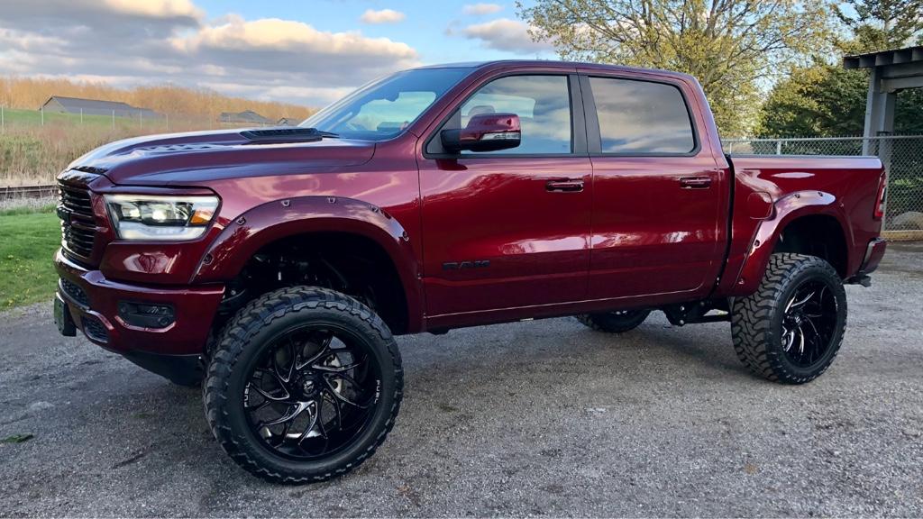

Thanks so much! Mine have a -44 offset. I think you might be ok with a 37x12.5 with that offset. Still mild trimming of the front valence and pinning back the well liners.
Customoffsets.com is a great place to find the answers for this exact stuff, plug in some filters and look through the gallery and it will tell you if trimming needs to be done or if it rubs based on what you want. You’ll probly see my rigid there lol. Flares aren’t stock, they are bushwhacker pocket flares, colour matched and black out bolts. Thanks again!here another wheel picture

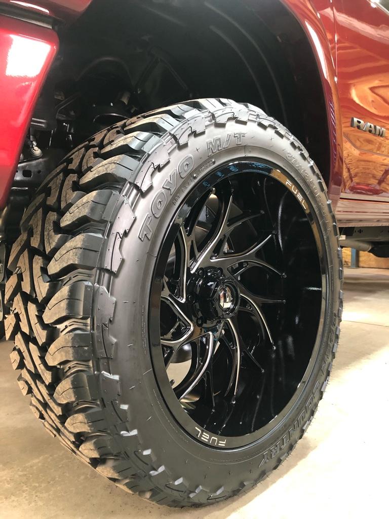

If I hit a sharp incline, only while turning I sometimes will get a tiny rub on the inner side, closer to door. It barely catches the inside edge of my fender flare. It’s only happened twice. There’s a metal tab you bend back to hold the well liner, and you zip tie back a couple spots the liners would catch. A little trim on the front valence. But no major cutting or grinding. Just a small spot on the body pinch weld. No painted surfaces touched and bumpers not adjusted.
Check out customoffsets.com for lots of good info! Cheers

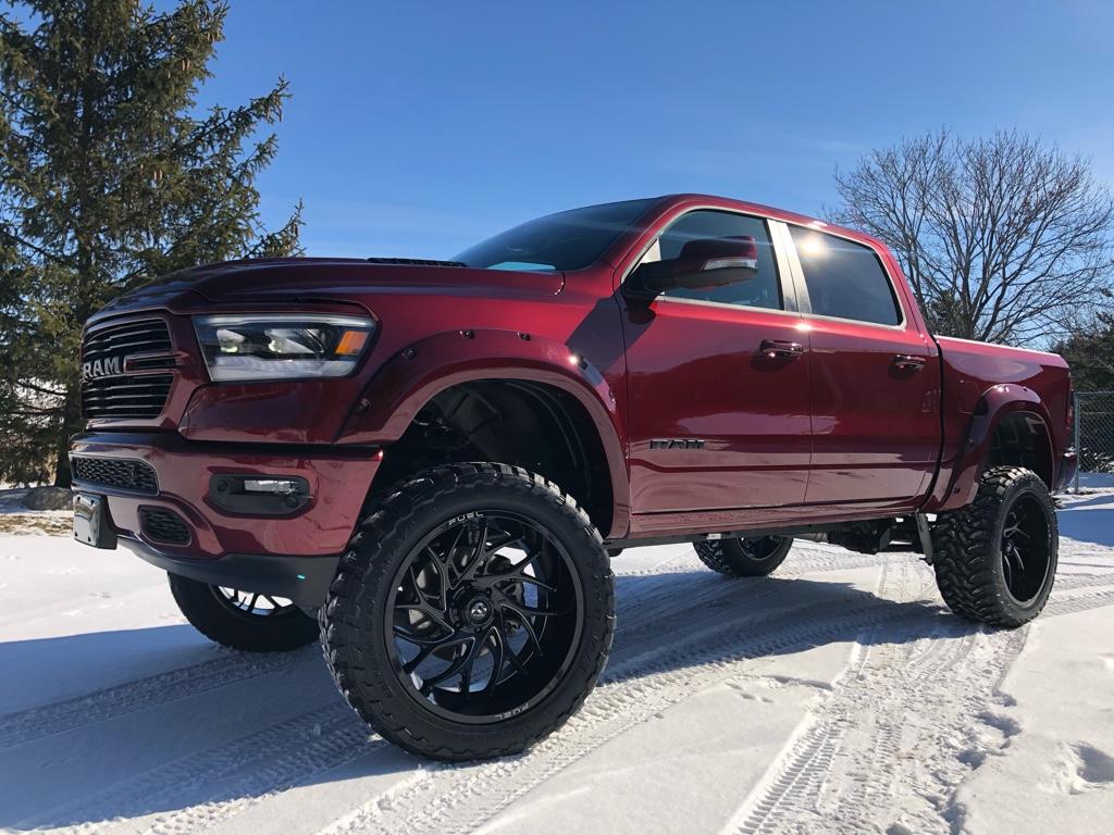

Very sharp! Think I may go with that flare beats the stock rebel flares just so plain. Appreciate the replies. I'll be checking custom wheel offset again I have browsed them before. Again great looking truck!

Sweet truck! Great write up it helps alot! What offset do you have on your rims? I'm thinking on getting another set to put my 35s on for winter and possibly putting the 37s on my fuel blitz -1 unless I can get a rim with enough offset to put the 37s on without to much rubbing besides minor trimming. Thanks again for the reply. Again very nice rig!
Thanks man! My rims are -24. With -1 offset I don’t think you’ll rub much at all! If you got a lightweight 37 I bet you’d hardly notice a difference going from 35 to 37 too. I still have tons of power and my gearing feels perfectly normal.
