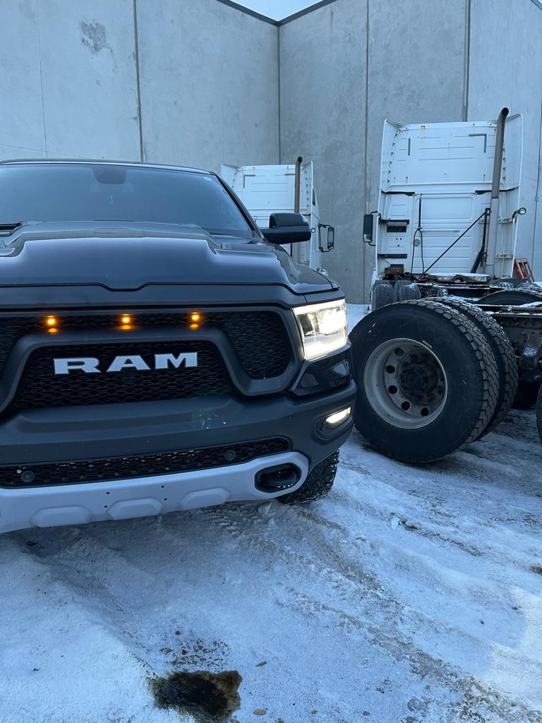

Amber lights in grille
Here are the ones I used, I did dremel off side tabs and inserted through front of grill. Held in with double sided tape wrapped around barrel of light. I used the smoked lense but amber lense is also available on Amazon.
BASIKER Auto Front Grille Lights for 2004-2019 Ford F150 Raptor F250 External White LED Lights Decoration | 3 Pack Black Lens https://www.amazon.com/dp/B07VCQ9PD1/ref=cm_sw_r_em_apa_i_GeqGEbF0WVCJZ
I actually used your grill as inspiration when I was doing mine!
I used these amber lights. Did my own and did a buddy’s F350. Only downside is the pack comes with SO MANY LIGHTS.
The 3/4inch rubber grommet fit perfectly in the opening of the grill, my lights haven’t moved at all.

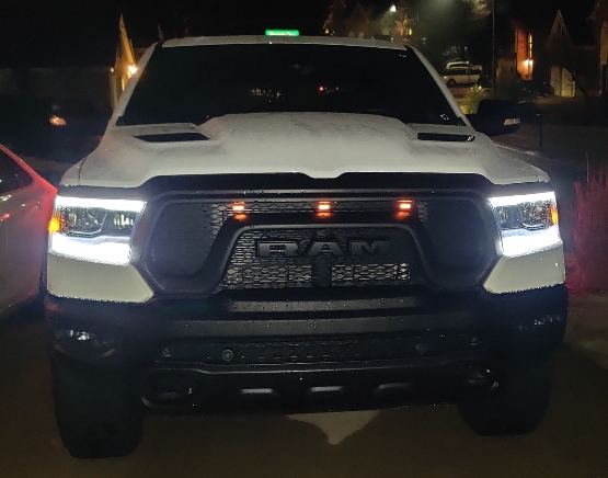

The 3/4" LEDs from Amazon push right in and don't move. Like the ones @2019GRamRebel used. The 3 across the top are pre-installed in the Raptor/Rebel aftermarket grill i got ebay for $200. I added a couple "pop ins"... Gotta be different, ya know?
